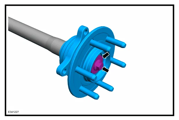

My question is, can I loosen the current bolts, and torque to the proper limit? I’ve read anywhere from 80 - 100 ft lbs. I’ve also read you can’t reuse the same bolt, so should I order some new ones, remove the originals, then use these, torqued to the proper limit?
Just FYI and FWIW, here's the pertinent bolt installation text clipped from the Ford Workshop Manual as of 08/12/2022:
Ford F-150 Max Tow Axle Bolt - Preventive measure? axle bolt wsm
NOTE: Make sure a new bolt is installed.​
Install the washer and tighten the bolt.​
Torque :​
Stage 1: 52 lb.ft (70 Nm)​
Stage 2: 90°​

Just so I know, are the current original bolts over torqued, which contribute to them breaking?
No One Knows . Speculation and opinion are rampant but AFAIK there is no method to determine the installation torque of a torque-to-yield fastener after it has been installed.
Just for consideration ... while it's possible that the bolts were over-torqued and that contributed to failure, IMO it's also possible that they were torqued properly but then movement of the axle shaft relative to the splined wheel hub assembly contributed to the failure. That 'movement' may be of a type that is relatively independent of the fastener torque or 'strength' (e.g. 'wiggle' within a 'sloppy' splined interface). That's only one of many theories which have been advanced and may be within the realm of possibility.
I’m just curious to see if this replacement process with proper torque values will “prolong” their life compared to current.
FWIW there has been at least one report of a dealer-replaced bolt (without axle replacement) failing. Who knows if that replacement was was installed to the proper torque spec?
Note that the Workshop Manual procedure for calls for installing the hub to the axle shaft with a hydraulic press to 'seat it' against a washer retained on a lip of the axle shaft on the inboard side of the hub. IF, for whatever reason, the hub is no longer fully 'seated' on the axle shaft (i.e. the axle shaft has 'slid inboard' relative to the hub), then replacement and proper torque-ing of the bolt may not remedy that.
Ford F-150 Max Tow Axle Bolt - Preventive measure? wheel hu
I suppose an argument can be made that IF your bolt is 'on its way' to failing then a replacement would defer the occurrence.
I guess ya gotta go with whatever makes ya feel good. ;)

Good to know. I have some new bolts ordered. Just so I know, are the current original bolts over torqued, which contribute to them breaking?
I replaced mine a couple weekends back out of precaution. Took no time at all to do it. One thing I wanted to know was what the final torque was on these. I set the wrench to 52 and then incrementally increased 10 ft.lbs at a time while continuing to the 90 degree turn. Final torque ended up at 120. Not sure what long term impact doing this will be but at least I know they are now at the recommended torque.
Probably not a bad idea to have a spare set lying around so if one snaps I can drill it and pull it out to replace it.
