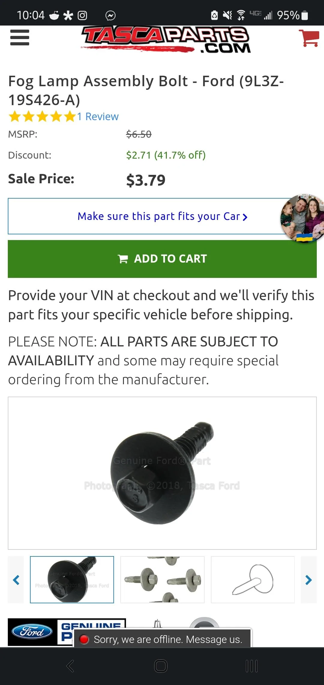

I did a few quick searches, and now I have even more questions
This bolt comes back as several different parts, and it looks the same as the galvanized bolts that hold bumper brackets or Headlights in LOTS of cars/vans/trucks
Ford F-150 Max Tow Axle Bolt - Preventive measure? Screenshot_20221029-100406_Chrom
Am I wrong?
Am I wrong?
You are wrong.
Where would I find the bolts?
Here's a post-direct link showing the complete part number: https://www.f150forum.com/f129/2021...-axle-bolt-sheared-515460/index2/#post7130913
On a different forum but IMO ^that's^ the most comprehensive single thread on the topic.
Here's the Tasca page returned when site-searched by that PN: Bolt And Washer Assembly Hex.Head ML3Z19S426A | TascaParts.com
Tasca seems to do a good job of redirecting when a PN has been superseded, note that as of this date none is mentioned.
