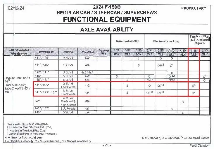

All versions of the 2024 Order Guide (below excerpt is from the latest / current revision as of this date) show the "Max Tow Axle Upgrade", 3.55:1 ratio, Axle Option Code XL5, available with the 3.5 EB, both 4x2 and 4x4.
Ford F-150 Payload vs Max Tow 2024 MAX TOW AXLE WITH 3.5 EB

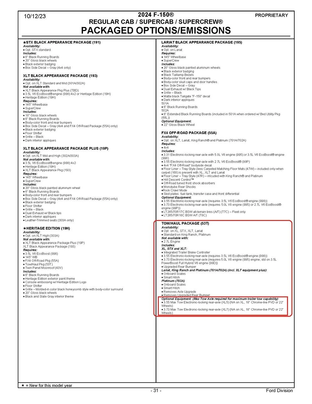

This description of the optional Max Tow Axles with 53T is from the earlier Order Guide which is more legible, the text is the same as the later in this regard:
Ford F-150 Payload vs Max Tow TOW HAUL PACKAGE 53t DETAIL
You may need to download and zoom these images to read the text; sorry, it's the best copies I have.

You can't build a 3.5 with max tow, but you can with a 5.0.
If referring to the retail website 'build and price' it's not uncommon for that to have glitches; more often than not the Order Guide is correct.
Ask your dealer to see if they can 'build' a 3.5EB (other than XL) with Tow Haul Package 53T + Optional Axle Code XL5 in their order system which is real-time connected to the Ford Corporate ordering database.

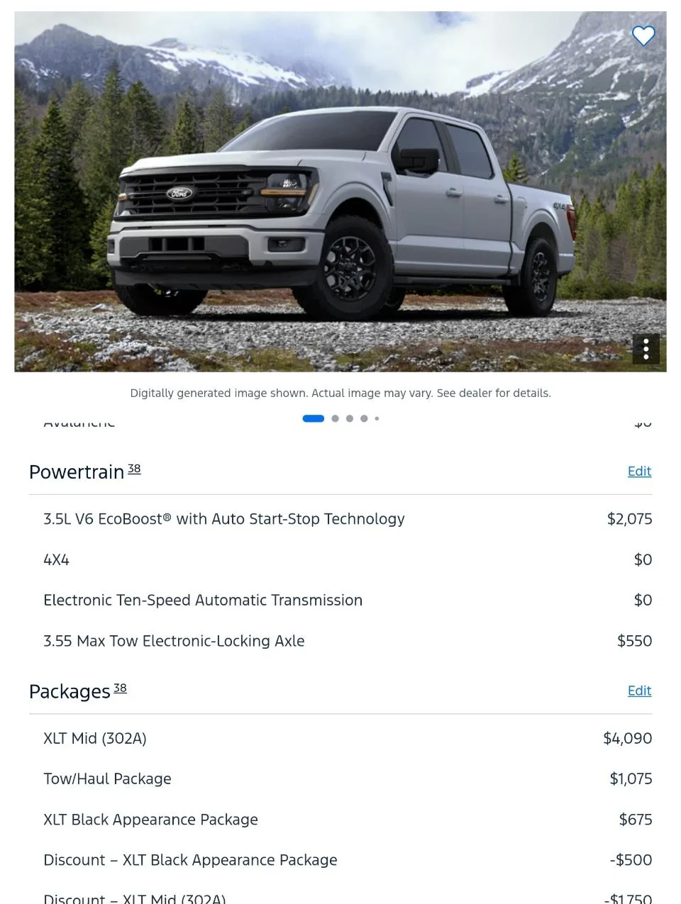

Their website doesn't help. I just tried building an XLT with 3.5 max tow. It's not possible. I can build a 3:55 electronic rear end with tow/haul option. I am curious thought. Again it would make no sense to not offer it.
You keep referring to retail websites.
I keep referring to a dealer's vehicle order system.
They are not the same and they are not linked, the latter is the source of the 'final word'.

Looks like the Canadian retail site offers max tow for 3.5, but not American. I'll ask my salesman. Thanks for the info.
