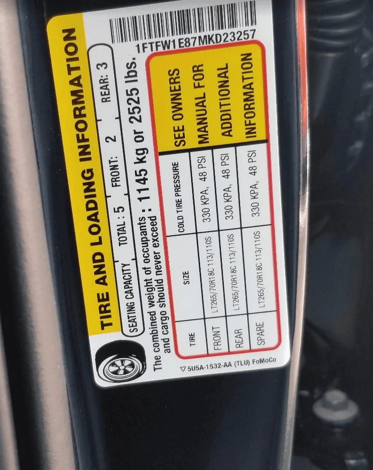

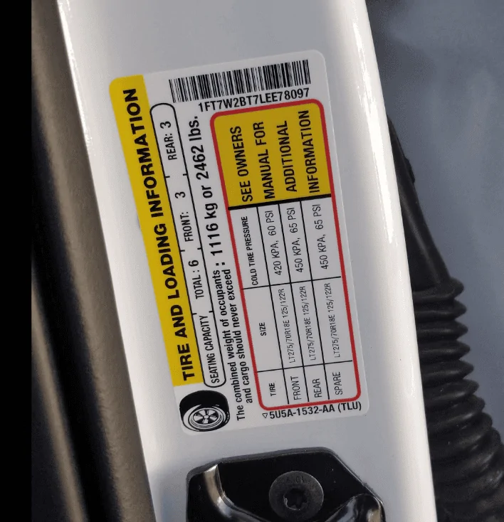

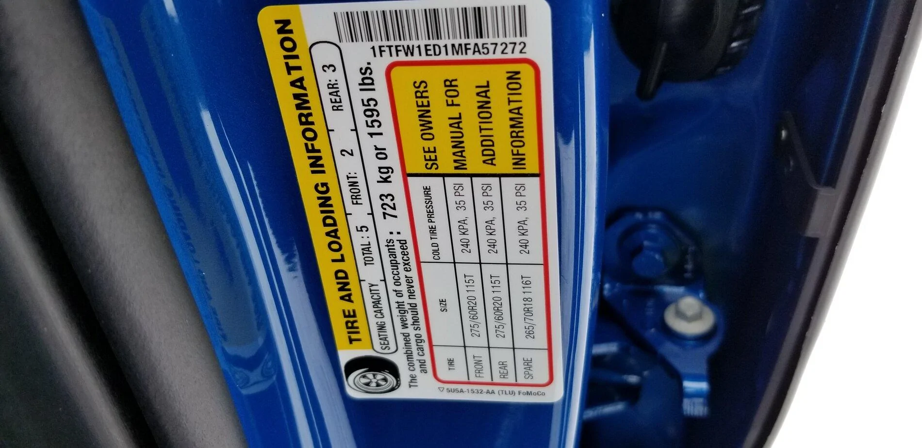

Max Payload Sticker F150 vs F250 gas V8
My new F150 xlt vsF250 Gas V8
Ford F-150 Payload vs Max Tow 1611957314400-png
Ford F-150 Payload vs Max Tow 1611957335854-png
Ford F-150 Payload vs Max Tow 1611957210045-
F250 -V8
Ford F-150 Payload vs Max Tow 1611957406824-png
Ford F-150 Payload vs Max Tow 1611961309092

Awesome HDPP, congrats! I'm jealous, the hybrid is non-negotiable at my house.
Thanks, Hybrid looks nice, didn't want the first year of the hybrid, needed more payload for my trailer, didn't want the big F250 with the death wobble issues.

What trim is that F250 gas. Seems low. Others I've seen are 28-2900.

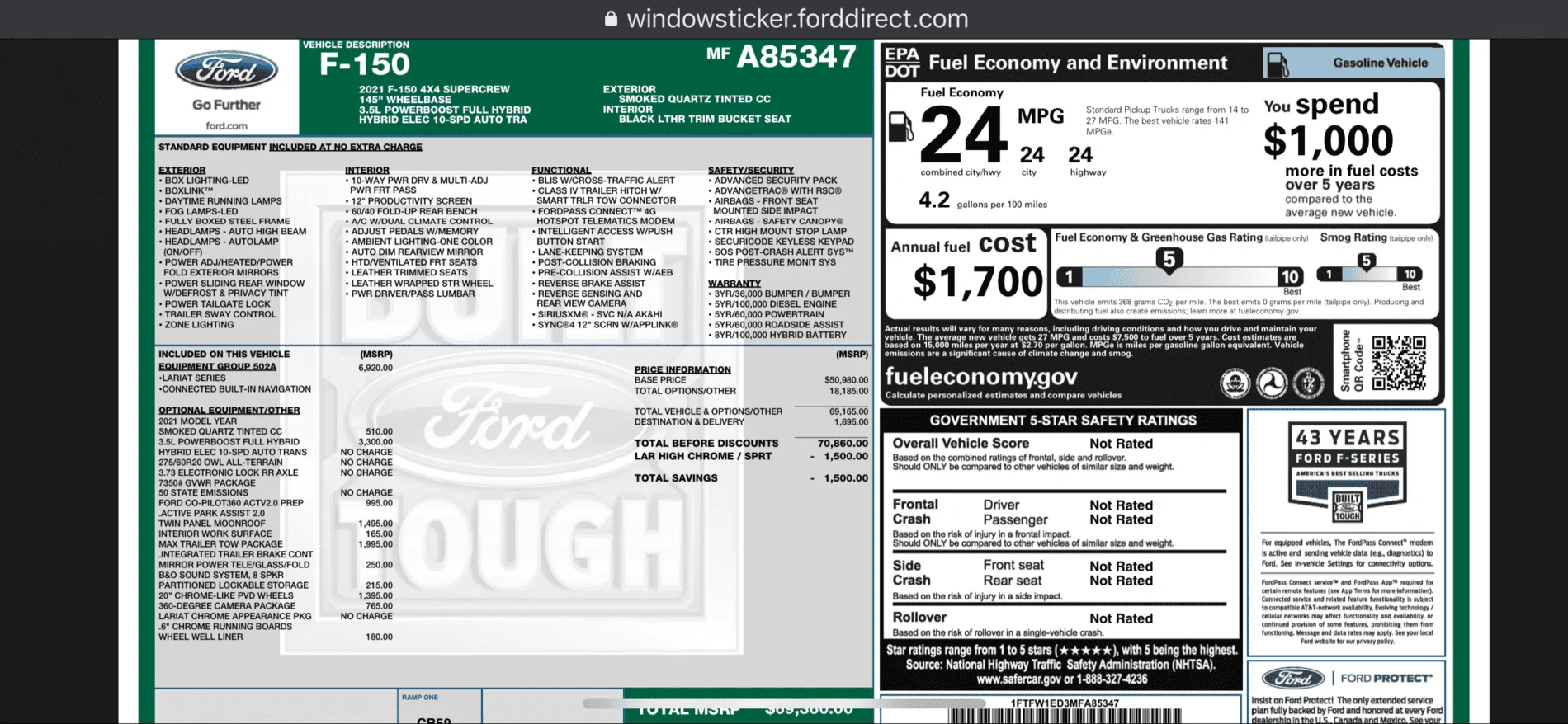

I suppose I will close the loop on my own truck. Max tow lariat Powerboost with sunroof, without power tailgate and without power running boards.
1485 Payload, 12,400 Towing
Ford F-150 Payload vs Max Tow 3382BA9C-6DE1-4F59-865D-71623D7FEC10
Ford F-150 Payload vs Max Tow E27FA399-47D5-46F9-9018-3BF019B9CC02
Ford F-150 Payload vs Max Tow 0C46D6B0-6FCD-401B-9CFC-13A642E69126

1485 for a well loaded out PB Max Tow is very encouraging. I'll be jumping for joy if I'm around 1450 for my KR. I swap the power tailgate for your sunroof, and kept the standard 18" wheels, but do have the max recline seats. I guess I'll know in 3-4 weeks. If I'm in the 1450 range I may be able to hit the 12,400 with an enclosed racecar trailer, since I'm always alone going to race track. But aftermarket stuff like the spray-in bed liner and a bed cover will eat into that a bit, but I'm looking at the Lomax cover which is easy to remove and store. Thanks for posting your stickers.

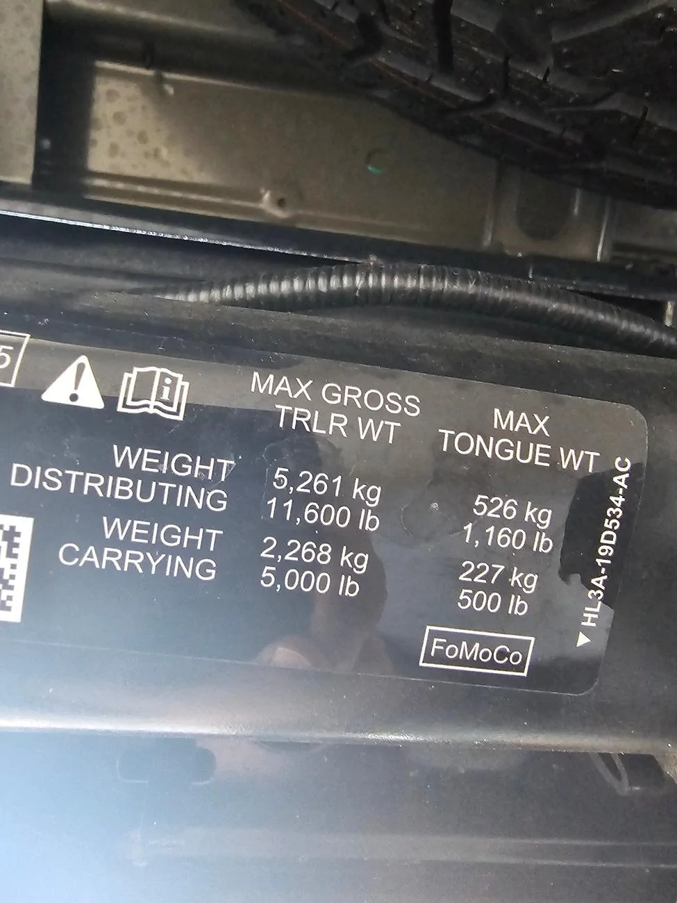

1) All PB’s have 30.6 gallon tanks.
2) My non-Max Tow hitch label:
Ford F-150 Payload vs Max Tow IMG_1609

So 1,160lbs is the max tongue weight for my hitch if I read it correctly.
