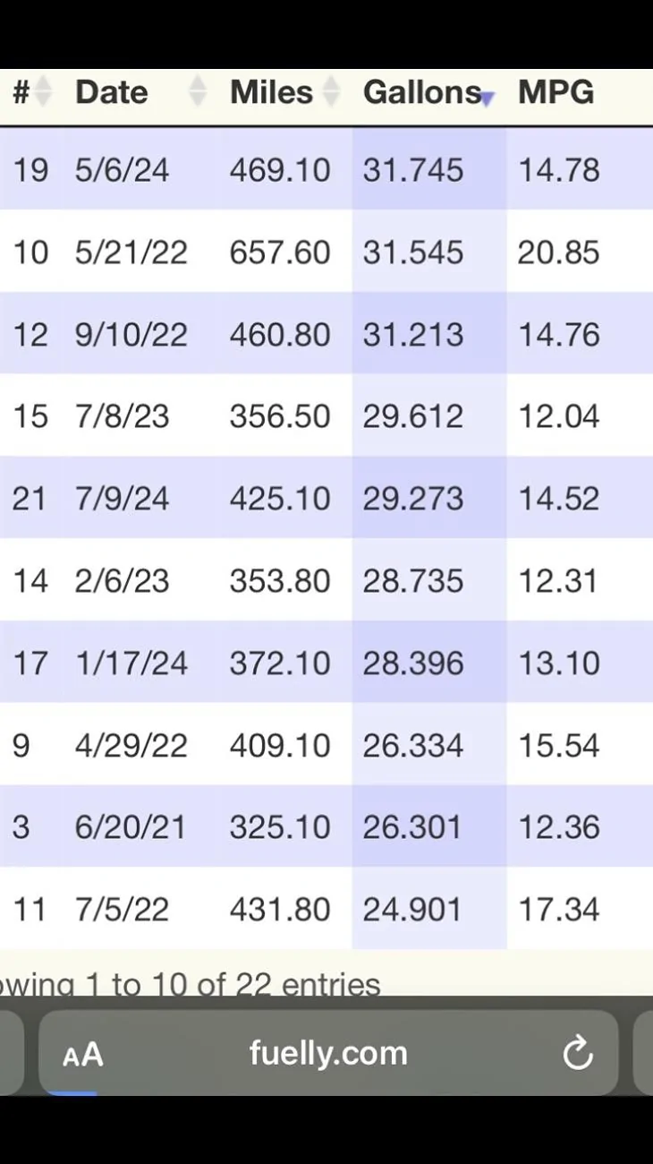

36 gallon tank is overrated. They designed it shitilly and to make up for it starving for fuel after being parked at a slope; the reserve is over 5 gallons.
I don’t drive my truck often, so I like to cycle out as much fuel as I can, especially in the summer when it can go bad pretty quickly here and actually gum up the fuel pump. Despite several times taking it past zero on the DTE display; I have yet to get more than 31 gallons of fuel into the tank.
My Lincoln is spot on with the DTE and the light comes on around 50 miles to empty, which is an okay warning for most places. When it reaches 0 I need to shake the wheel to get the last bit of fuel to slosh around because a couple times the engine has started running rough in site of the gas station. I really need to drop the tank this winter and fix the leaking vent on top of the tank because for the past seven years; I haven’t been able to put more than a quarter tank in it without it spitting gas out the top.
For my truck I always top it off and usually after just half a tank other than when I want to put as much fresh fuel in as possible, or when I toy with the idea of getting e85 or if the fuel prices are peaking and I try and stretch the tank out another week or so.
Here’s some full tank fill ups from my 5.0 with the 36G tank:
Ford F-150 Is a 36 gallon tank available on a 5.5 bed with the Powerboost? 1724713113338_1

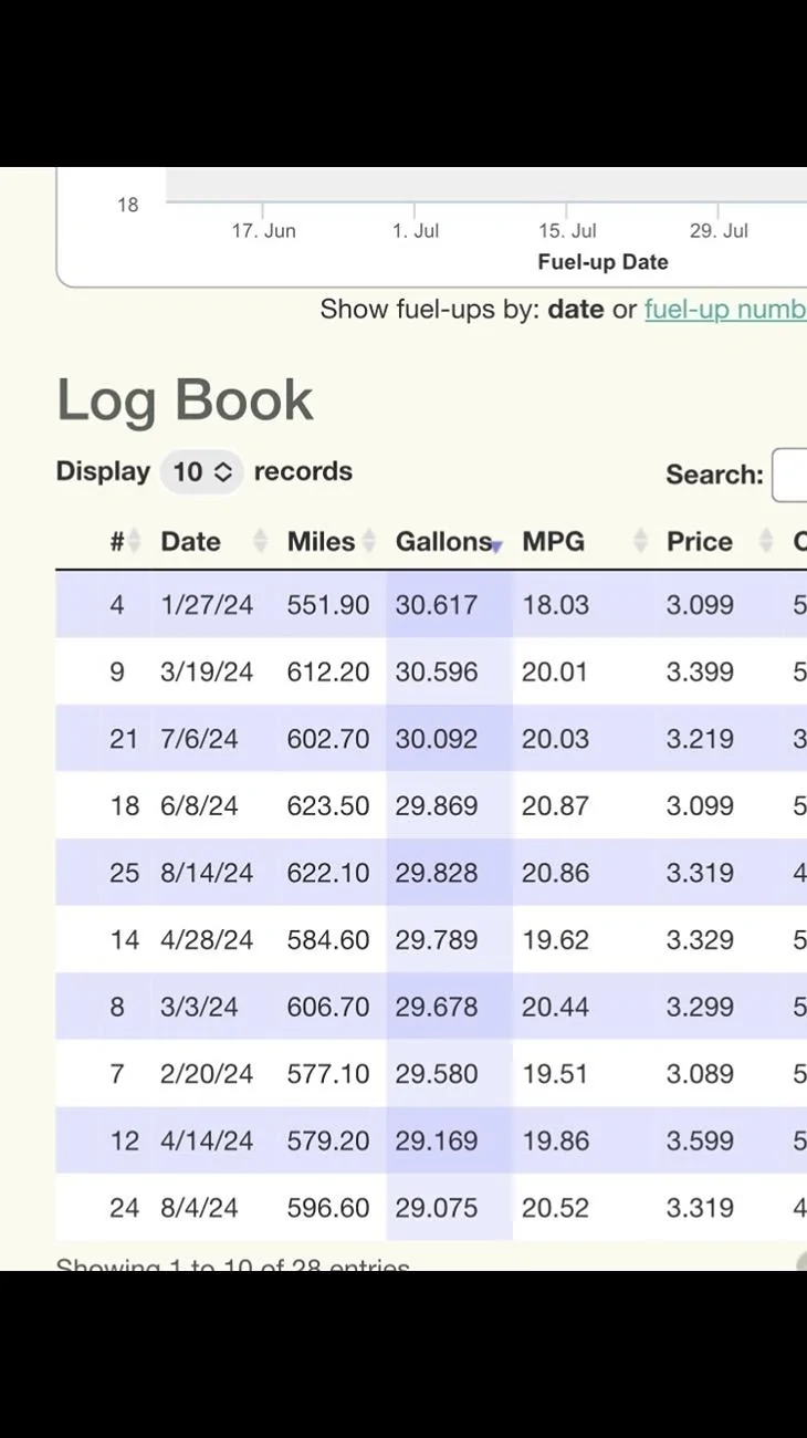

Here are some full tank fill ups from a Powerboost truck:
Ford F-150 Is a 36 gallon tank available on a 5.5 bed with the Powerboost? 1724713647664_1
Long story short, don’t worry about not having the 36 gallon tank and just never think about it again. It doesn’t have much more usable fuel than the tank in your truck now. Maybe one or two gallons.

33 gallons every time on my 36 gallon tank since March. Last year was more the 31 gallons like you are seeing. I wonder if an update tweaked the math. ?
