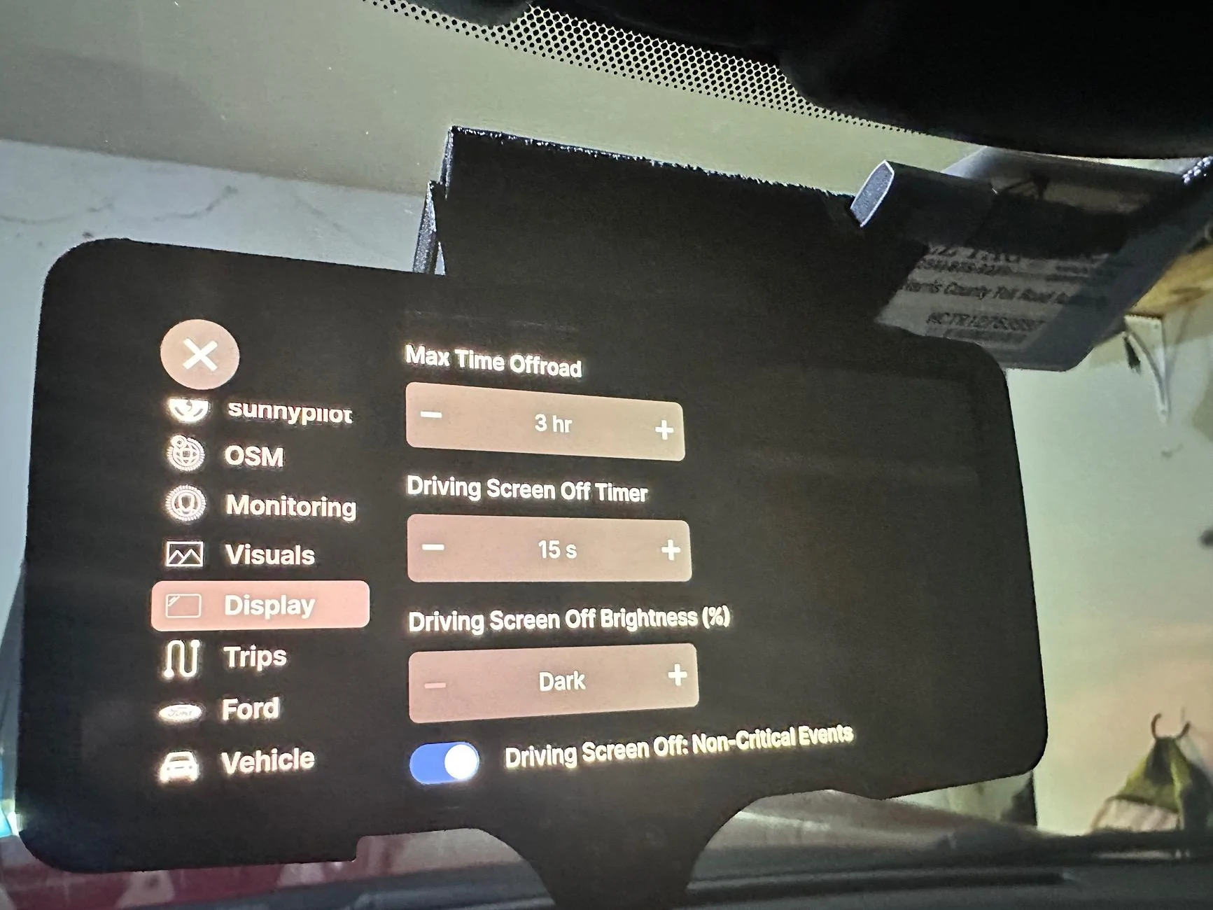

anyone got a pic of what this looks like mostly hidden from drivers pov? Can the screen be turned off?
I think the screen can be turned off with sunnypilot or bluepilot, not stock OP. I will try to remember to check tomorrow.
I'm not sure anyone has hidden it yet, once you get used to the system it actually provides a lot of good data.
