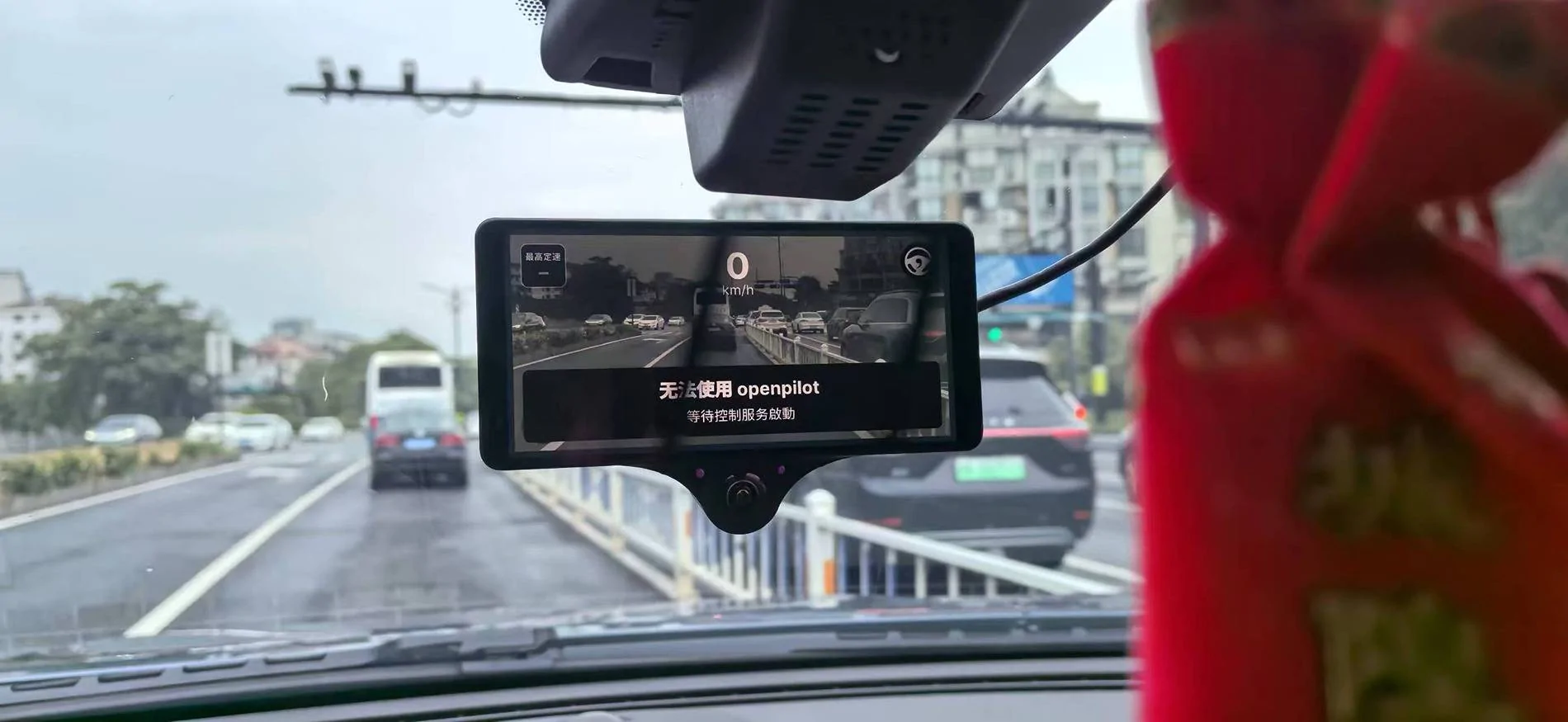

We need changed From Line 65-72 Like as follow:
if pscm_config: if len(pscm_config.fwVersion) != 24:
ret.dashcamOnly = False
else:
config_tja = pscm_config.fwVersion[7] # Traffic Jam Assist
config_lca = pscm_config.fwVersion[8] # Lane Centering Assist
if config_tja != 0xFF or config_lca != 0xFF:
Just changed true to False
