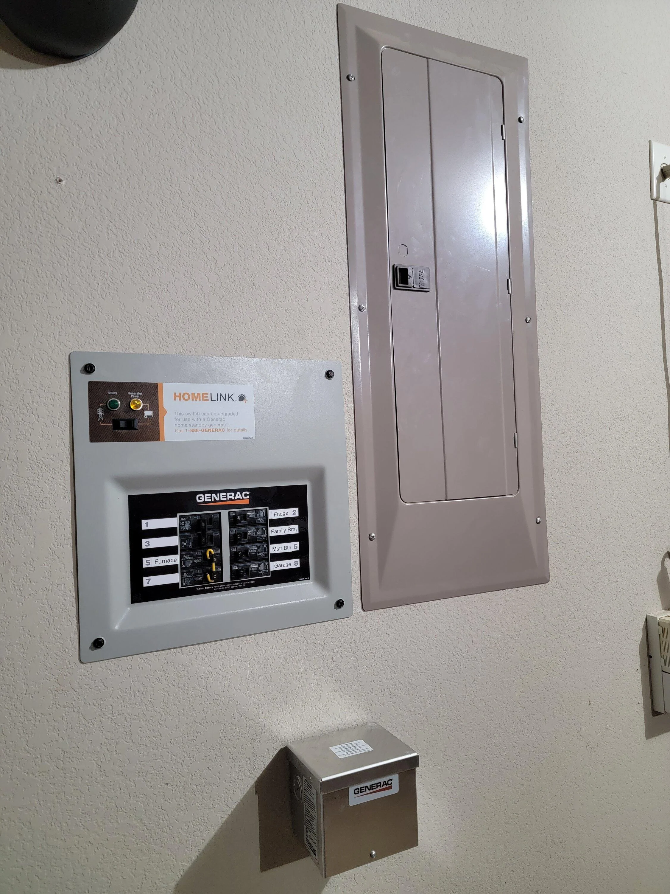

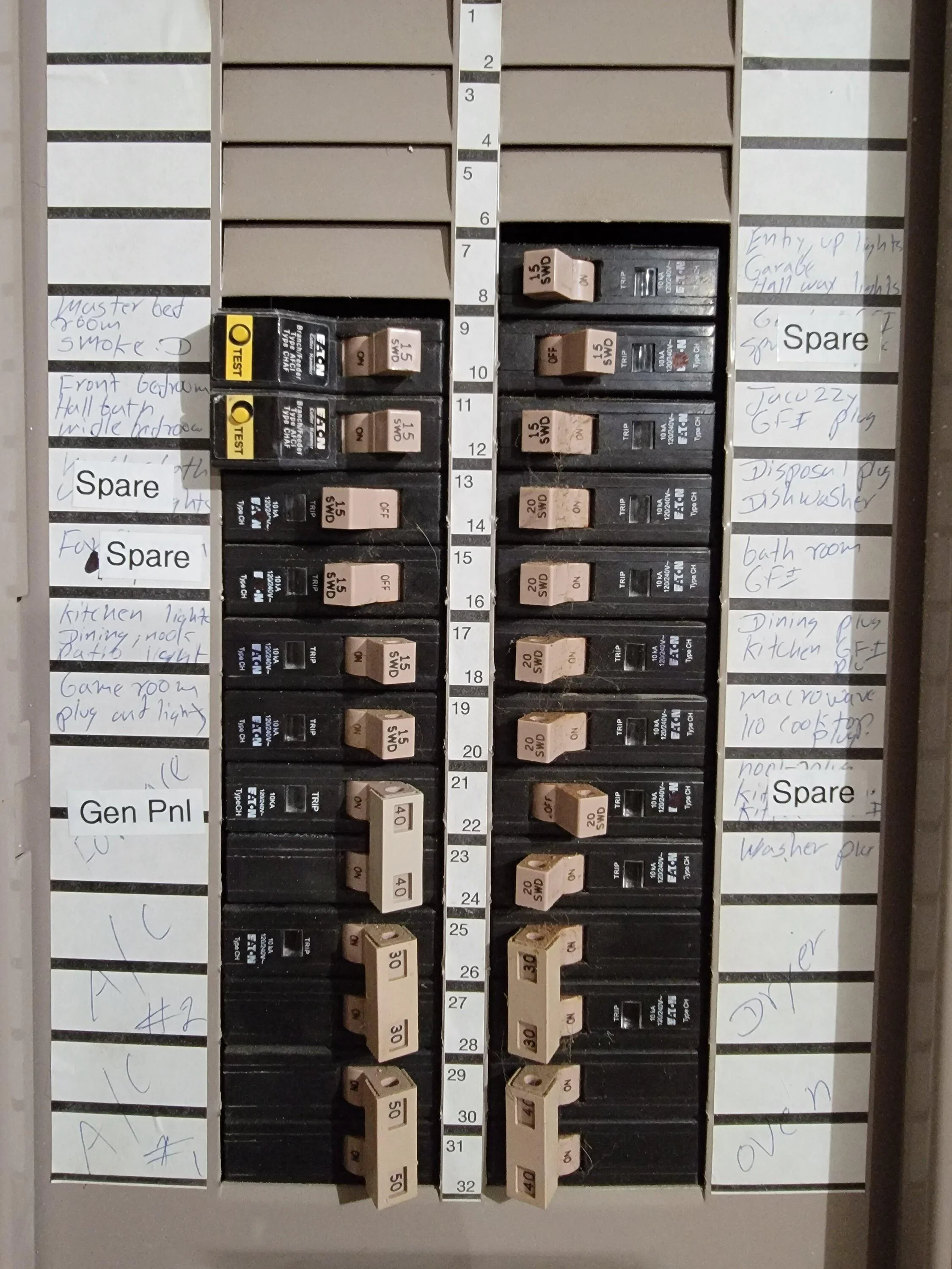

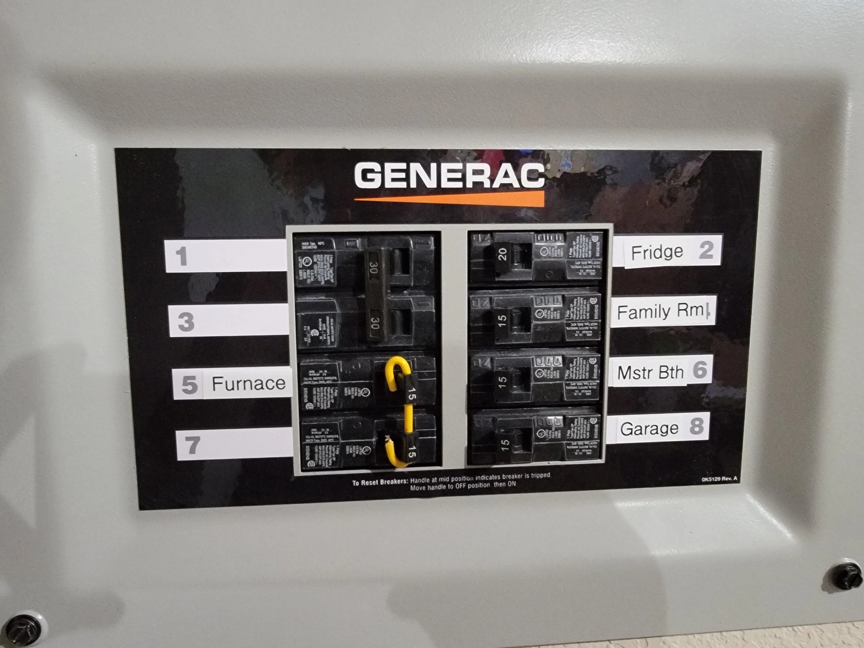

got this installed today. is it possible to swap the two 30s out? im not using the dual 30s, although looking at it now we probably could have done upstairs ac?
i dunno. whatd you guys pick? this'll give us living room, fridge, one bathroom, internet, and furnace. i dont even know if internet works in a power outage. lol. open to feedback.
yeah, i have that box in the lower right corner that is my fiber service off the street. that little box that is powered by the plug above it. also controls some garage lights/door openers/sprinkler. so that is one 15. then in my master bathroom is the master closet that has the junction box where the router actually lives, so that's another 15 taken up. but should allow internet if it still works. actually...i probably should have realized this sooner, but im pretty sure we get notifications for internet out when power goes out too, hah. we'll see. i thought this was just a core set of functions should the power be down for days. (just moved to NTX). i'll keep looking into swapping those two 30s. im dense when it comes to this stuff....don't know if you could just add in 2 individual 15s, or 20s, instead.
yes, you can swap out the 30s. See:
https://www.f150gen14.com/forum/threads/installed-transfer-switch-in-house.1267/page-20#post-181830
yes you can change out those two pole breakers. Make sure you use Siemens breakers though! And while you are at it I’d change that 15 amp breaker with the wire connecting the breaker handles together with a proper Siemens 15 amp two pole breakers. You want both breakers to trip if there is a fault on one part of the circuit.

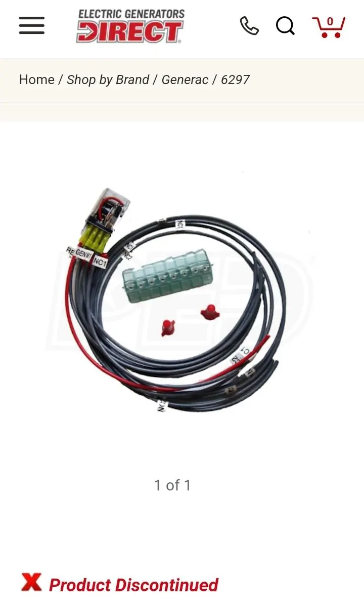

Get it while you can because
Is this the switched neutral kit?
Bummed that no one has been able to decipher how to 'unbound' the Powerboost Generator.
IMO, the Generac 6852/ 6854 transfer switch will be a temporary solution because Ford will make an update either to existing trucks, or future trucks.
