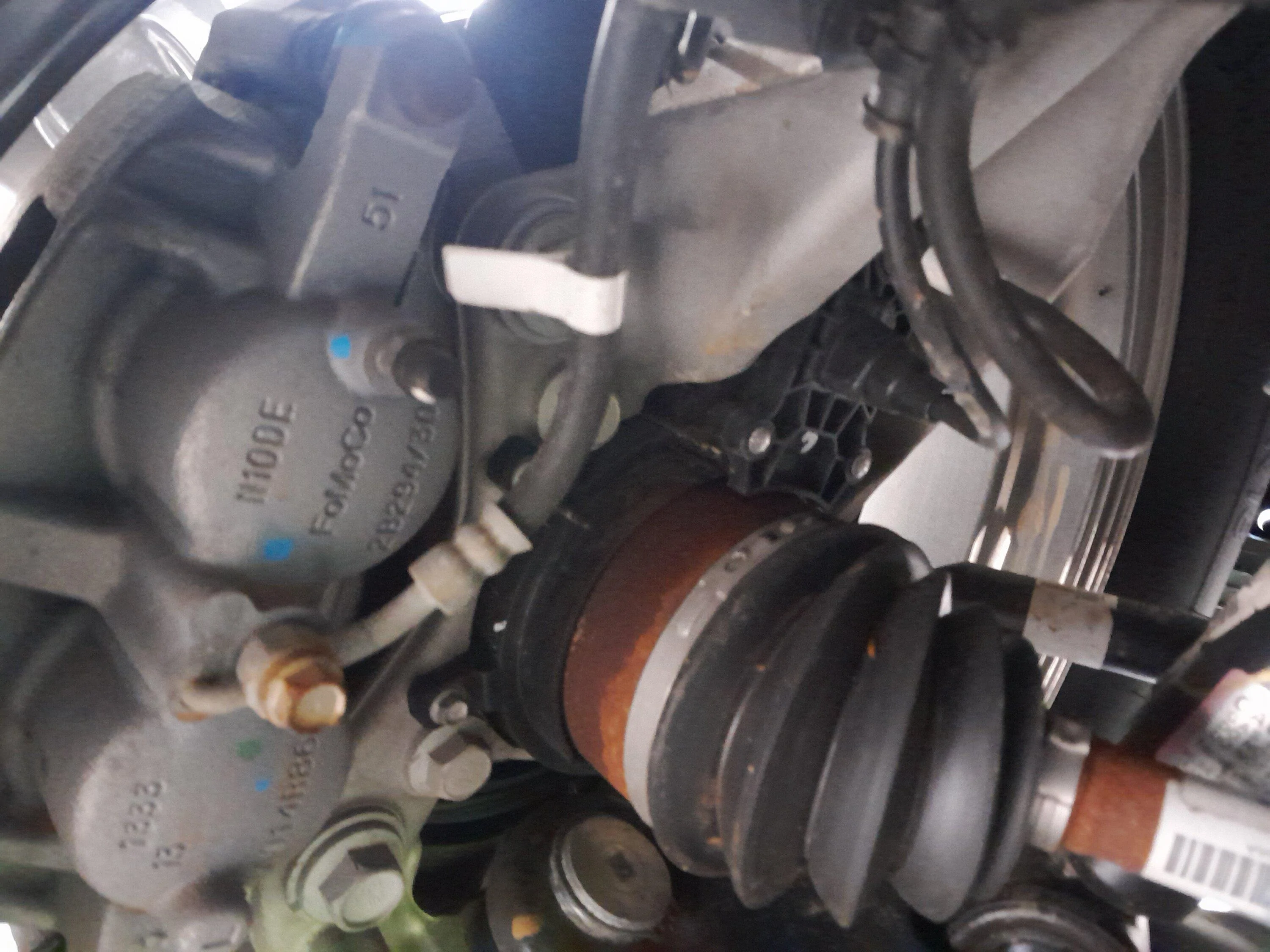

Can you tell me which of the rubber tubes/hoses is related to the IWE? I have a MY22 PB XLT 302A High.
Ford F-150 I have 2H/4H/4L, where is 4A? 20220810_104922
Ford F-150 I have 2H/4H/4L, where is 4A? 20220810_133101
Atlee
Erroll
Sep 14, 2021
1,282
1,314
Mechanicsville, Virginia
retired
Atlee, those "rubber tube hoses" can be misleading when discussing IWE.
For decades the hose was a vacuum hose, so it's easy to mistake one of the hoses on your IWE as being such.
They aren't.
1 is a low voltage wire.
The other is just a vent tube to atmosphere.
