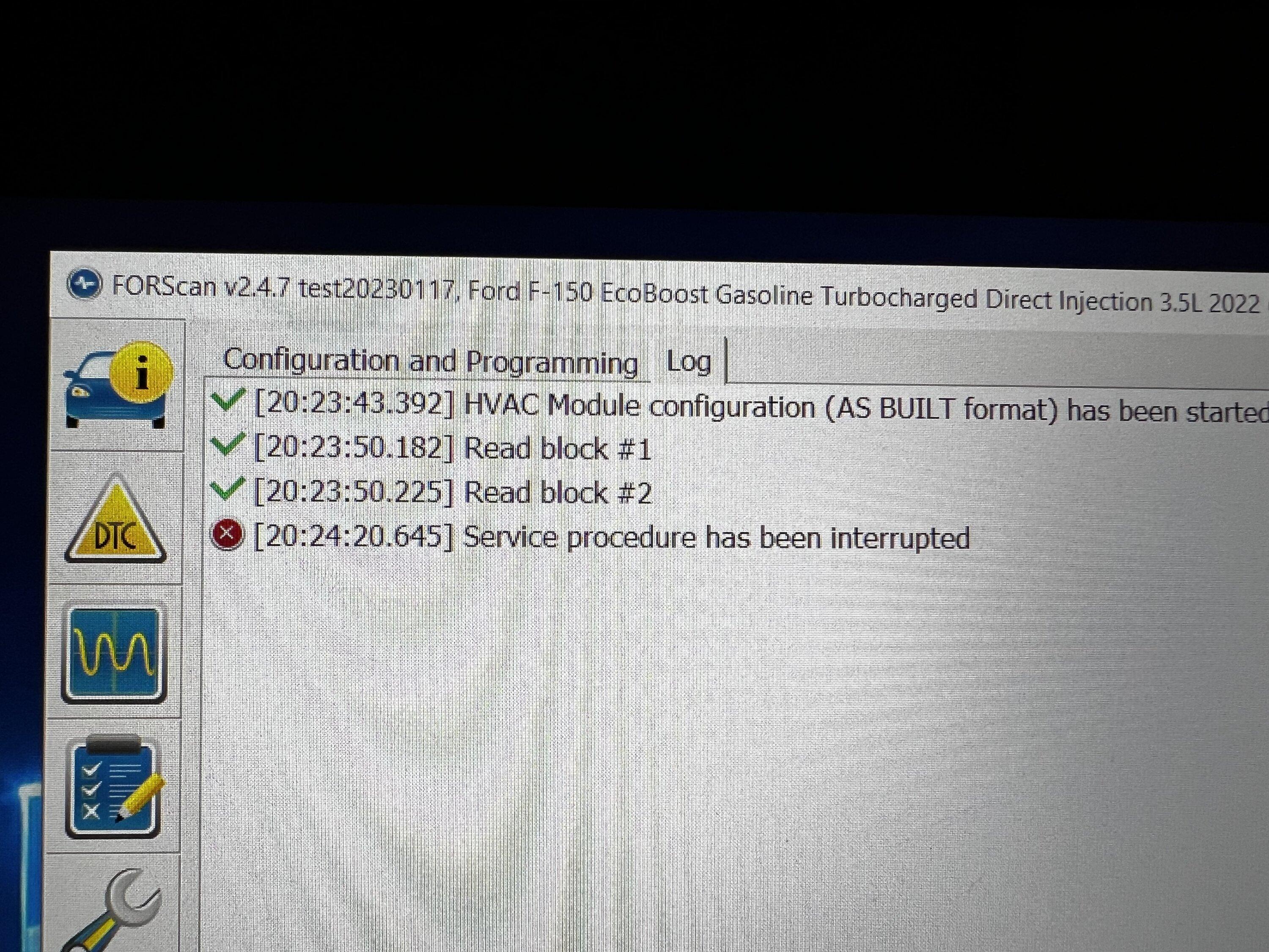

It is failing on the write. It reads fine.
I was using the OBDLink Ex wired adapter. I have a couple other cheap ones too I can try.

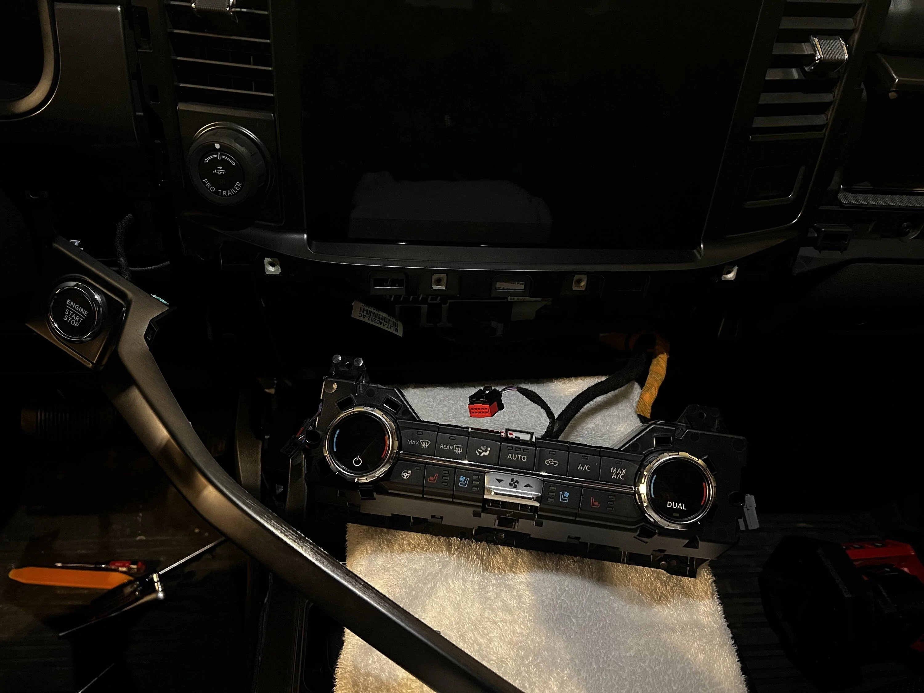

21 module is in. I just installed my 22 back in the surround with the radio controls and stuff but neither was actually in my truck. I had the whole thing out to do the cup holder lights.
I’ll get the laptop connected now.

I had to upgrade to a beta version of Forscan for it to talk to my 22. 2.4.6 Otherwise it did the service interrupted. https://www.forscan.org/forum/viewtopic.php?f=13&t=19552
I did replace my HVAC module. You can't do a PMI in FDRS since the new module is a different part number then what is in the inventory of the truck that Ford has on file.

I’ve tried the latest beta version of 2.4.7 with no luck.
I think it’s the firmware on the module.
