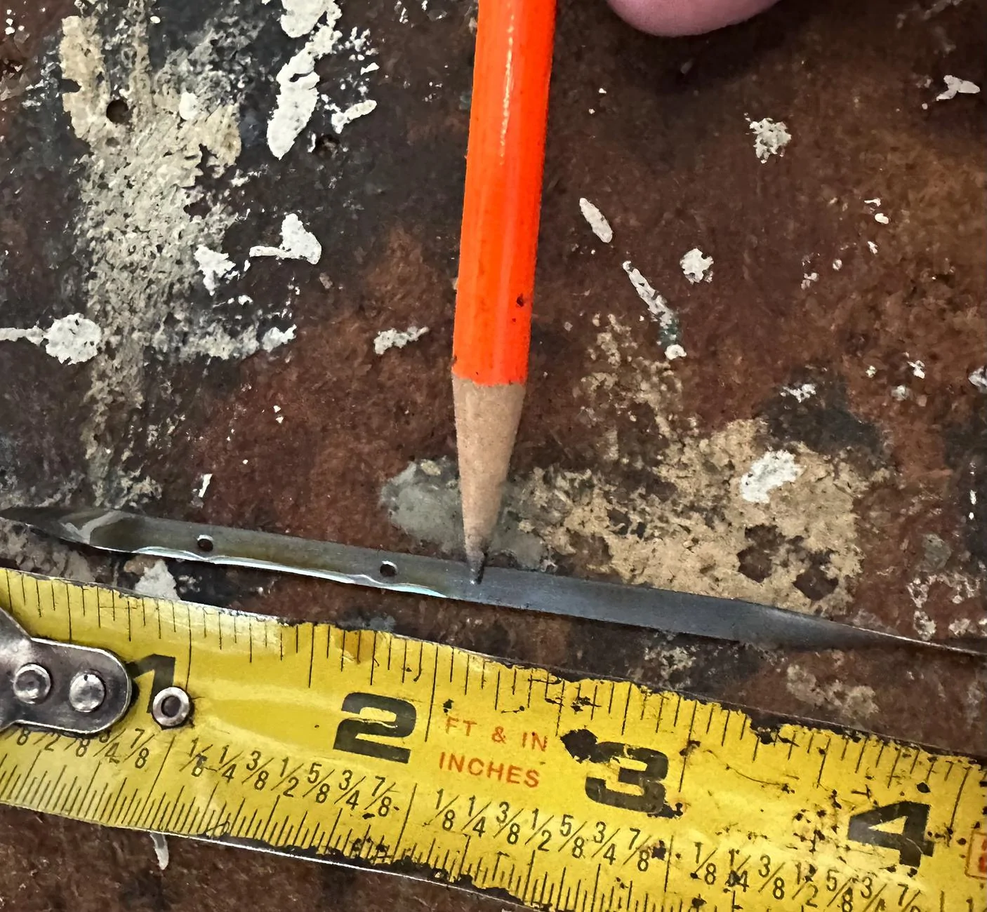

Had dealership change my oil, 2022 F150 5.0 ( Motorcraft 5W-30 semi syn), but the DIP stick is reading 1/4 - 1/2 inch higher past the second hole on the dipstick? Is this a problem or normal fill past the max fill on the reading? I read the manual and it say's MAY cause problems.. Don;t want to cause issue for Dealership mech but the bill was $128 for an oil change!!!
I measured my garage floor and perfectly horizontal with bubble square and waited 15+ mins to read it. *Just wondering as this is my new truck.

A high level can damage the engine. The issue is if the crankshaft touches the oil it can cause frothing of the oil. This then can lead to starvation of the bearings...nNote it happens if you check oil before the first run after filling the level will be high since some oil will be retained inside the engine. But 1/2" high is too much. Keep in mind that the actual high mark is not the second hole, it is a line below that.

When I did my first oil change I put in the listed 7.7 quarts from the owners manual. It was way over the top hole so I sucked some out with a vacuum pump. Ever since I put in 7 quarts even and the level is between the hash marks and the top hole the next morning.

Just returned from Dealer who made me wait around and sent me home with instructions of wait 10 minutes and check reading. I sent back pictures of my plumb garage floor and the reading of a bit more than 1/4 inch past MAXIMUM reading hole as described in FORD owners manual. THEY have been notified now. Never taking it back but for warranty work again.
