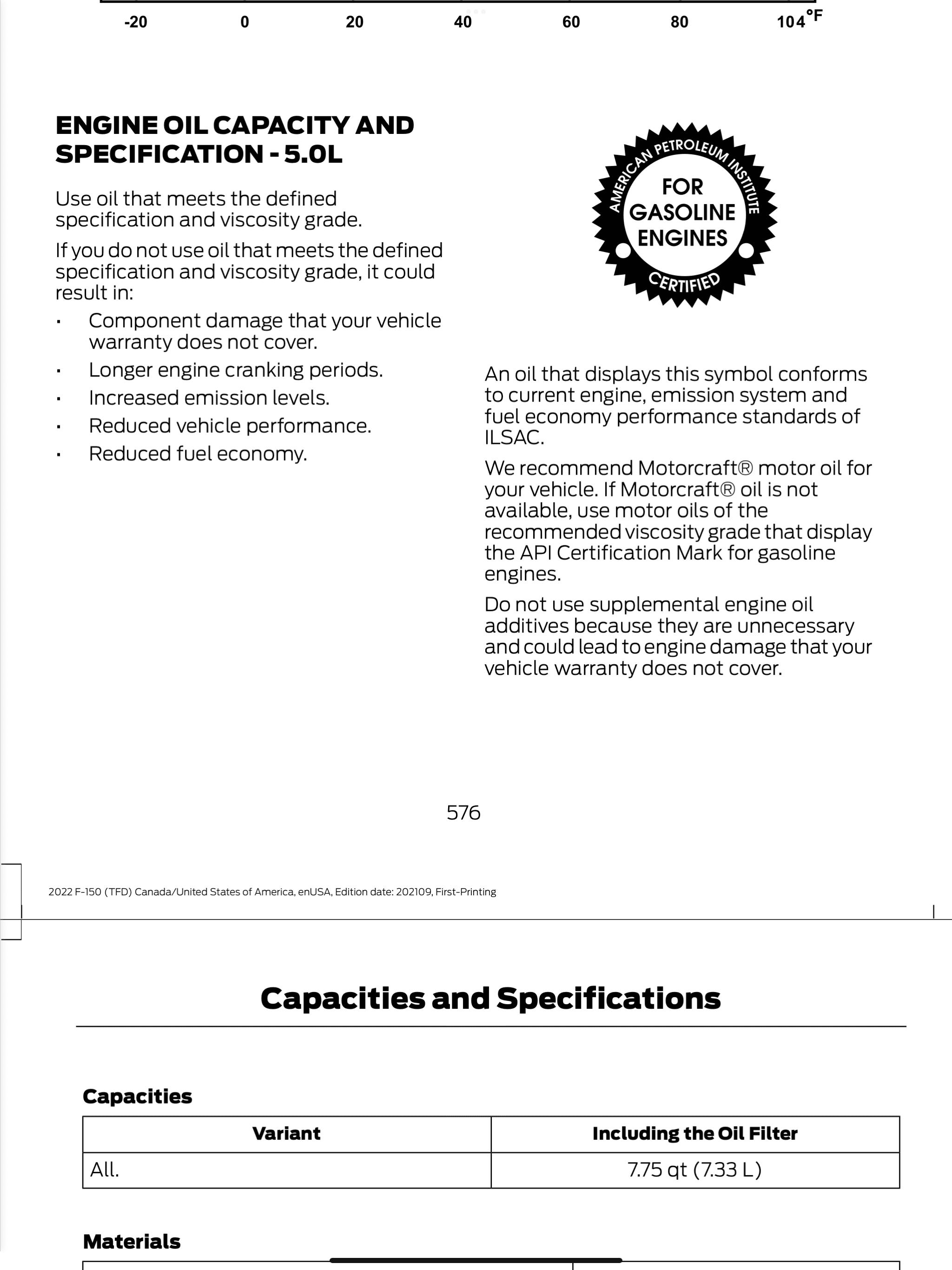

Got my 5.0 first oil change today at dealer. They put 8.8 qts in it. I asked about the 7.7 fill. They were positive the 22 v8 took 8.8 qts. Now it’s way over full on the dipstick. Anybody have any insight for me.
thanks in advance.

I'm pretty sure mins was overfilled by the dealer as well.
