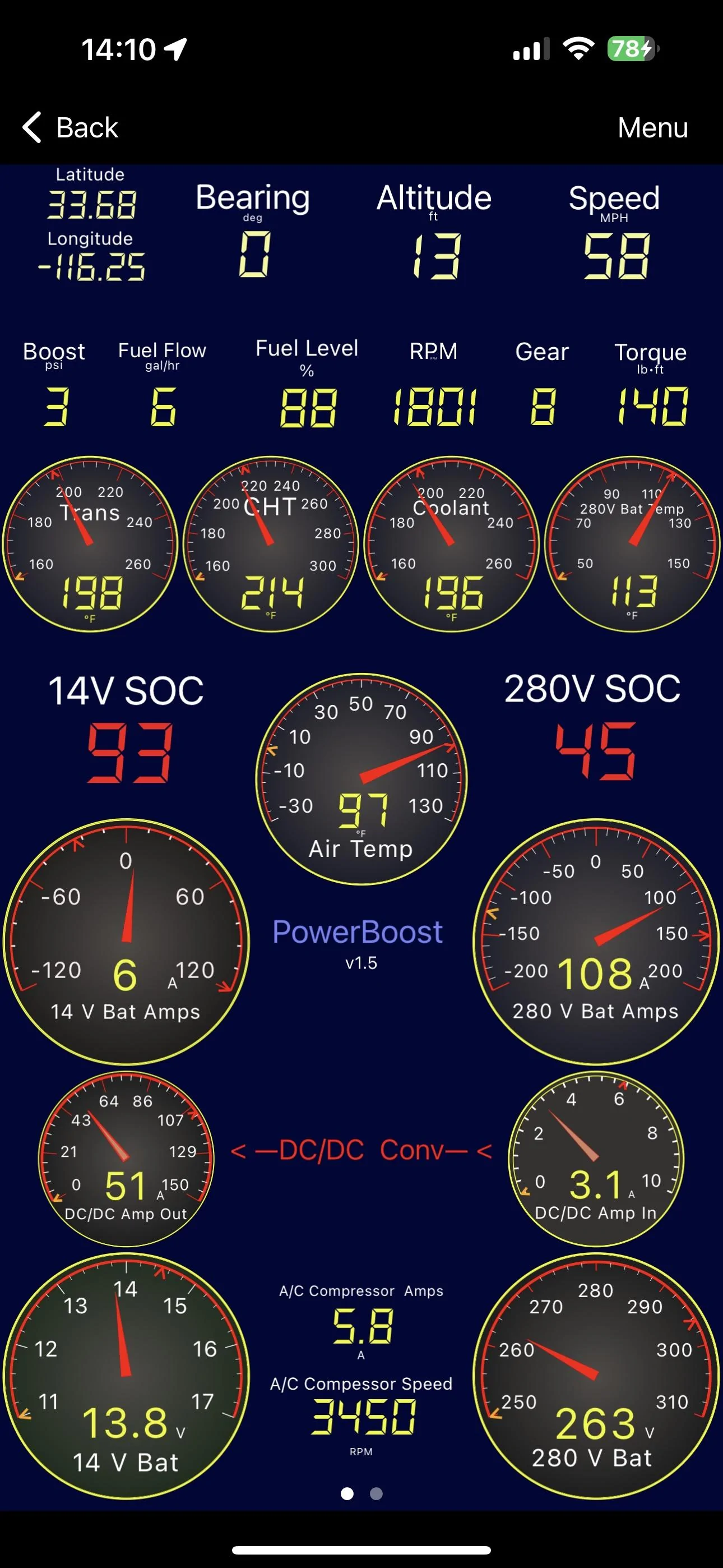

Here is my routine for the "Two Step Start". So far it works.
1. Get into truck and shut the door.
2. Lauch OBDLink and observe both SOC levels and 12 volt amp draw. DC/DC converter has not awakened yet.
3. Press start button with foot OFF off the brake.
4. Observe volt/amp changes as the DC/DC converter comes on line.
5. Clear all the "OK" messages.
6. Foot on the brake.
7. Clear the "OK" message.
8. With foot still on the brake, press the "Start" button.
9. "Ready" light appears.
10. Set AC blower to "5" or more.
11. Confirm 12 volt system voltage at 13.8 to 14.2.
You are good to go.
Monitor your SOC's for the last shutdown of the day. No science here. I like to keep my 12 volt system 90% or above and my 280 volt system into the 50's or 60's. You need more than idiot lights to monitor this truck for optimum operation.
