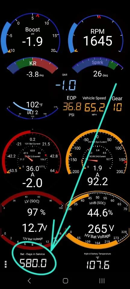

In thread #34 above you show a screen shot from what looks like a cellphone, correct? If so, what is the app?
That's OBDLink Android app using the OBDLink MX+ adapter. (an dedicated extra phone without a SIM. Not my personal phone)
I'm an admitted PID nerd. Have been for a couple of decades.
