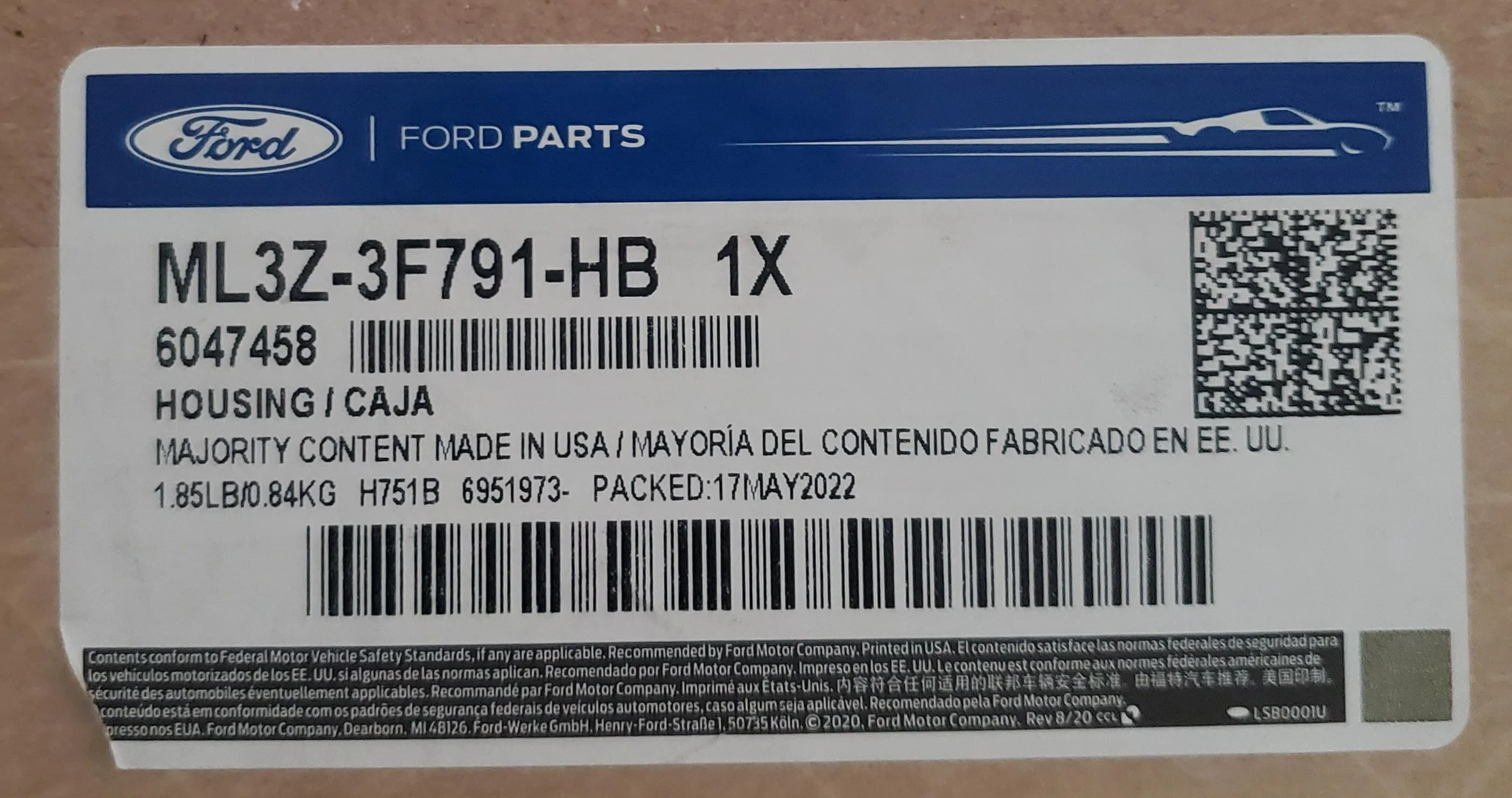

Ok guys, just a quick update.
I ordered the ML3Z-3F791-HB (SCCM) (see pictures for reference) for my 23 Raptor and was able to finish the heated steering wheel retrofit. It seems like the ML3Z-3F791-BB is only suitable for all other trims besides the Raptor as it doesn't recognize the Raptor specific left and right steering wheel buttons.
I now have a brand new ML3Z-3F791-BB unit at home that I will sell.
is this the one for a 23 platinum? i have the clock spring.
