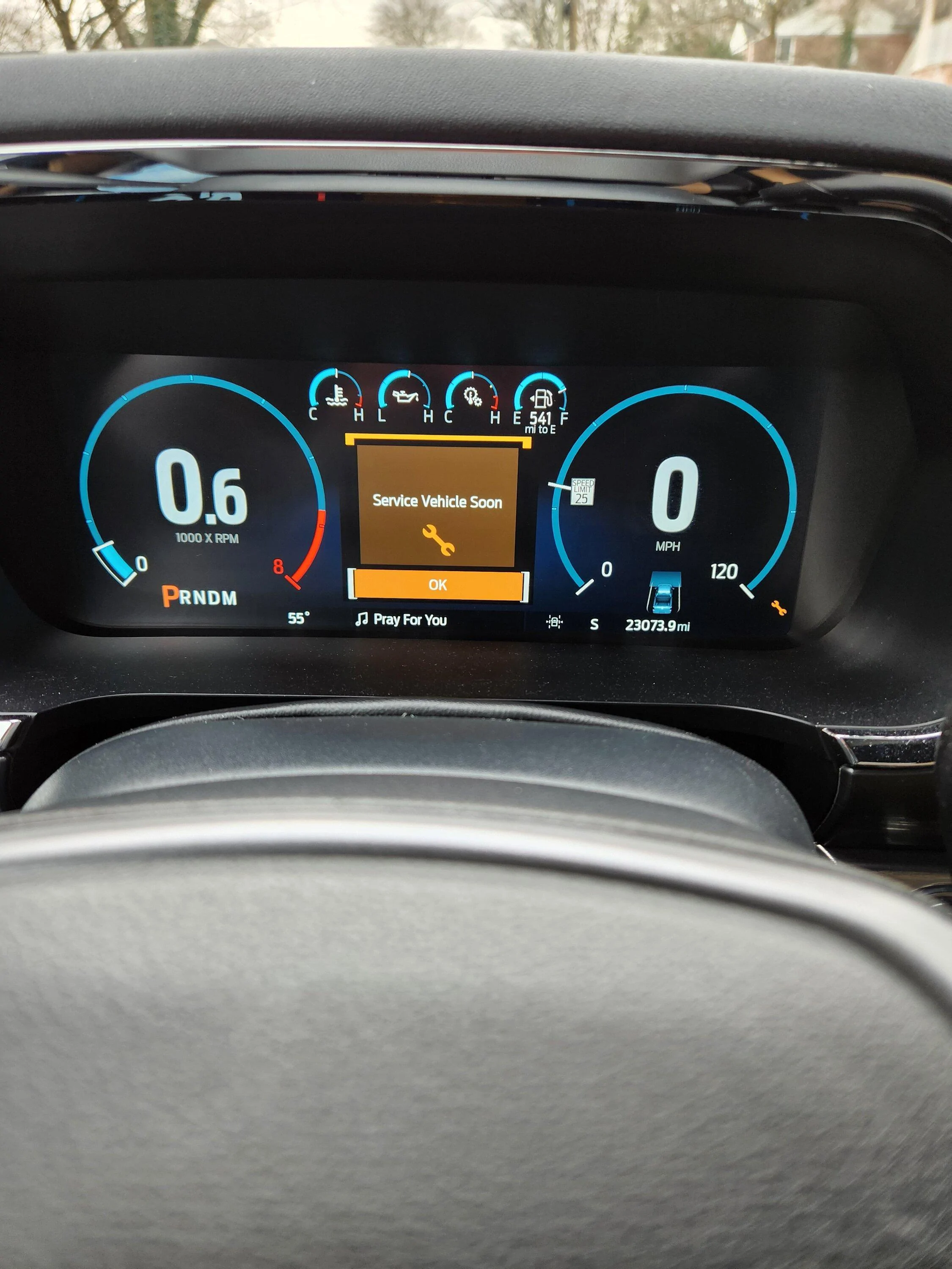

I just got my update 2 days ago. My wrench just turned on 10 minutes ago. I noticed smoother shifting and today seemed like an increase in power. I don't think I'm imagining it. What did this update actually do the details aren't very specific??? hahah
There's things listed in the update notes that may have been affected but I haven't noticed much other than the wrench. The actual fault code is U031D-00. States it is "Software Incompatibility with Parking Assist Control Module A" being the current DTC and causing the warning lamp to be on. It doesn't seem to affect the truck at all that I've noticed. You can clear it and it might not show back up until you drive it 2-3 times but it has come back every time I've cleared it without fail. Not sure how to fix it myself but I have an appointment to drop it off at the Ford dealer Saturday morning and let them figure it out. Hopefully it's fully covered under my 100,000 mile warranty since the truck only has 14,000 miles on it haha.
That pretty much lines up with what Jesse was mentioning. There's a good chance that the IPMA update should have been a prerequisite to the PCM update.
The code description is a bullseye.
And it would explain why the drivability is just fine regardless of the instrument cluster warning.

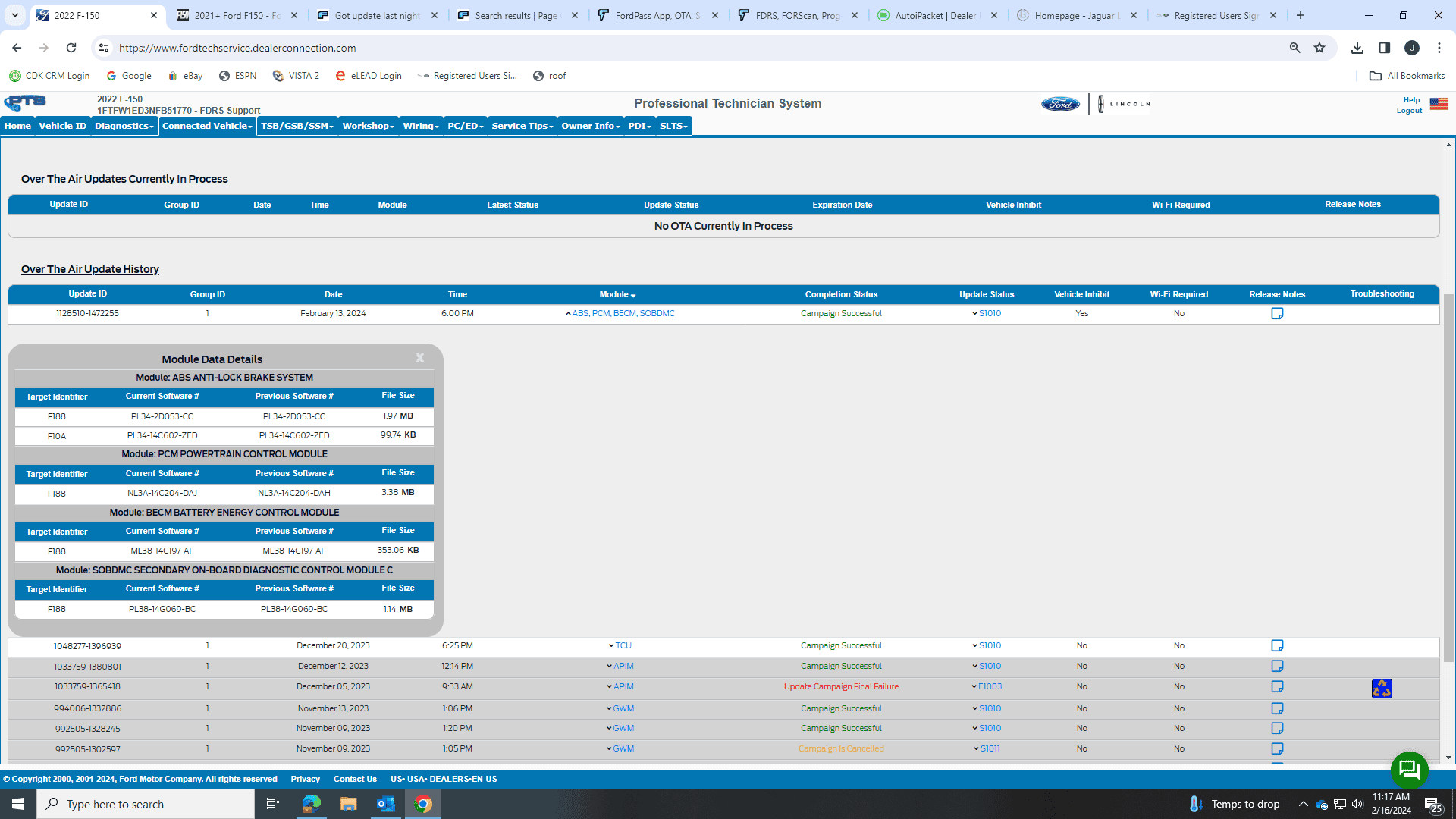

This is what was updated. Release notes read:
Group ID 1 - Software Update
Your vehicle has been updated with following:
Powertrain Your vehicle's powertrain software has been updated to help prevent a possible error state where a "Stop Safely Now" message may appear. Stability Improvements Your vehicle is now enhanced with improved stability during low-state-of-charge battery conditions, and you will get more reliable warnings in the driver display when low-state-of-charge conditions exist. We have made update to your ABS calibration to optimize your vehicle performance. Approach Detection Approach detection functionality has been added to your vehicle which recognizes when you are approaching to the vehicle with a valid key fob and will provide the welcome animation. You can enable or disable the approach detection on the Sync screen.
Priority Update 23-PU1009-SS-NS
