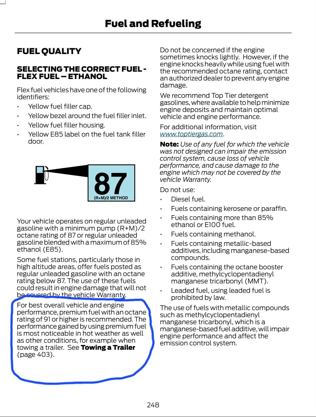

While Ford fully supports running 87 in the Powerboost, they also state 91 for towing? (at least that's what I recall)
Edit:
Ford F-150 gas octane question for PB F150 Screenshot_20230424_093233_OneDriv
I'm aware, but I'm also only towing between 4000 and 5000 lbs.

I've only used 87 in my Powerboost. I realize that the manual recommends 91 octane, but I have found no detrimental effects with using 87. Although in MN, ethanol is added and required, so YMMV, literally.
