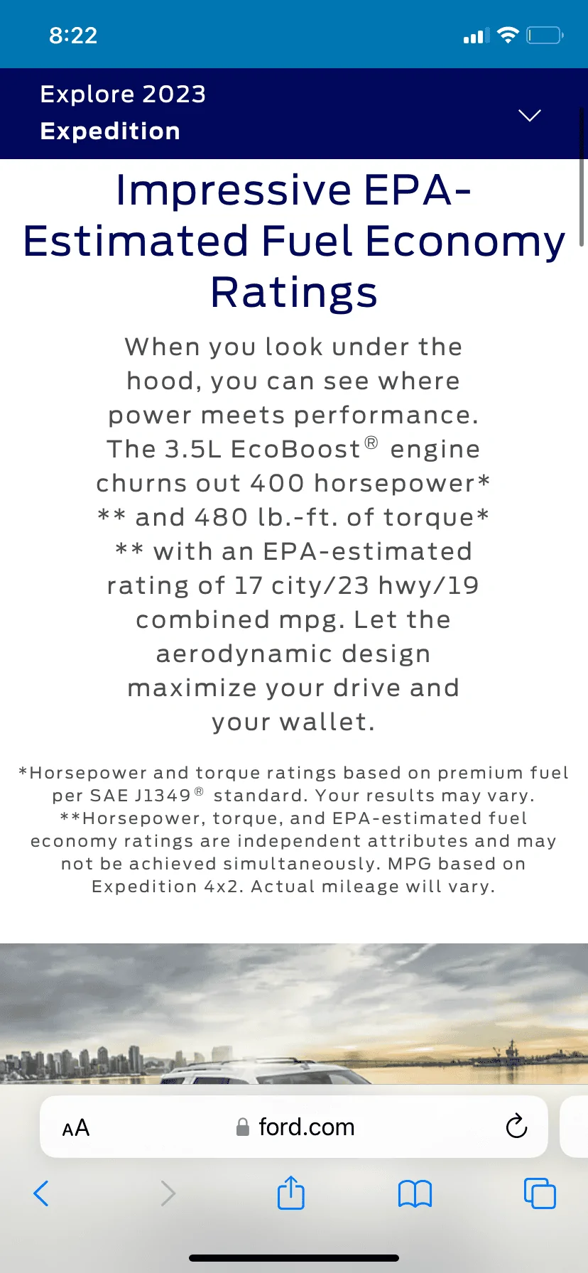

It wasn't always.
In 2018, the small print on Ford's 3.5 Ecoboost ratings for the Raptor stated 93 octane. For the non Raptor it stated 87.
I don't know what it is currently, but as you stated, maybe it's all 93 now.
You know I noticed on Fords website there is a note under the 3.3, 2.7, and 5.0 that say power ratings are based on premium fuel but that note isn’t there on the F-150 page for the 3.5 Eco BUT… the Expedition 3.5 DOES say premium fuel required for the 3.5 and it has even less power than the F-150. Fords site is missing so much info….and I just found yet another blank spot lol
Yeah... Ford could be a tad more specific... (wink, wink, nudge, nudge...) The engine is designed for a specific minimum octane rating, that's 87. I don't have a problem with them saying when towing a heavy load, summertime, steep road, lower RPM, use a higher octane. That allows for wear and off-design things they can't predict... But at the end of the day, my read of the manual says the design point of the Powerboost engine is 87 octane.
I'll see if I can find the same sheets for the 2018 Ecoboost. It stated 87 and the Raptor stated 93.
But Ford does, and marketing wise should, keep some separation between the Halo truck and it's sibling.
Although they couldn't do anything about that 570ft lbs of torque that the mighty Powerboost has. :)
The aftermarket tuners have pretty much proven that Ford could release the 3.5 Ecoboost at any power output they desire to.
Anyone monitoring OAR and KR and Timing advance can clearly see how the 3.5 Ecoboost responds to 93 VS 87.
It's not smoke and mirrors
