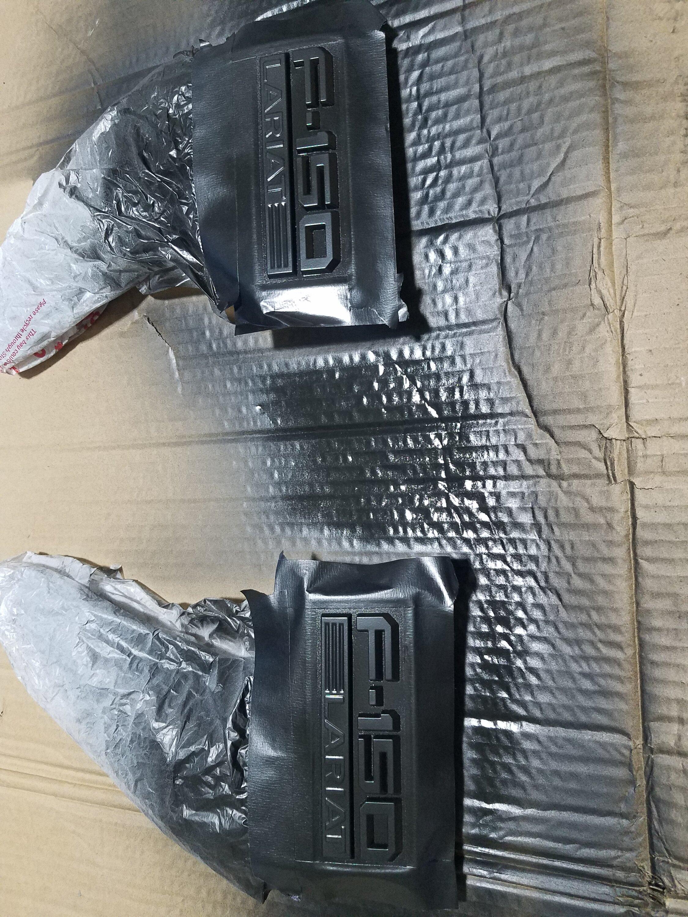

Probably the cheapest mod I have done that made the biggest change in appearance was Plasti Dipping the fender badges and the grille and tailgate Ford emblems. For the cost of a can of Plasti Dip and a can of glossifier, it gave me the biggest bang for my buck.

My stx already has the black fender badges but I really do like the emblems. My luck I'd mess it up then I'm stuck with some jacked up emblems or spend a few hundred on more. Lol
Did you take off emblems to do them or just taped around them

I just masked around them. And the great thing about Plasti Dip is if you mess up, you just peel it off and try again.

Yeah thats true I think I'm going ro try it. What all I need just a can or so of plastidip. And obviously masking materials.
Do I just do light coats till the darkness I want is reached

You’ll only need 1 can of plasti dip and 1 can of glossifier if you want a slightly shinier finish. I gave mine 3 or 4 light coats and followed it up with a coat or 2 of glossifier. Wait for it to dry and peel off the areas you don’t want covered.

Well I think this weekend I may try this out. How long between coats I need to wait to apply another
