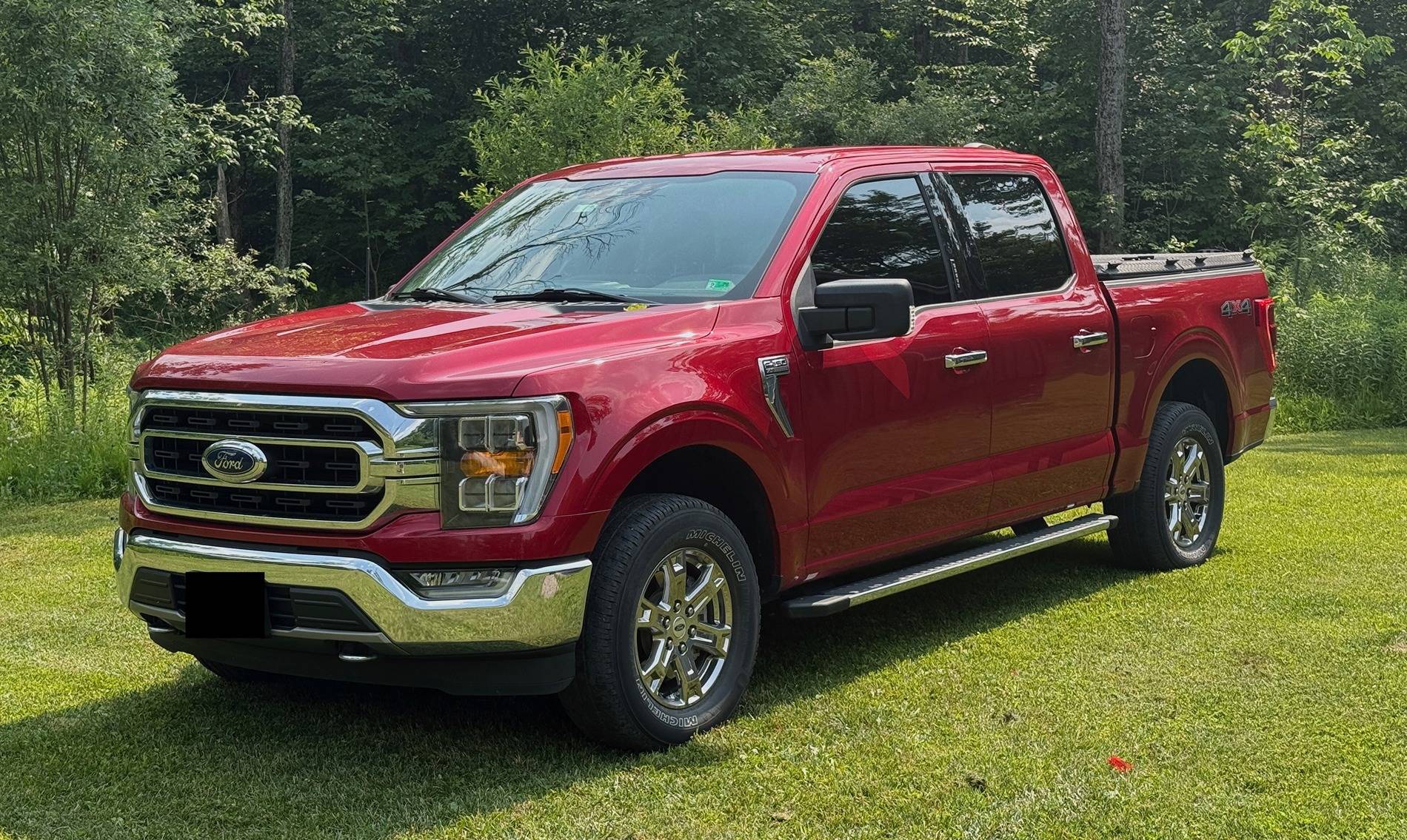

This is my 2021 XLT 5.0. I want to make some mods to make it more aggressive looking. Tires, wheels, and leveling kit to start. But nothing that will change its ride, handling, or noise level. It currently sits on 275/65R18. I'd also like to tone down the chrome. Anyone have ideas? Thank you.

Any vehicle you change suspension, wheels, tires WILL change the way it feels from stock. There is always a compromise to modifications. Even a small front strut spacer with stock struts will make the truck feel a bit "loose" when turning due to the higher center of gravity. Wheel and tire size also change the softness/firmness of the truck's suspension. The mods with the least amount of change from stock with more aggressive look would be 2.5" front level kit (bilstein/fox struts) with matching rear shocks, 17" wheels with 33" All terrain tires like (BFG KO2, Wildpeaks, Open Country).
This opinion if from someone that has modified F150's with lowering kits running 24" wheels, all the way up to 8" lifts on 37's.

I would say either a set of fox or eibach coilovers are going to give you the closest ride to factory. From what I've read on here the bilsteins are a tad stiff compared to stock. I personally run the eibach and absolutely love them. However, opinions are going to vary from person to person.
To maintain good ride quality stay away from any E-rated tire. Id recommend a 275/70/18, OE size that comes on the Tremor. If you are after a different set of wheels then you have hundreds to choose from. Although, you may be surprised on how good the truck looks with a small lift and a good set of tires on it..... Even with the stock chrome wheels.
Another thing to consider would be finding a paint matched front bumper and some painted door handles. This would reduce the chrome tremendously and give the truck a different look.
