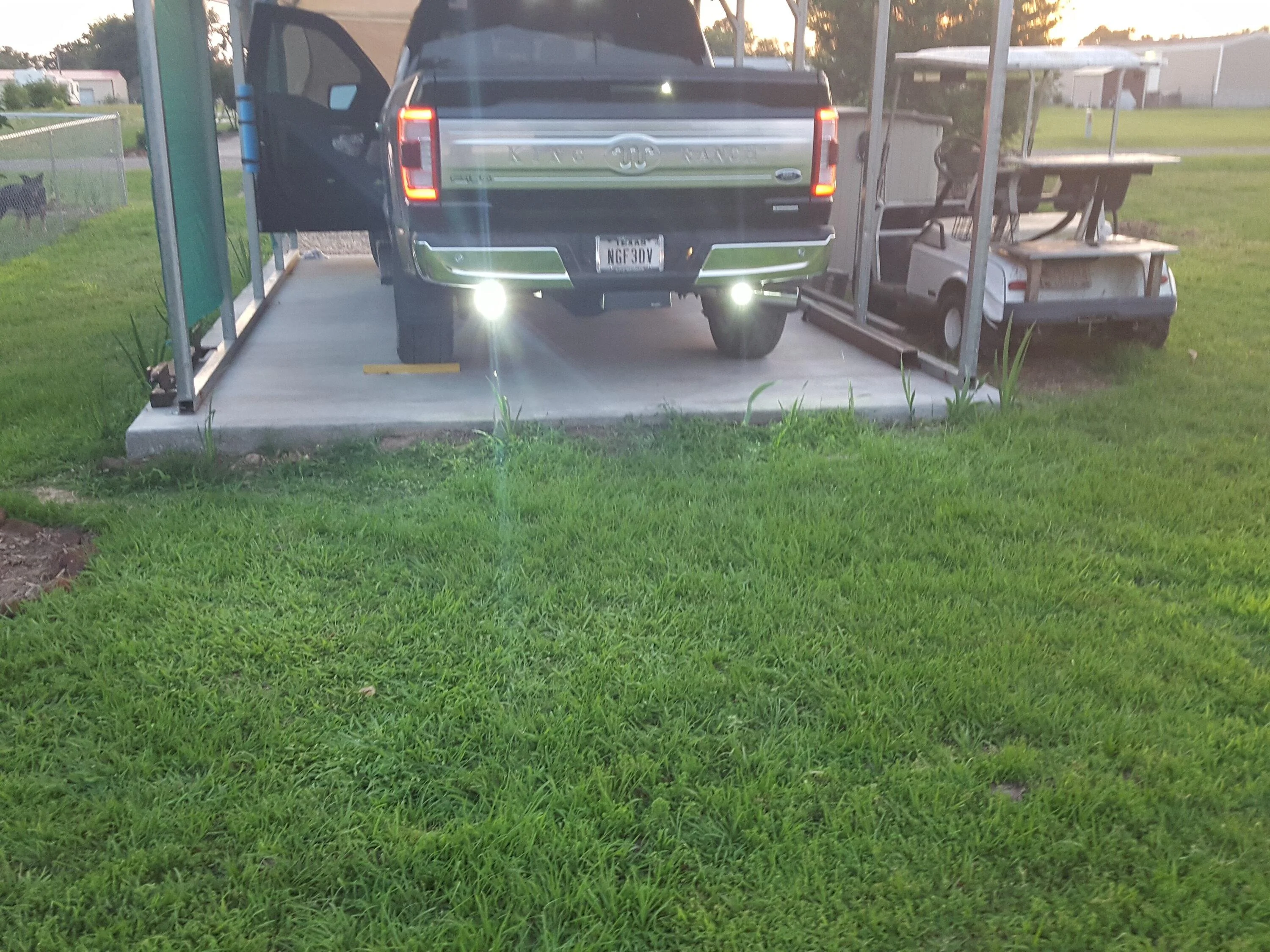

maybe these
Ford F-150 Found unknown toggle switch leds6

Some kind of lighting I would think.

Looks like someone bought a roll of five pin trailer wiring. Who knows why. I'd remove the switch, fill the hole, and follow the wires. Then perhaps you'll find out.
Best guess, a bunch of LED lights.
