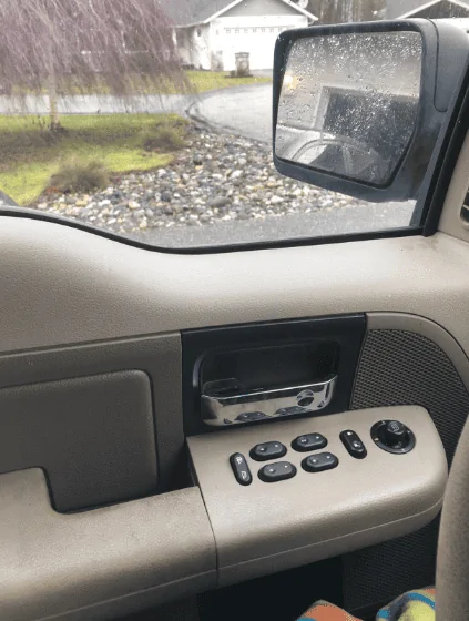

I have a 2006 Ford F-150 extended cab. The door glasses were not rolling up or down properly with the driver switch but worked with the other switches individually so I concluded it was a switch problem and not a regulator problem. So I bought this new window switch from AUXITO. Took 30 seconds to remove the old one and install this one. There's a tiny bit of bind where a little bit of plastic didn't line up but I just pushed a little and it went in with no issues. Unexpected result was all windows appear to operate faster than before replacement, more like when the truck was new. I always assumed the motors were getting tired but it seems there was some voltage loss through the old switch assembly as they aged.
