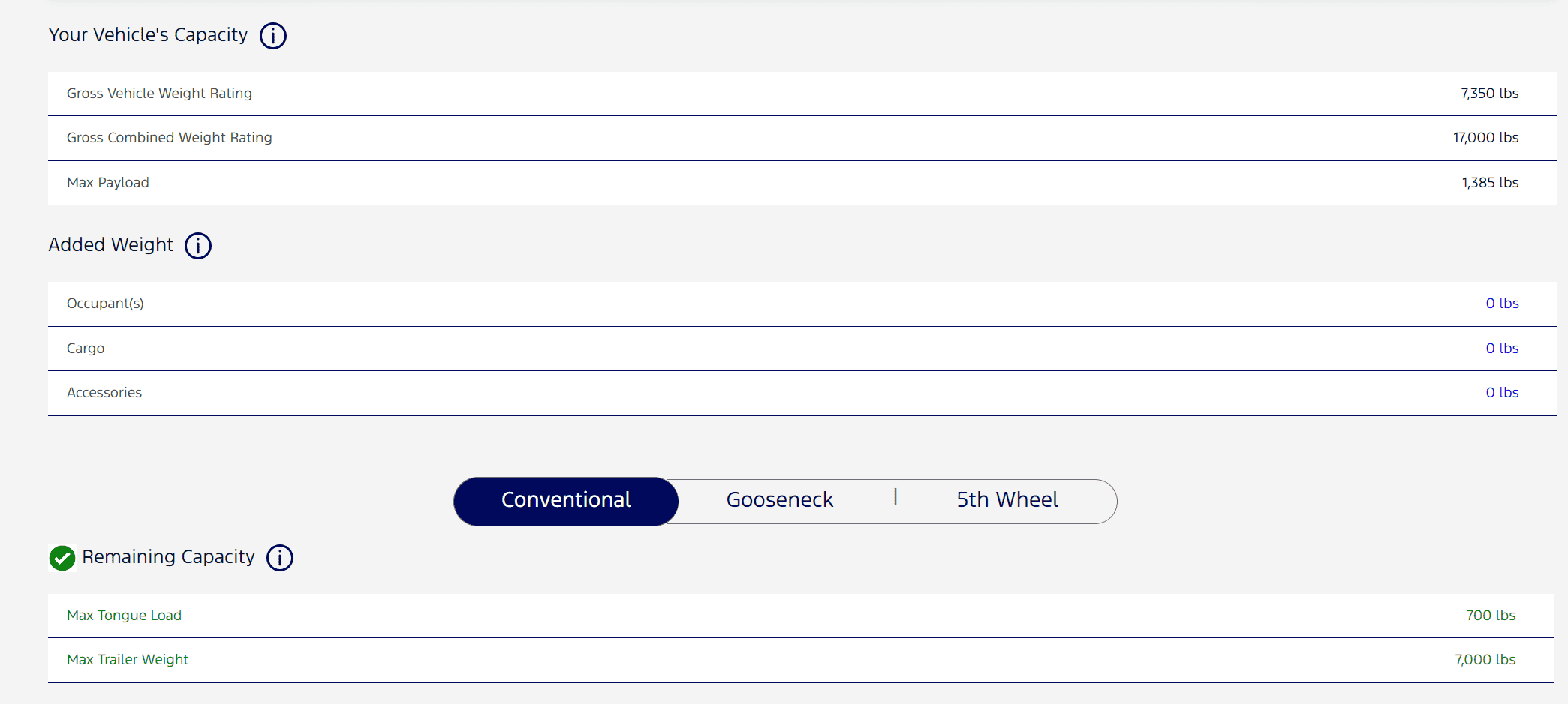

It's not doing that. 1385-500-50-50 is 785 left for tongue weight not 700. It was possible to order the trailer brake controller, and pro backup assist without having either tow package and without either tow package the truck is limited to 7000. The sticky at the top of this sub forum explains what's in the trailer tow package and the Max Tow Package. Based on the specs he provided he should be okay but on the upper end of what his truck is rated for. I tend to be conservative when it comes to towing, others throw caution into the wind. I for one am grateful he's asking the right questions before buying.

What isn't true? The numbers in my post are from his entry into the Ford towing calculator. If he had the trailer tow package or max tow package the calculator would show something different than just 7000lbs.

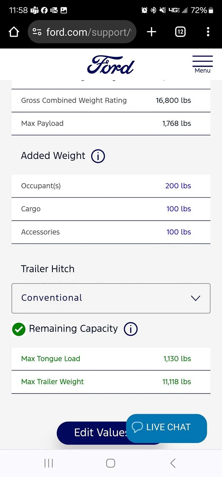

Not true. I have the towing package, but not max tow. I but some false large numbers in the calculator for payload calculations and it says my max trailer weight is 2680lbs. It takes into account what you have for available payload after all additional weight and estimates the trailer weight you can haul from that

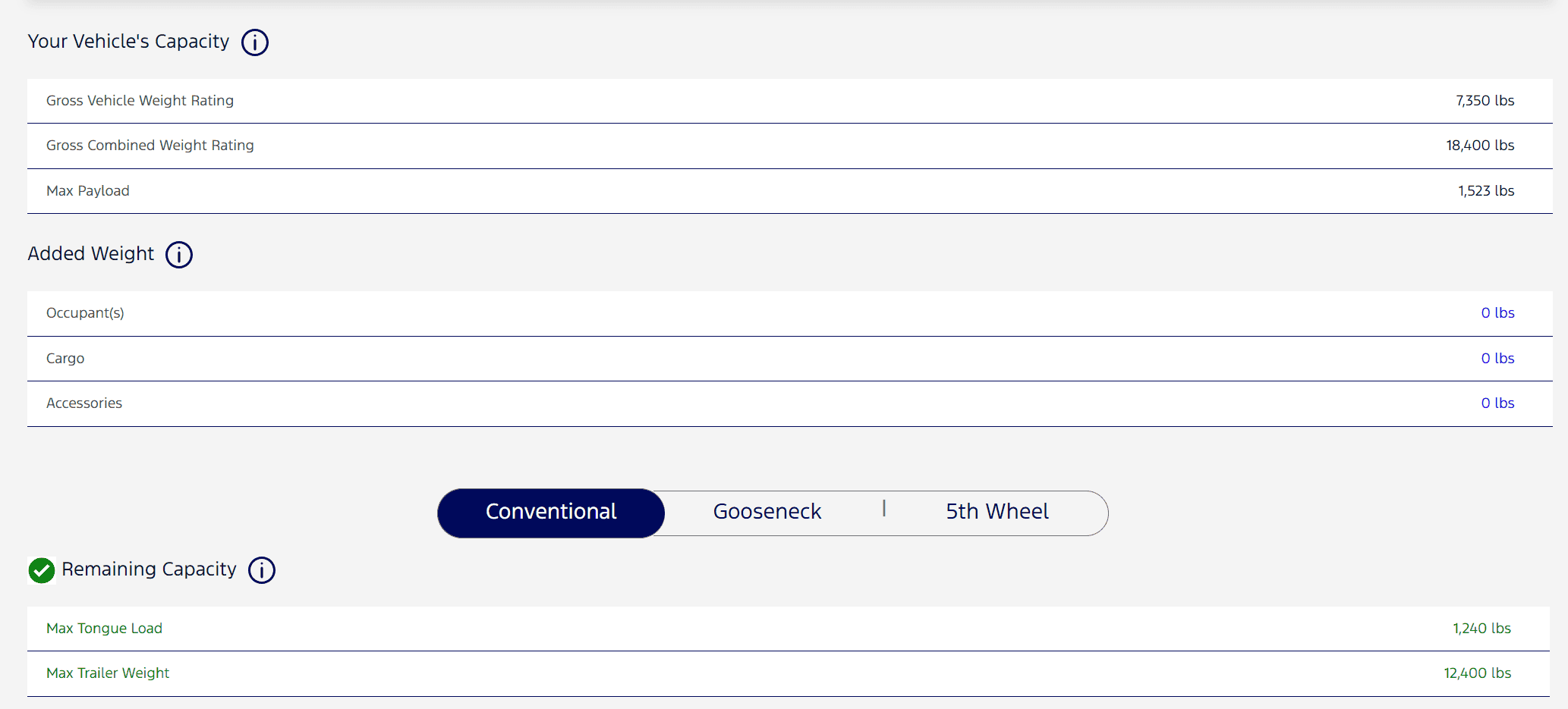

Yes it is true it's in Ford's calculators and the fleet towing guide.
Same calculator with less weight.
Exactly my point the OP had some numbers in the calculator image he posted. If you do the math with those numbers you see his 'leftover' payload capacity for tongue weight is more than 700lbs, so the calculator should have returned that higher number and higher towing capacity associated with a higher possible tongue weight. However it only returned 700lbs and 7000lbs even with lower numbers.

Hopefully this screen shot works.
3.5L Hybrid, 3.73 RE, GCWR =17,100, 4x4 145.4 WB = 11,000.
If thats from the 23 manual, thats my truck. No tow package involved. Hence, your blanket statement of 7K without tow package is not true.

If you grab the OP's vin from the window sticker posted a page or so back and drop in the Ford site, it returns 7000 max for a trailer.
