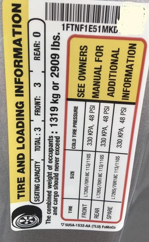

...Do you have 4x2 or 4x4 and what’s your payload?
the 3.73 must absolutely rip in RCSB
Ford F-150 Fake exhaust sounds with a 5.0? CAAF10CE-3701-4106-A7C6-8466F3CDEFC1
My truck is in the 141” wheelbase, 4x4 with the HDPP package and 8’ bed, which makes for a mighty stiff ride empty. The weight is 5,020lbs with a full tank of gas and me in the driver’s seat.
You can get a 5.0 RCSB in RWD at 4,300lbs empty, though that’s probably with the 8.8” differential housing which weighs less than the 9.75” options that are available when optioned out with the 3.73 ratio.
It’s probably quite the handful with nearly 18” less wheelbase and probably around 250-500lbs lighter than my truck depending on if there’s 4x4 or not!
When my tires are nearing the end of their usefulness; I plan on seeing how the truck is with the traction control off.
