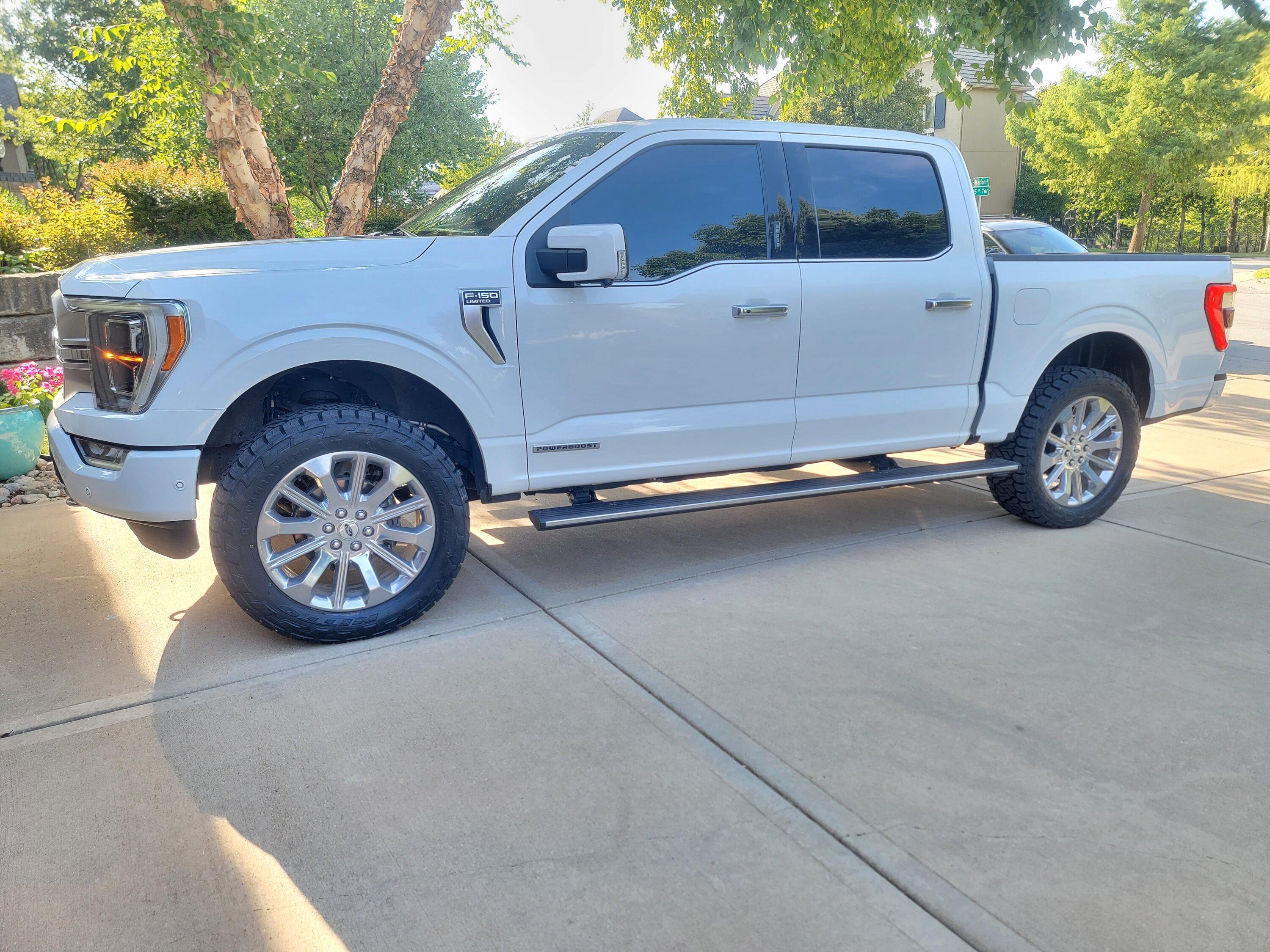

I have those tires waiting for truck to arrive. 275/60/20
Ford F-150 Factory Wheels with Aftermarket Tire Thread 20220415_143033
