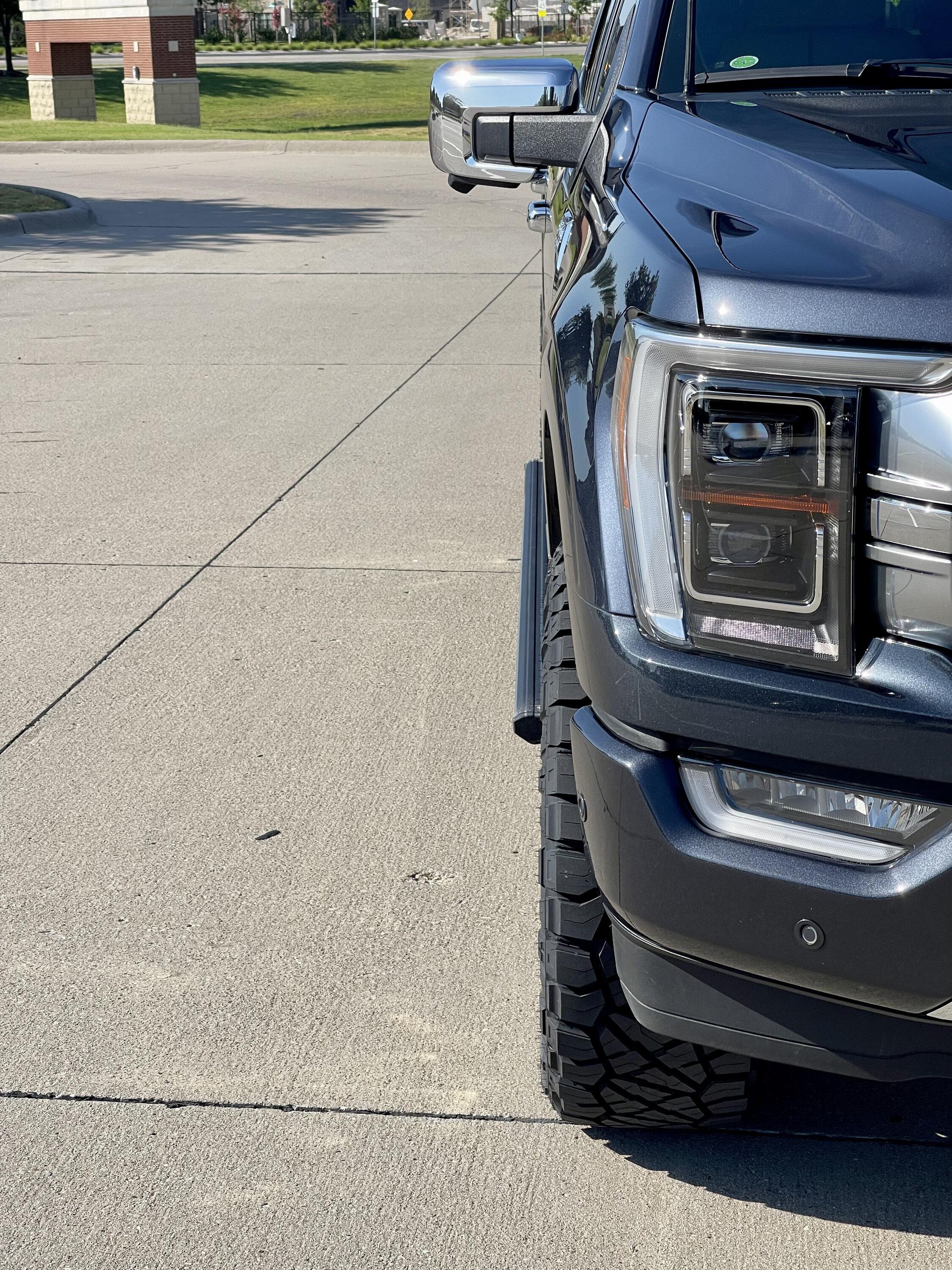

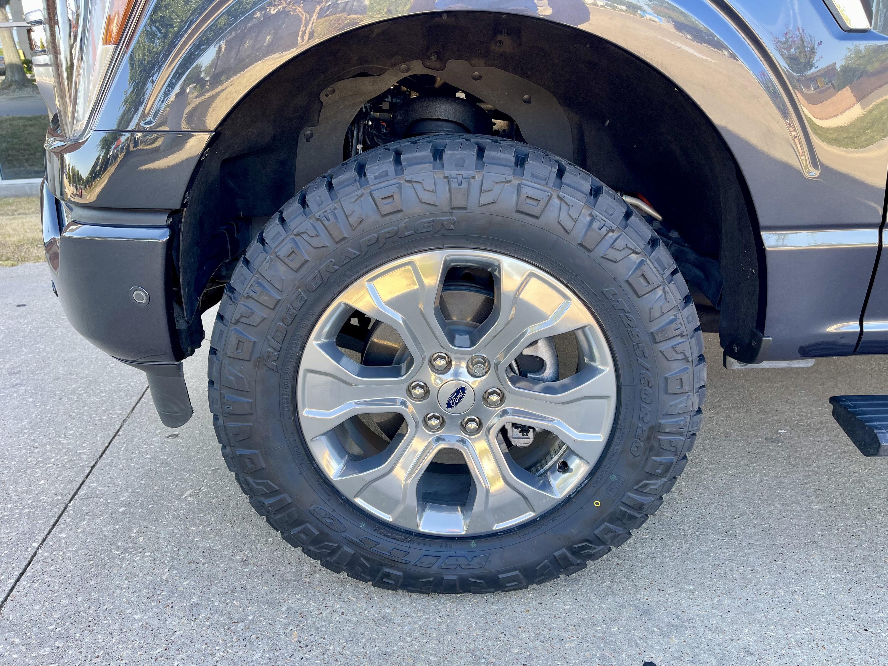

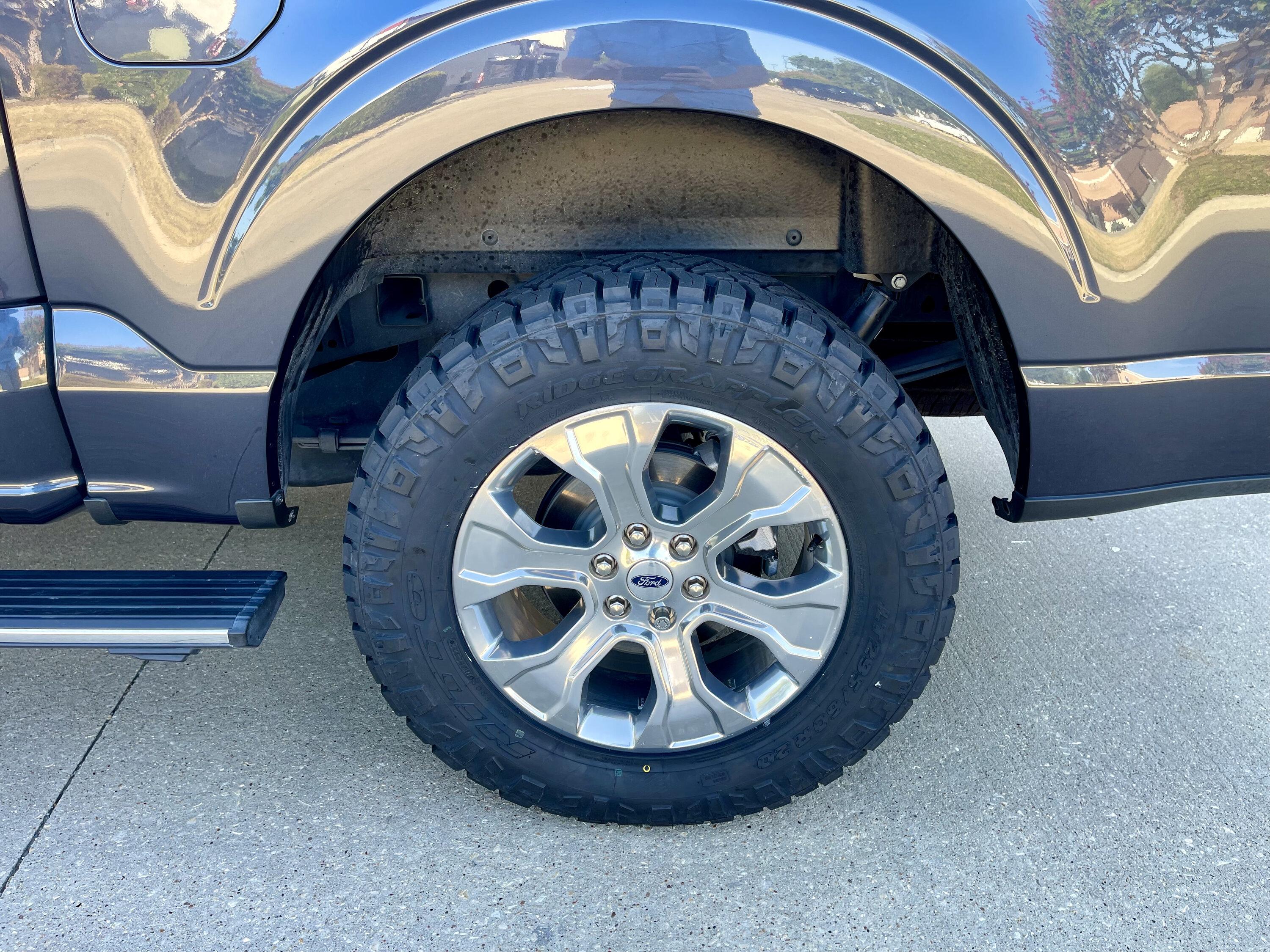

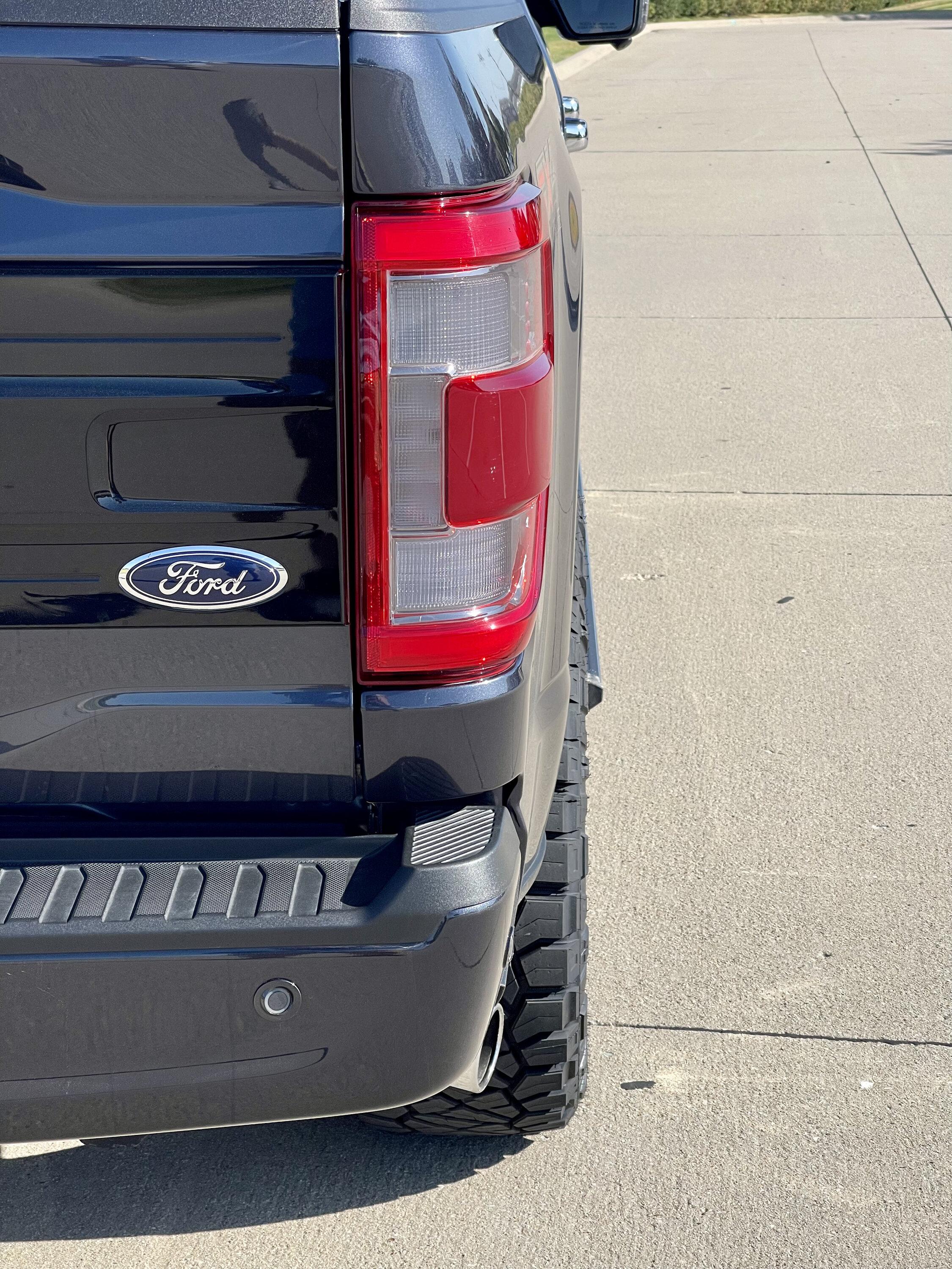

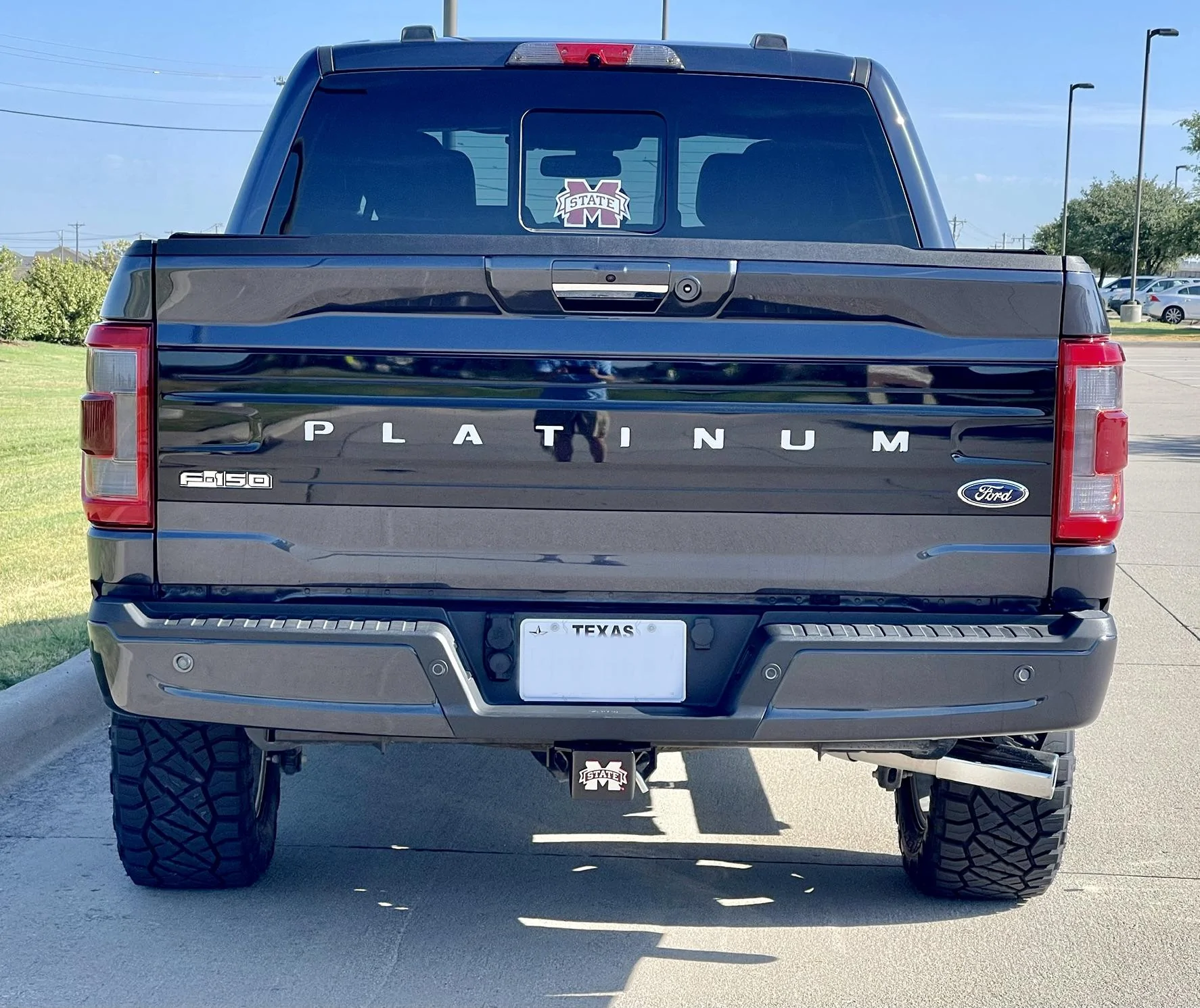

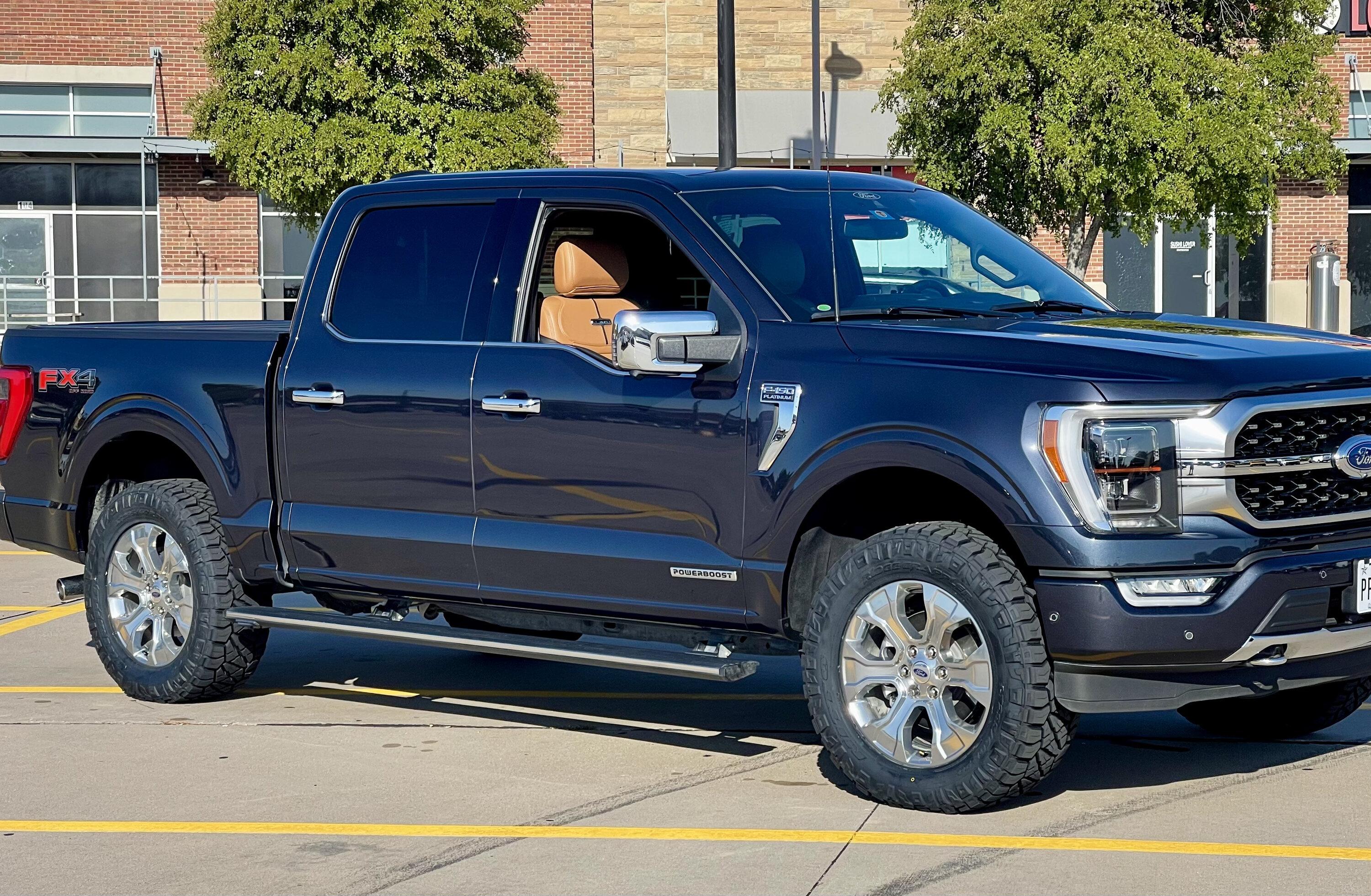

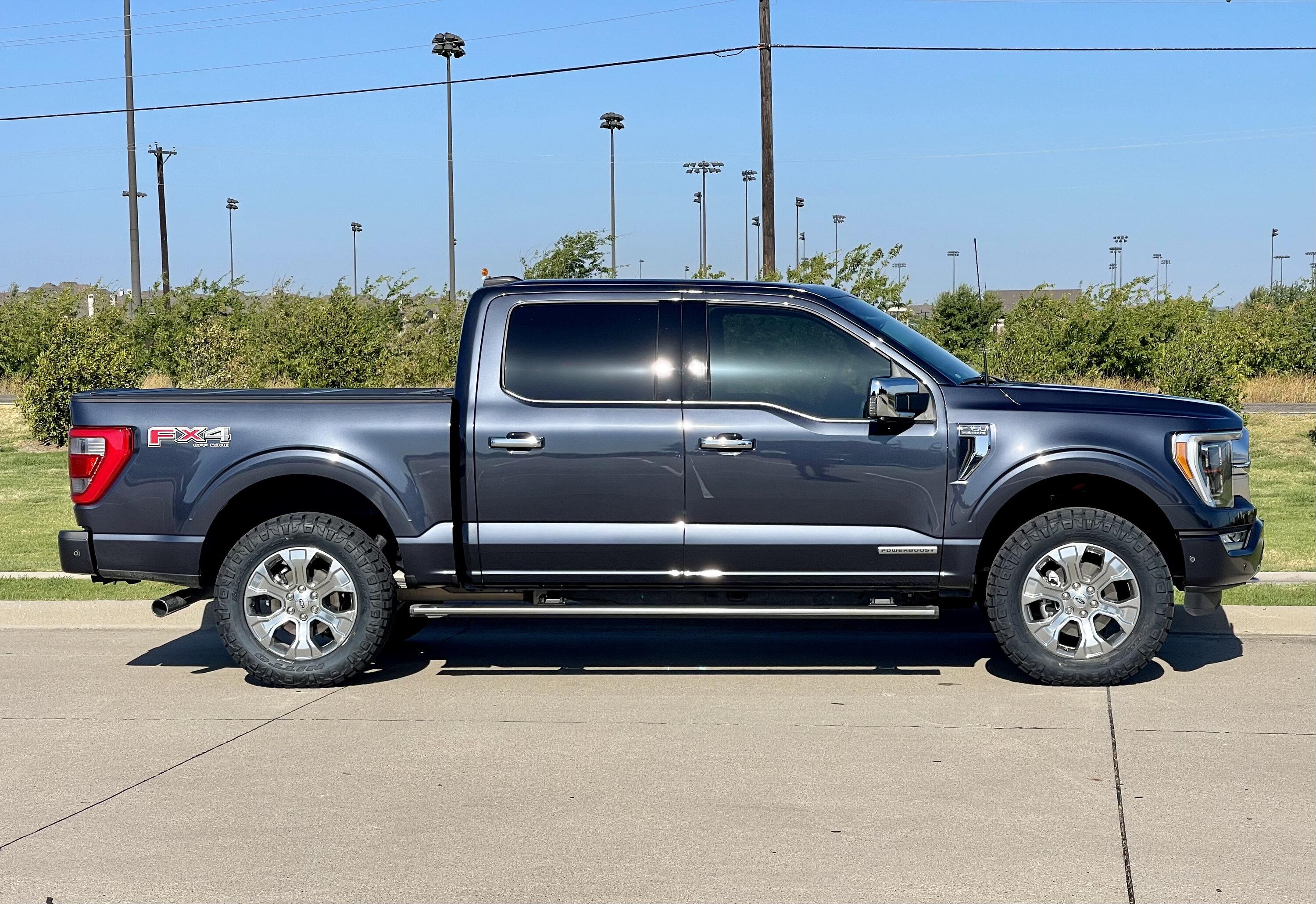

Nitto Ridge Grappler 295/60/20 on factory Platinum wheels + 2" Ready Lift level. No rubbing / no trimming required. These obviously aren't as quiet as the factory Hankooks but are remarkably quiet for such an aggressive tread pattern. There's a slight hum but after a few miles you don't notice anymore. First 15 mile trip seems to still engage electric mode as usual. I'll report my MPG change after a larger sample size.
Current measurements - FRONT 39-9/16" // BACK 40⅜" (Now that the truck is a year old the suspension has settled about ¼" front & back, compared to new.)
