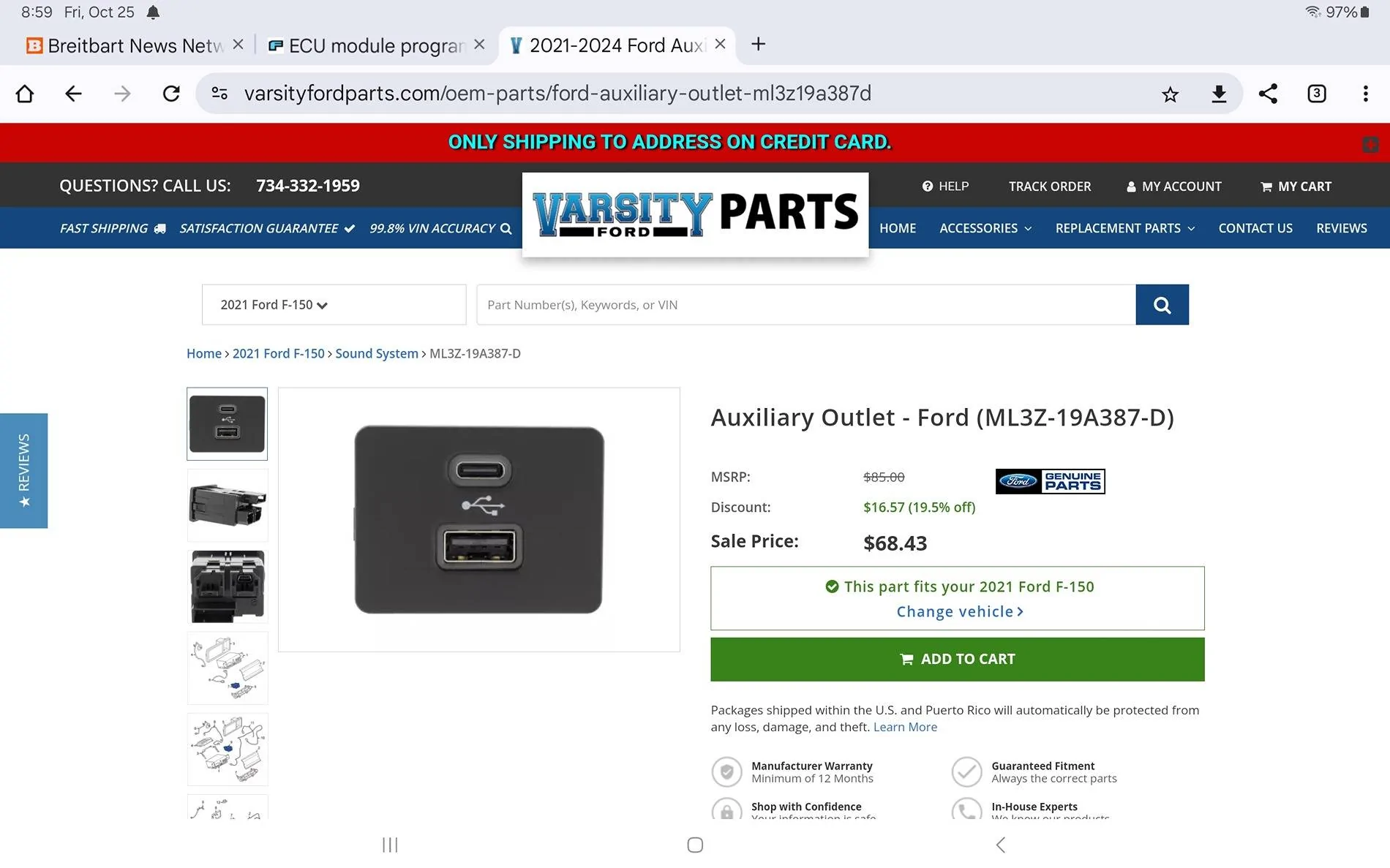

By the OEM Ford part (ML3Z-19A387-D) made in Mexico. The Amazon ones are Chinese knock off's.
https://www.varsityfordparts.com/oem-parts/ford-auxiliary-outlet-ml3z19a387d

Perfect! Thanks for the link and price looks a whole lot better than the $115 they quoted me! lol
This is actually the newest version of the hub, Ford has updated it's internals. The original part number in your truck will be suffix A or B suffix D Is the latest greatest.
