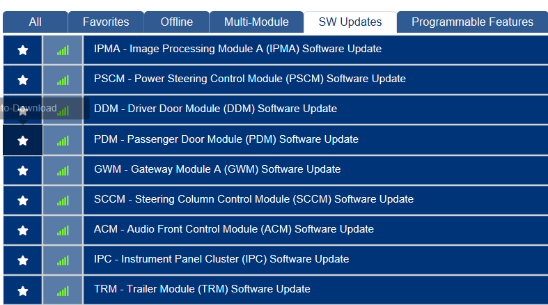

So what should you do if you ran IPMA and PSCM and everything seemed to run fine (after 5 hours) but haven’t cleared from FDRS? Don’t really want to do Network Scan/Test. Just drive it and check again later? Or is this something that will stay populated like the GSM module update in FDRS

Check for DTCs and clear them. If they don’t return, leave it alone and check again later to see if the updates are removed from FDRS. That’s all I’d do right now until more is known about these updates.
I don't show any DTC's and don't really want to run a scan with the VX Nano. However, the PSCM and the IPMA still show as available to Run like GSM. These still show when logging into FDRS without the VX Nano connected.
I'm not going to update it again. Just going to leave it alone and if things change in FDRS.
I’d stop and wait for more developments.

Almost sounds like FDRS let's you get to the equivalent of PowerUp 2.5.1, and you need to get to 2.5.2 for full BlueCruise functionality. Maybe in a few days it'll be available?

This is such a stupid rollout stagegy.
I tested mine and the BlueCruise On box showed up in the IPC, but not hands-free!
We still require the final update for GWM which is Power-Up 2.5.2 that must tell the cloud that we are authorized and activate the feature.
I agree, looks to me like what is available in FDRS today are the modules that updated with 2.5.1. I'm thinking of ignoring the DTC in the IMPA that cropped up - it relates to network communication with the GWM....and knowing a GWM update (should) show up in FDRS later.
