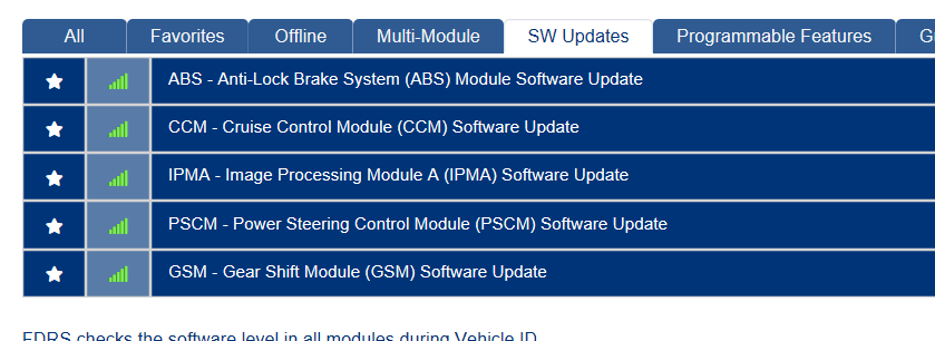

Now that I have my APIM unstuck, if anyone gets an opportunity can they please check and see what I now have available? I had GSM + ABS when I last finished.
Now that the weather is starting to warm back up and I got over 1.7.1 I'm looking to get back on that horse again. Still would like to see an OTA in the meantime but I'll likely splurge for a month of FRDS this time.
1FTFW1ED8MFA91029
I'd be happy to oblige, but currently sitting in the truck applying :
The IPMA has me handcuffed in the truck. It's a doozi. :)
Yeah I'm not exactly looking forward to the IPMA when I get there... How long have you been at with that module?
I'm guessing it's been a little over an hour watching it erase block by block. Says 82%
Or put another way, it's been 1232 windshield wiper sweeps. ?

So I finished… it all went successfully as far as I could tell. Ran network test on mongoose and the IPMA still says update along with the PSCM.
Instead I’m going to leave the truck off for 30 minutes, drive it. And see again later.
Ford F-150 ECU module programming guide using FDRS 7D86B612-EAC6-4E40-84B7-5ABD750F7253
So like 4-5 hours from start to finish?
