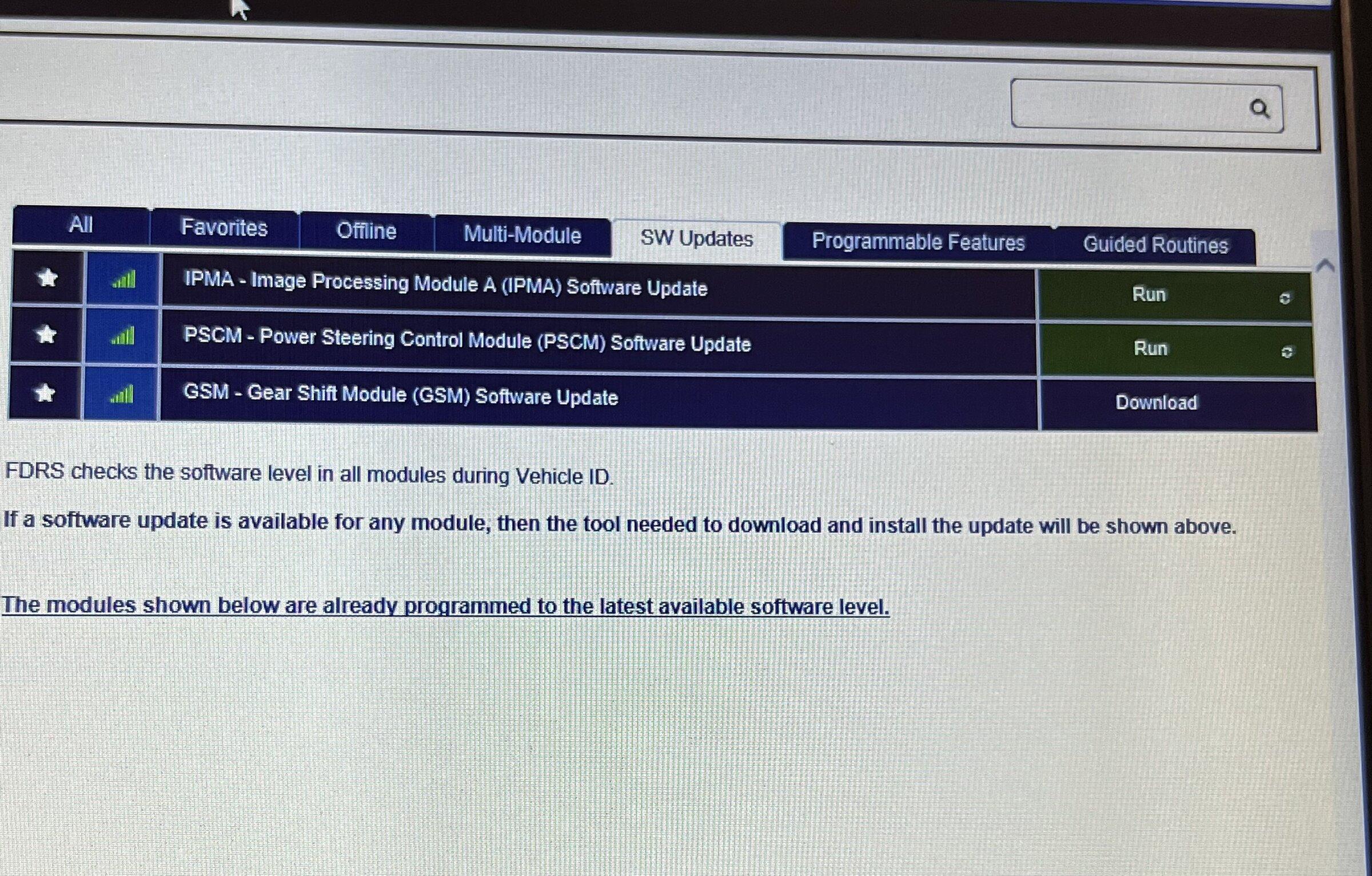

Yeah I’d go with 5 hours to be safe.
Drove the truck and came to scan it again.
Got an IPMA DTC so should I PMI it or run the update on IPMA like it’s asking?
No whatever you do don’t do that! That is a normal dtc clear it and that’s all it’s not a bad dtc
