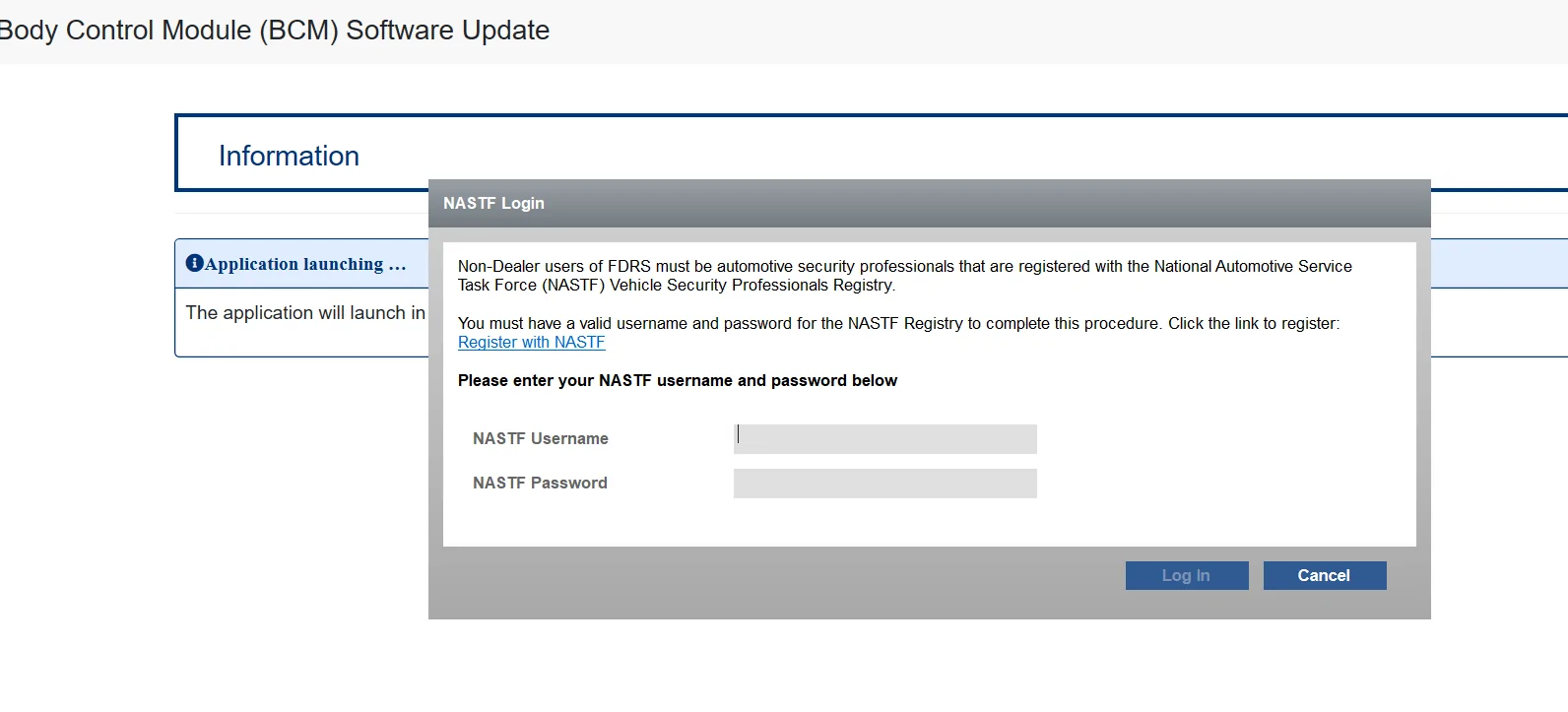

So I am trying to update BCM and when I click Run, I get the following message:
Ford F-150 ECU module programming guide using FDRS 1716039229552-zt
Why...?! How can I update BCM?
It is a known issue. BCM cannot be updated for the time being. Ford has to fix whatever it is that is causing that password requirement.
Is this something that can be updated OTA?
