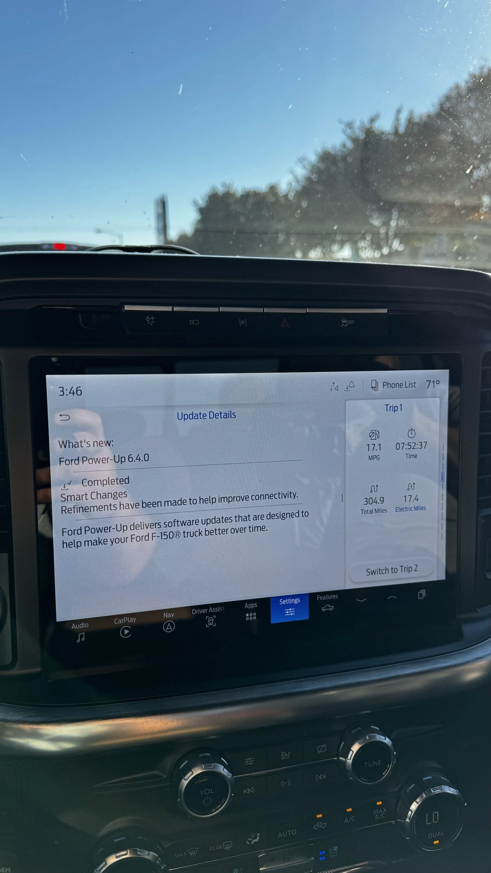

Why is this popping up after doing all my updates ? I should be on the equivalent of 6.8.
That will not reflect manually installed updates. Only OTA updates

Many people are seeing phantom install icons on their screens with the current round of 6 x.x ota's. When you push install now button, it's displaying the last completed ota.
