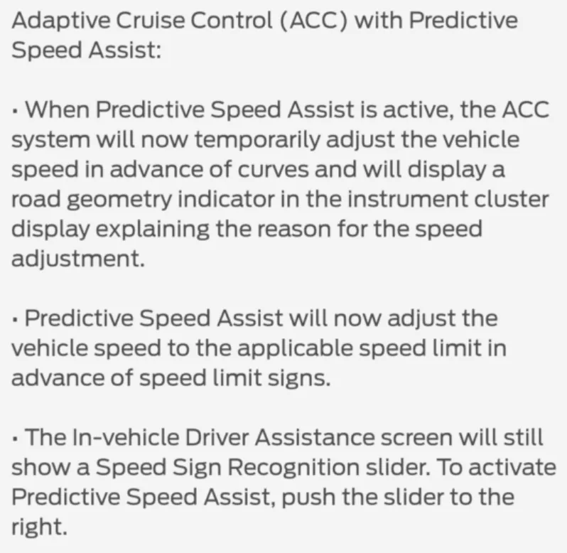

13x more engagement than Bluecruise 1.0. that means it only kicks out every 15 minutes now.
Wow! I was about to ask if those release notes were even real, but they sure are. Some of the most detailed ones I've seen, especially when you read all of them on the MME forum. Screw BC1.3 I guess, just skip straight to 1.4! Sounds like all the MME guys are equally surprised.
This is the turn speed assist Icon
Very cool! It will be nice to get the IPC and IPMA updates to better utilize it and know what PSA is doing, as right now its kinda a guessing game and does what it wants and you have no idea.
