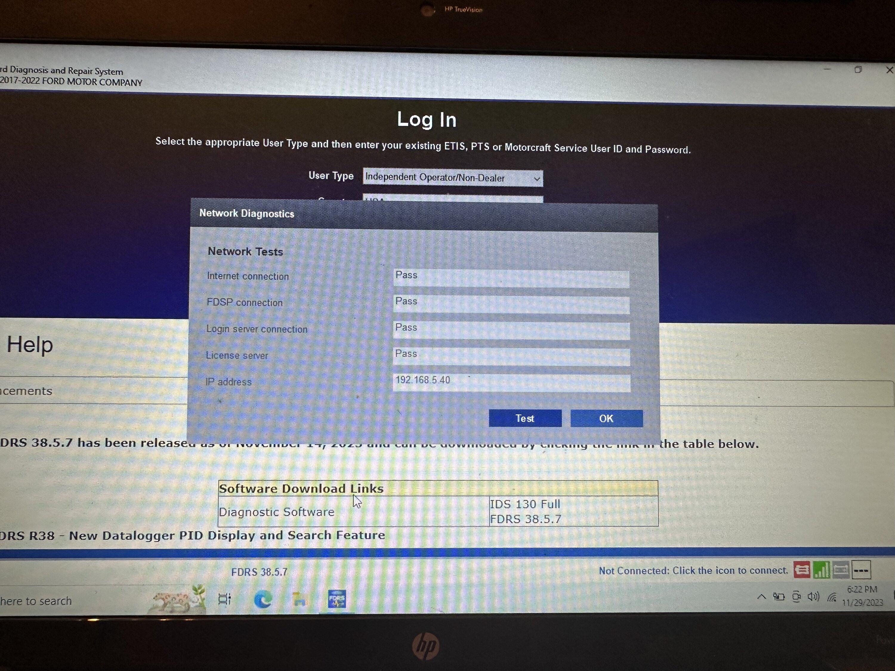

I’m past the activation section but now I’m not connected.
You’re using the wrong user type. Independent, not Non-Dealer ETIS. Also, make sure you‘re using a 37.X.X version of FDRS if it’s a Windows 11 machine.
I got a windows 10 machine from a family member.

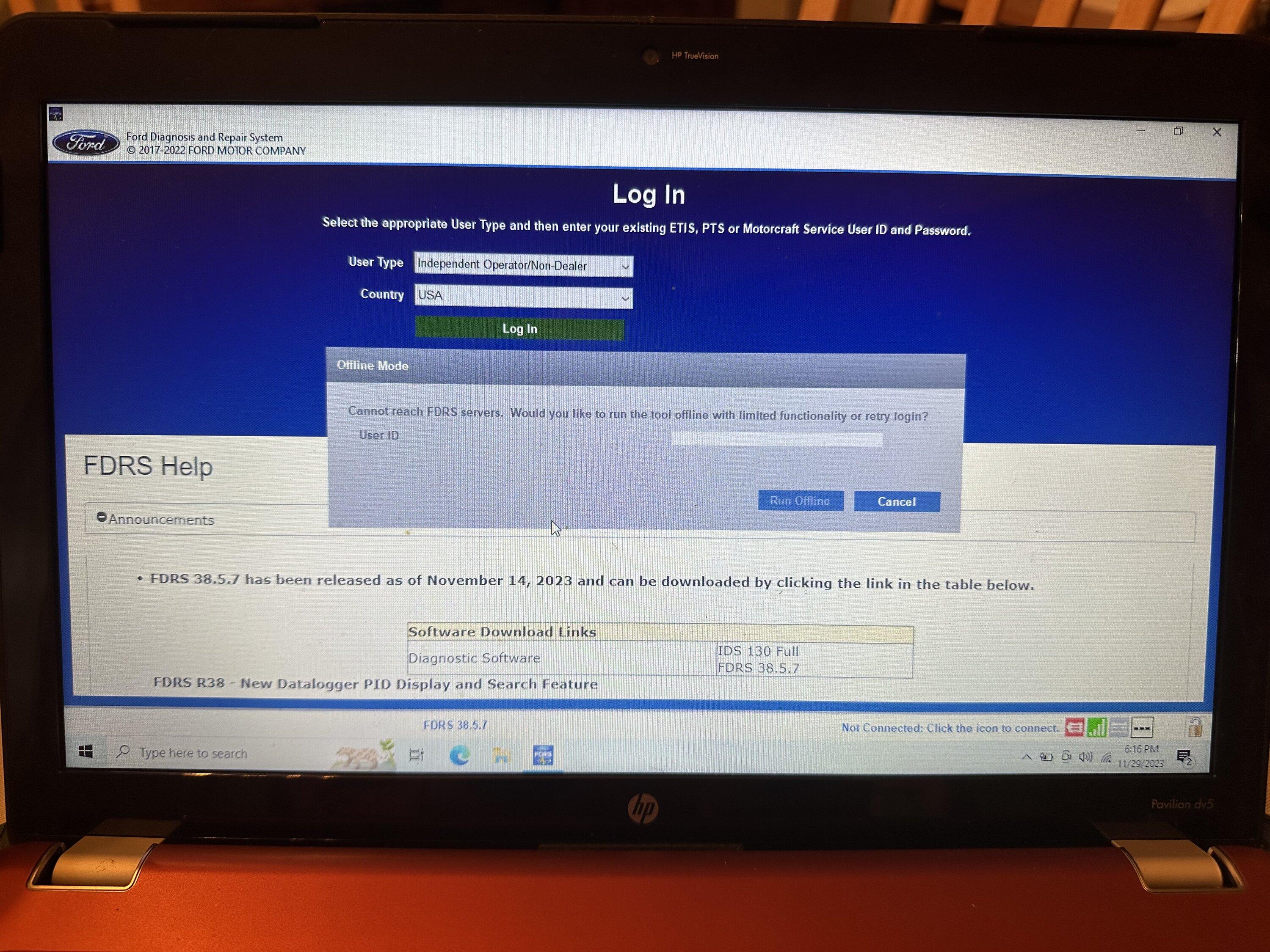

I’m really sticking out here.
Nothing looks out of order. Reboot the laptop and give it another shot. When you log in, it might take four or five seconds after inputting your credentials before it does anything. Just wait.
I uninstalled the 38 version and went with the 37 and I’m in! Wow you guys weren’t kidding when you said it’s finicky!

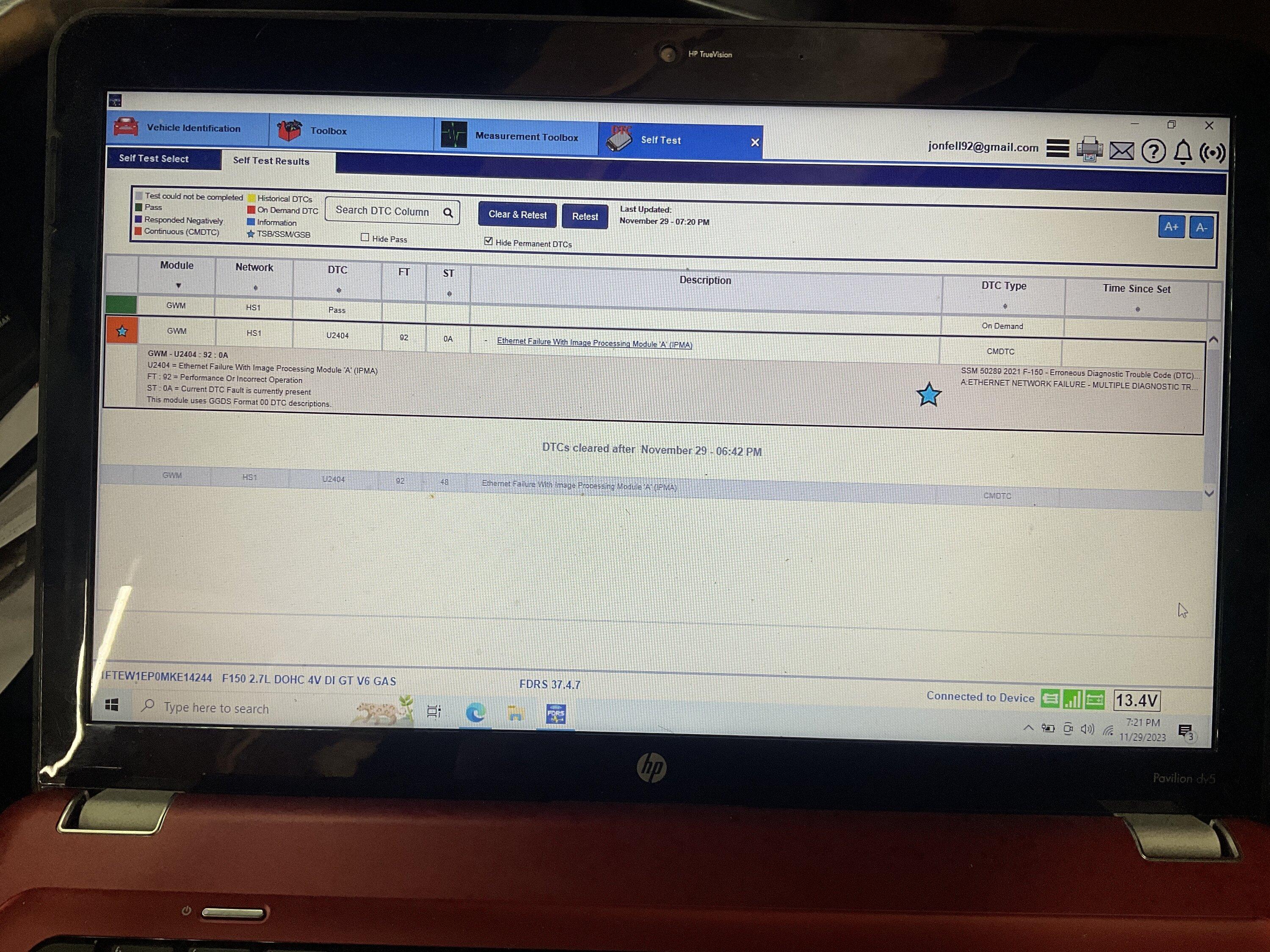

Any recommendations on which to do first? Or does anything look odd?
Ordinarily, I’d start with the GWM but it’s showing a DTC (orange). Right click on the orange box and run a self-test. See if you can clear it. Then run the tool.
Right clicking doesn’t do anything. Nothing pops up
