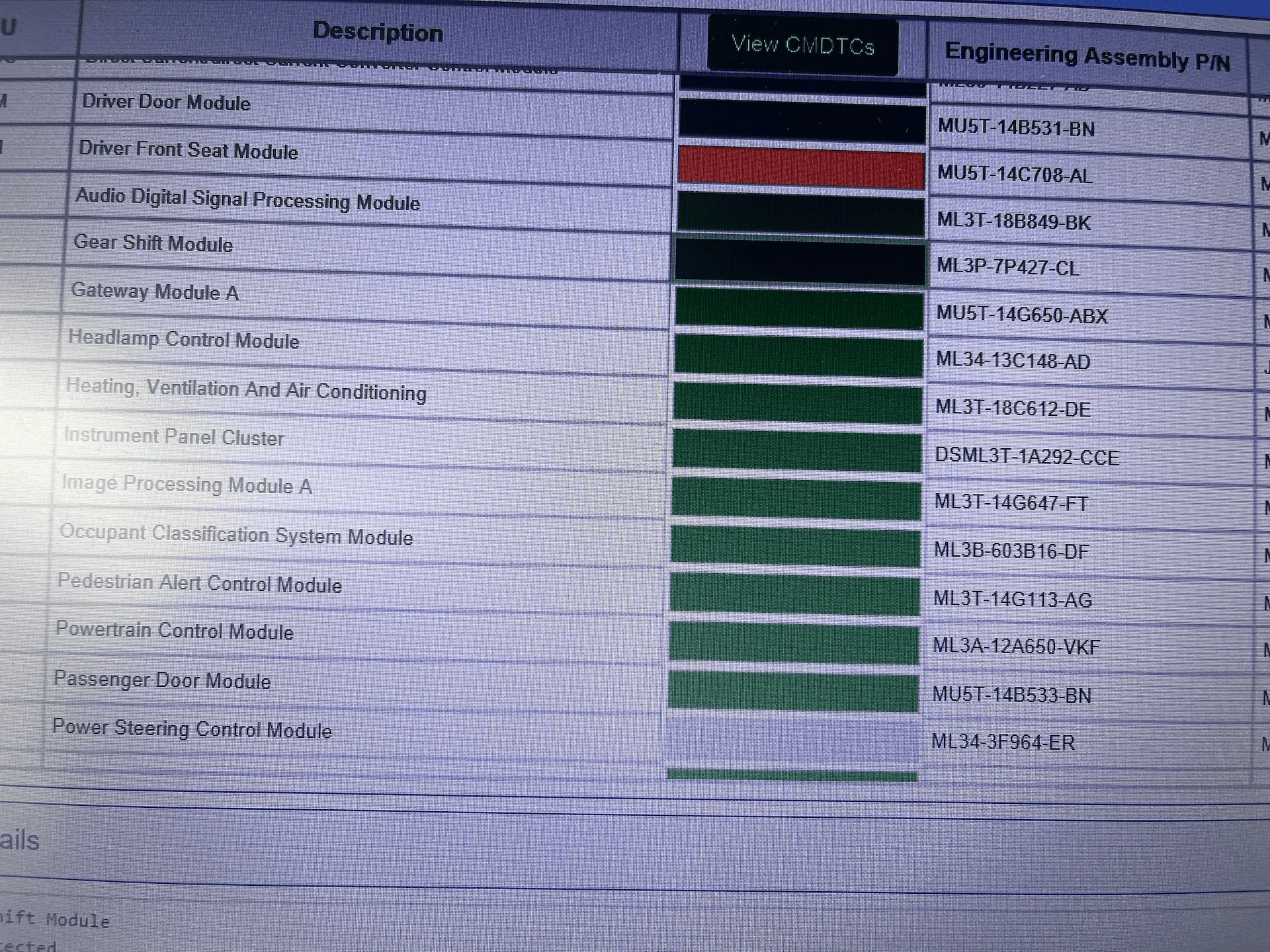

I had not had any updates since May, found that somehow updates were turned off, I updated with my mongoose yesterday, the 2 1/2 hour APIM also the PCM, TCU, as well as a few others, all went well, all od them showed passed.
I have a question on a couple of things in the picture below, I think the DTC on the Driver Front Seat Module has been there since last year, it was a known problem that wouldn't clear if i remember correctly.
second is the Power Steering Control Module showed grey yesterday "not responding," and now shows orange DTC how do I clear it??
I haven't used my mongoose since last year and don't remember if I just run PMI, aren't there a couple of questions to answer while running the PMI like"is this module original" or something like that?

No PMI needed to clear and orange module. Just clear the codes and do a self test on it.

Be sure you have key/button on when doing the network scan/test. Made that mistake first time and not everything is awake with ignition off.
Usually clear and retest everything should show green after that.

When you click self test it will ask you.
Thank you!!! I remembered once I started, PSCM DTC cleared but the Driver Front Seat module did not.
I saw that the seat module logged a U2100 code so I ran a PMI and it cleared as well
Thank you for the help

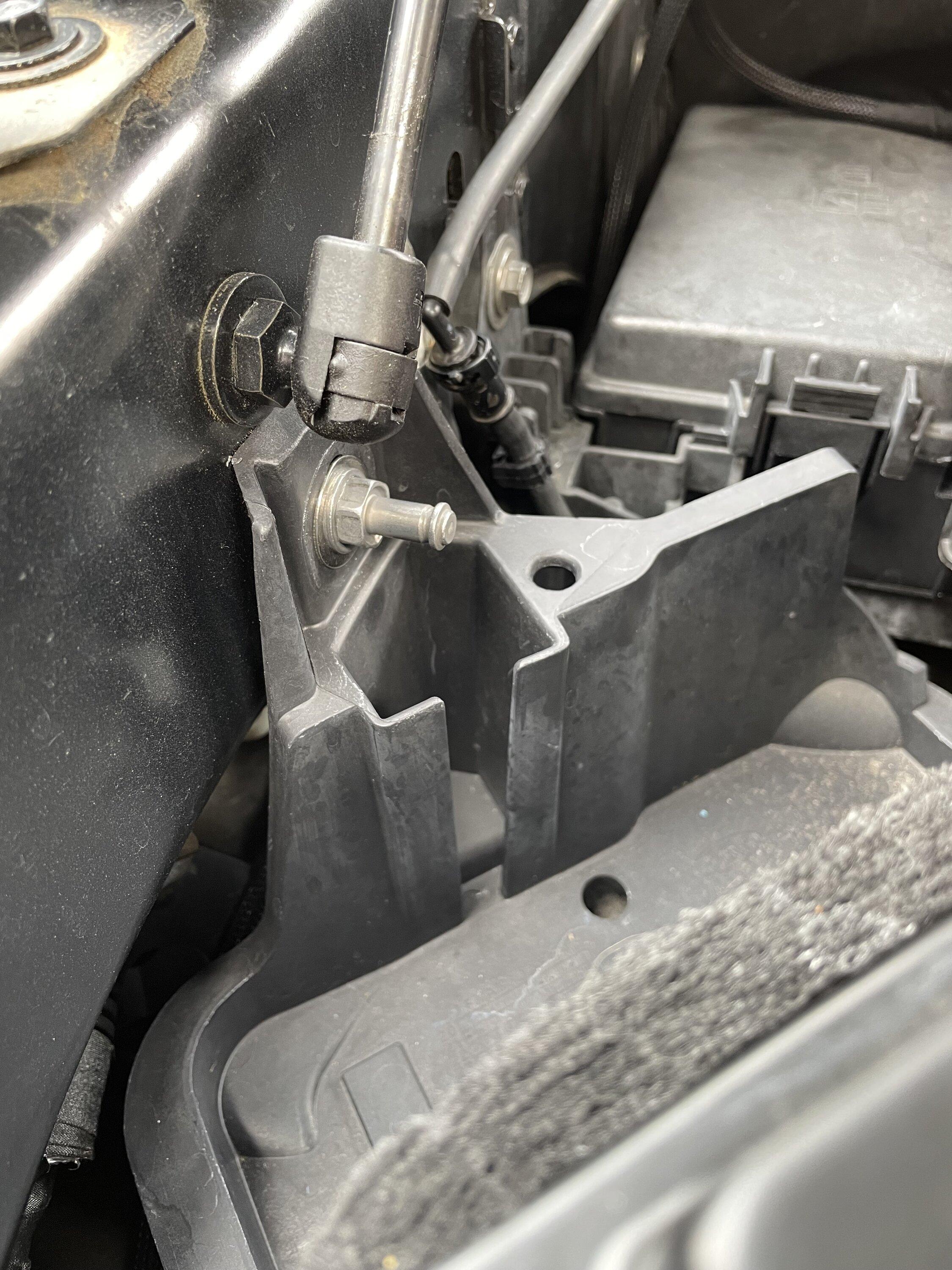

So we just got an addition to the family besides my 2021 F150 Rocky Ridge. My wife got a 2023 Mach-E GT Performance Edition. While I was eager to get the Mach-E all up to date with FDRS. I notice a really cool peg post they use for negative grounding and jumping.
I bought a pack and put one on my F150 and now have a great grounding peg for the power supply when doing updates.
Info is below if anyone else is interested.
