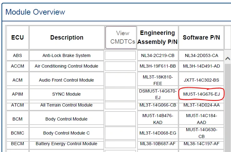

I have a question regarding the "Avoid Network Scan" routine in FDRS.....
I noticed that the FIRST download from the mothership presented the download progress bar and it visible represented a steady progression until complete.
All subsequent requests to download the same data behaved as if it was cached and FDRS didn't actually get a fresh reading. Or put another way, the progress bar would begin to show a little progress (probably the establishing of handshake and request) and then all at once rapidly progress to 100%.
If I choose a new vehicle with a new VIN, the same experience..... First download is all fresh (of course because it would have to be) but all subsequent requests appear to be rapid and I suspect some kind of caching is leveraged.
Is there anything we can do with FDRS to clear it of any history of a specific VIN that would force it to behave like it's never looked that VIN up previously?
I dug around in the local file directories and the VIN has footprints in a lot of places. I was hoping one of you gurus already figured out what is what?
Thanks regardless!

But I tried that first because it just made sense. But amazingly, when you enter the VIN , it appears that the moment FDRS handshakes with the server, they both agree that there's something on the local harddrive already so no reason to download the whole dataset.
The real reason I want to know how to do this is because my sweet Sync update to the LATEST build rendered a very comforting piece of information when I first saw it:
(Note the NO-Scan greyscale of the View CMDTCs column)
Ford F-150 ECU module programming guide using FDRS apimvalu
However, as excited as I was to see ALL modules listed without erroneous spaces in the P/N's, my very next No-Scan request for information was one of those FAST "cached" feeling downloads and the APIM data was then different:

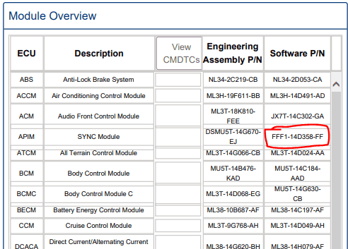

WAIT A MINUTE........while preparing this post and doing a new FDRS NO-Scan download to show the abbreviated "ML3T" value for the APIM software P/N, I JUST NOW got an unexpected different result!
I SWEAR that yesterday and last night that other than the first pic above, the APIM P/N was gimped to "ML3T". But just now it has the value you see above as FFF1-14D358-FF
Also note that it is even more surprising that it is a different value now because of exactly what I was mentioning about the "cached" feeling about the download. This download was one of those kind.......The progress bar barely had a tiny blue moment and then without any hesitation it went to 100%. Yet obviously, it rendered new results!
So nevermind on my assumption that the NO-Scan multiple downloads are NOT full comparisons every time.
I'm kinda relieved but now even more confused. LOL
I have no idea what that new value even means for the APIM.
I do know the truck is now the latest version of Sync and I don't see anything that appears to be a problem.

Snakebitten, my APIM also shows the same version as yours. I think this is correct for the sync 21281 rev 244
FFF1-14D358-FF
FFF1-14D358-FF
Thanks Sparky!
But I'm no longer 21281 ?????
I'm in the latest and greatest cool cats club
(that'd be a $900 FDRS co$ver charge)

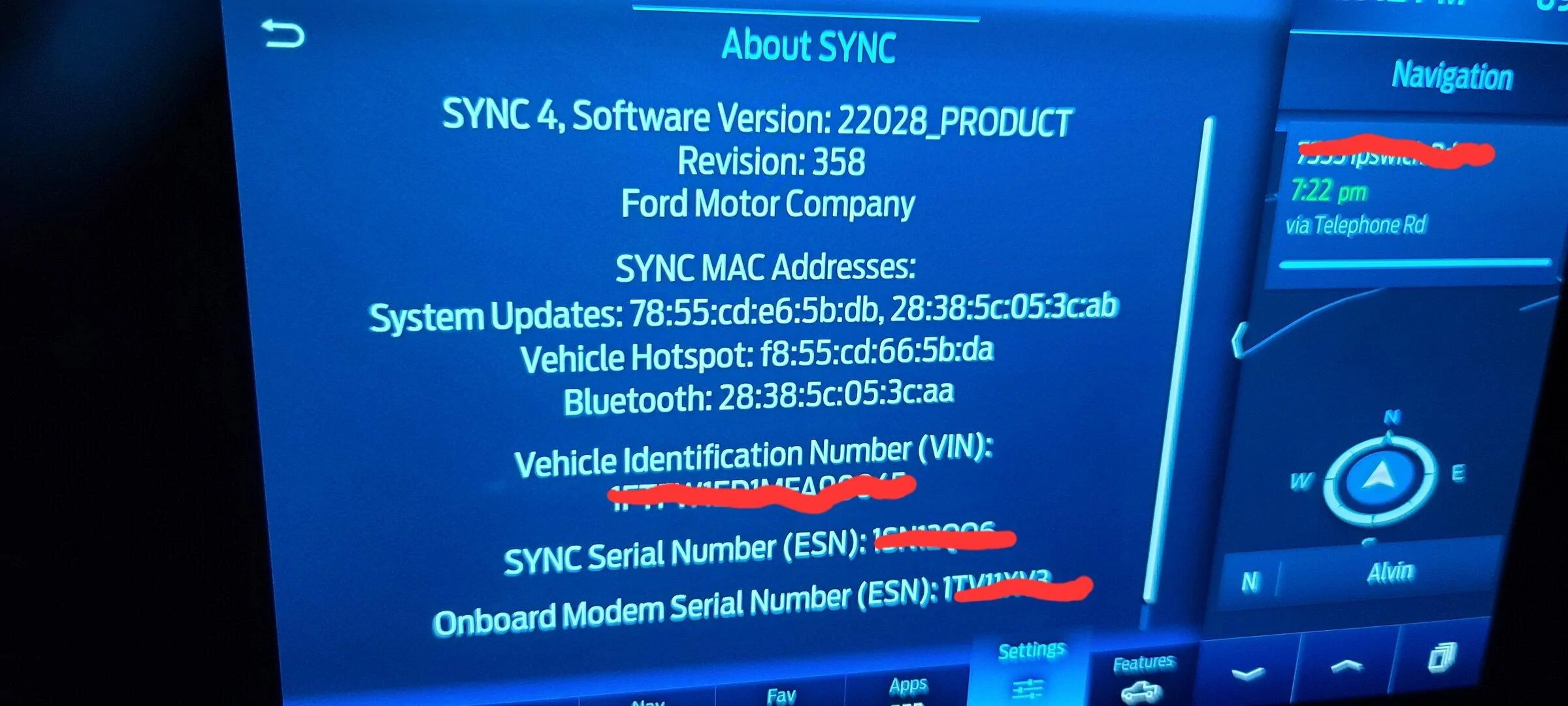

We’ll that’s weird… I show the same in FDRS but still 21281 Rev244 on the sync screen???
Disregard…. I guess it changed over the last week since I grabbed the original screenshot

Think about this: There's a Ford server in the invisible cloud. There's a Ford truck in my yard.
Now the truck CAN actually communicate DIRECTLY with the server in the cloud. Ford designed it to and actually intends it to.
Because THAT isn't working the way it should, we grab a laptop with a software program and deliberately insert ourselves as a middle man. :)
So as the middle man, I ask the server "hey, you got a package for the truck?"
It responds to me (middle man) "As a matter of fact I do. Here, can you deliver this FOR me. I admit I'm having difficulty doing it myself"
So I do. Package delivered successfully!
I even notify the server with a legitimate receipt signed by the truck! The server confirms it received the receipt by showing the middle man the P/N
MU5T-14G676-EJ
A few minutes later, the middle man asks for another copy of the P/N and the server says "no problem, here ya go :
Ml-13T
What? That's not what you said 5 minutes ago? Lol
The next day I, the middle man, call the server to ask again," hey, I just wanna make sure you sent me the right copy of the receipt yesterday. Can you send it one more time?"
Server says sure, here ya go:
FFF1-14D358-FF
So seriously, at least as seriously as I can muster, WTH? Whatever is editing data on the server it can't just be what the middle man is providing to the server. Either the server has instructions to do things independently, or the truck IS corresponding with the server and talking behind the middle man's back. Just to mess with him? ?
