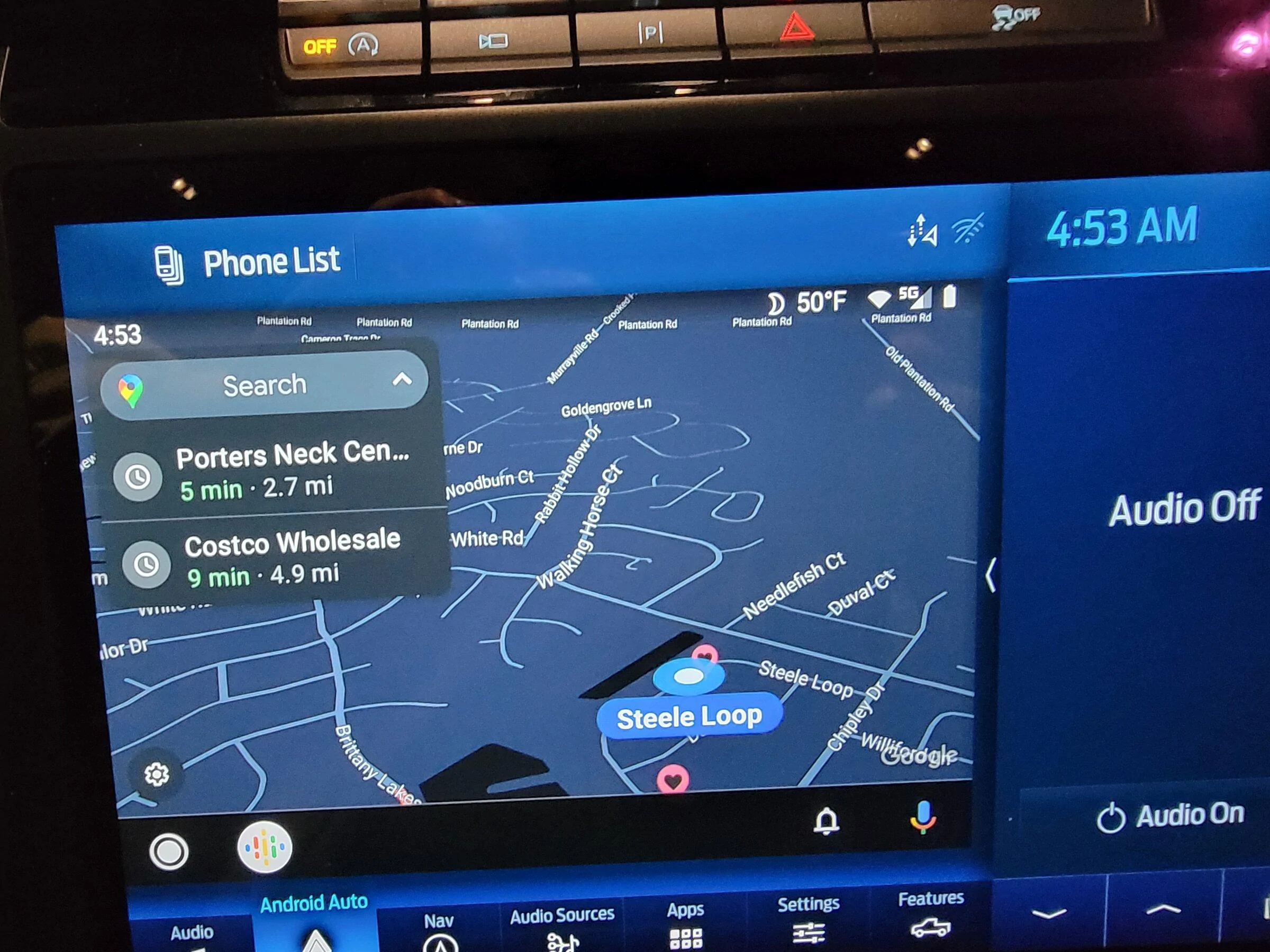

Any noticeable changes in Sync ? Did they fix the ACC SSR ? How is CarPlay screen look like ? I had a full list of bugs reported to them.
Ok, there are changes but, unfortunately the ACC SSR is still the same. No border around the Android Auto and phone details and weather are in the upper right corner of Google Maps.
