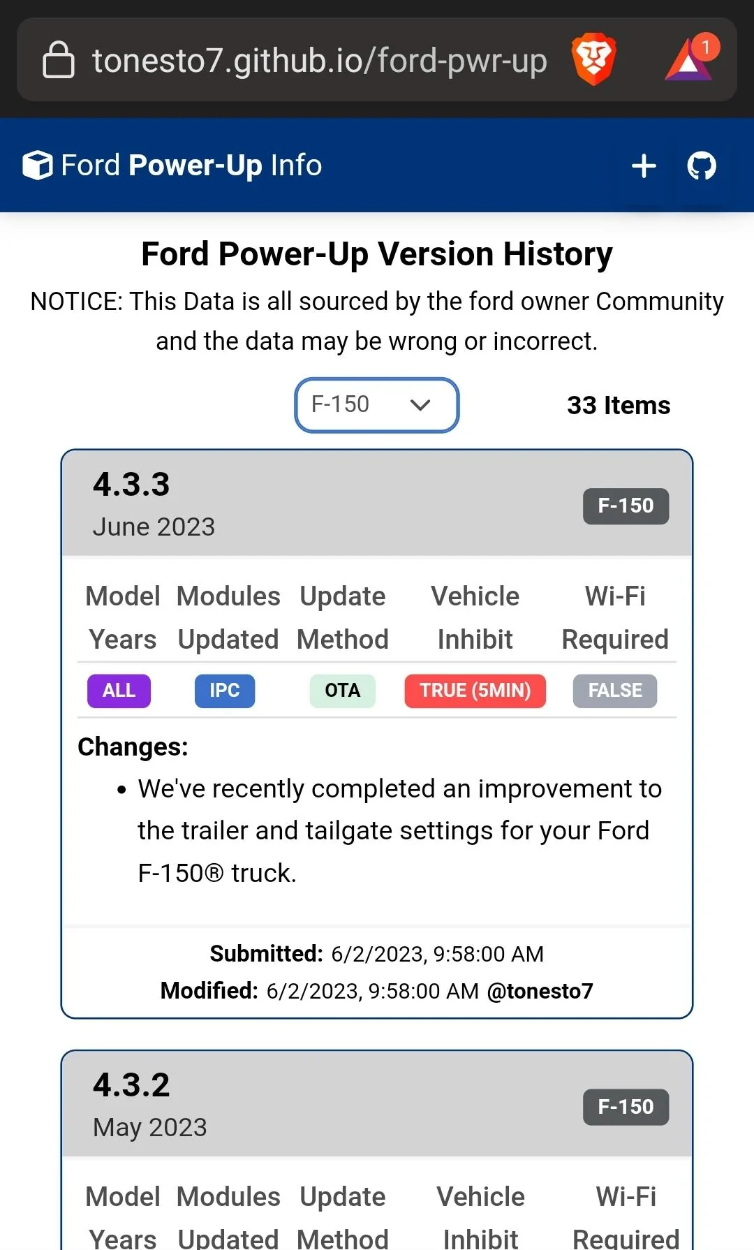

What's the latest OTA version currently being sent out for 2021 F150
m_bt54
Bryan
Nov 16, 2022
1,050
1,066
Massachusetts
IT Director
4.3.3
