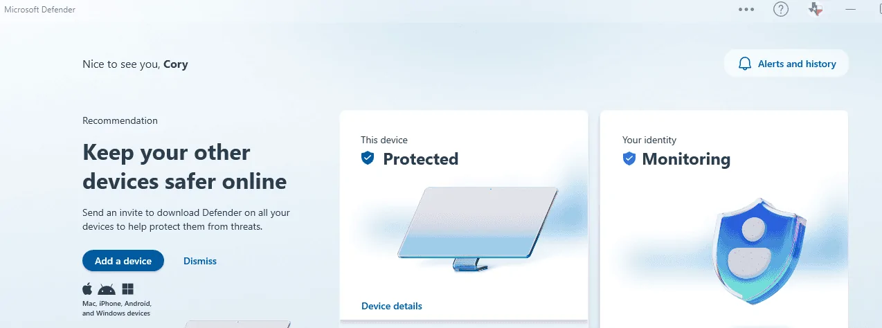

Now that you say it, a couple weeks ago Windows installed this new Microsoft Defender:
I'll disable it tomorrow and see if that changes anything.
