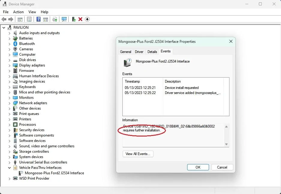

I followed the installation instructions for the drivers. The Mongoose install app downloaded an update and installed. Then I did the three tests that Bob Mac outlines in his walkthrough, Install Check, Vehicle Check, and Device Check and all three populated as he has pictured.
I noticed when I unplugged the adapter from the laptop it makes the "unknown device dismount" sound, not the normal disconnected device sound. Same for when I plug it in, it makes the unknown device sound as opposed to the device mounted sound. Device Manager also shows that the device requires further installation.
Has anyone else noticed this as well? Is this normal for this set up?
If it passed the tests as in the Bob_mac document you should be ok.
