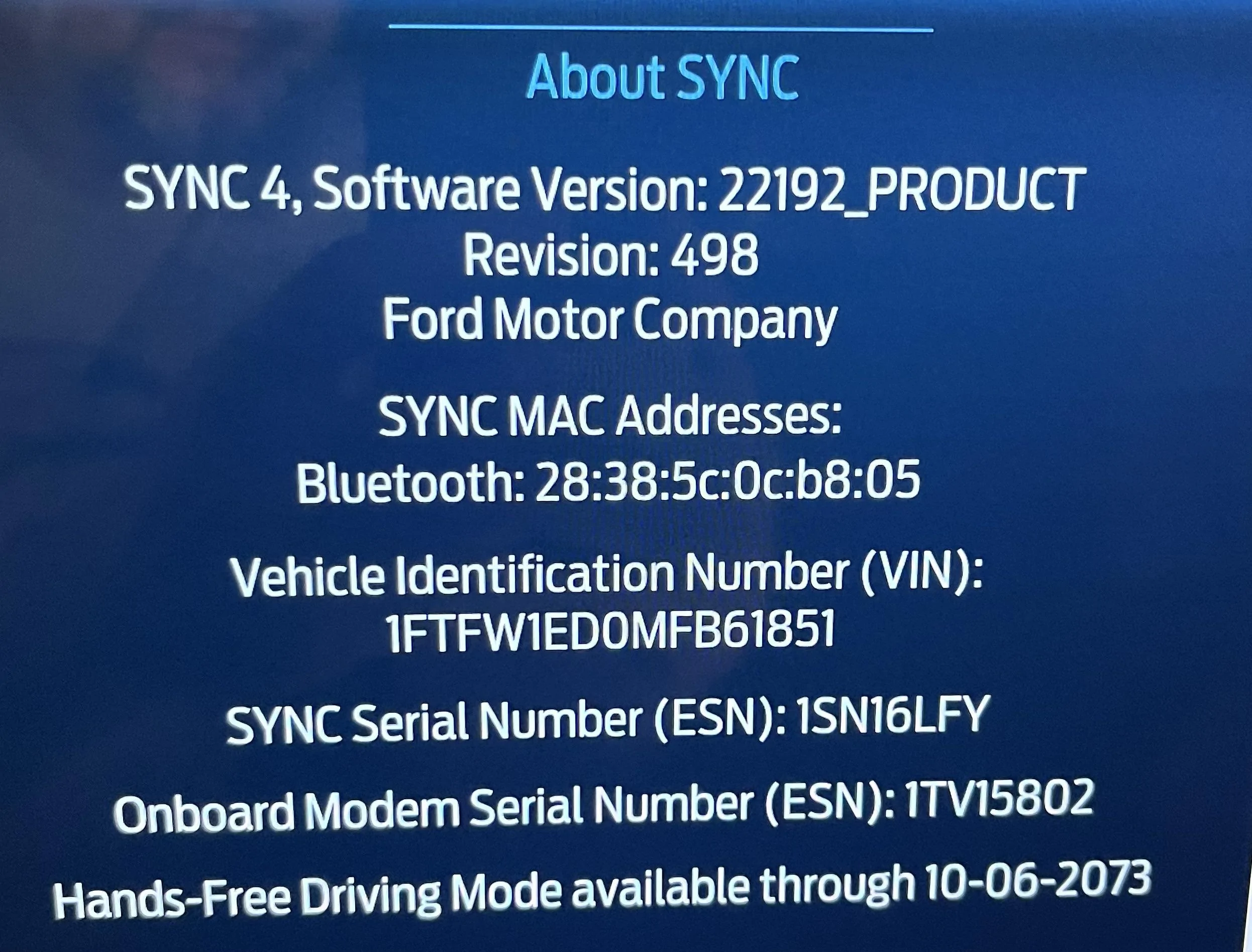

After two FDRS licenses, a new battery charger, two broken bolts and many, many hours, I was finally able to get by '21 upgraded to the point where I have Blue Cruise and full screen Car Play ?
Here is my SYNC version now. I have no idea how it translates to the Power-Up versions ?
Ford F-150 ECU module programming guide using FDRS IMG_2462
Many thanks to everyone on here. I couldn't have done it without all the help. An especially big thanks to @Jesse-Infotainment!
BTW, I had an IPC update, which was the first update that required a USB drive, and the truck just would not read the USB drive. At @Jesse-Infotainment recommendation I went the alternate canbus route to finish the IPC update. I started it right before going to bed and it was done when I woke up in the morning. I think it took 5-6 hours. After that any update requiring the USB drive worked perfectly.
And now you have a TCU update available.
Thanks for the heads up! I knew there were more updates when I quit, but didn't look closely. I think I might have another APIM update too. At this point I got the features that I really wanted, so I'll probably wait before shelling out another $50. Please let me know if you think that is a bad idea (e.g. the TCU update is critical). Thanks!
You do. The APIM will get you to sync 22293 and full screen capability (OTA 3.5.3) and the TCU update will give you dual phone connectivity (OTA 3.5.4)
