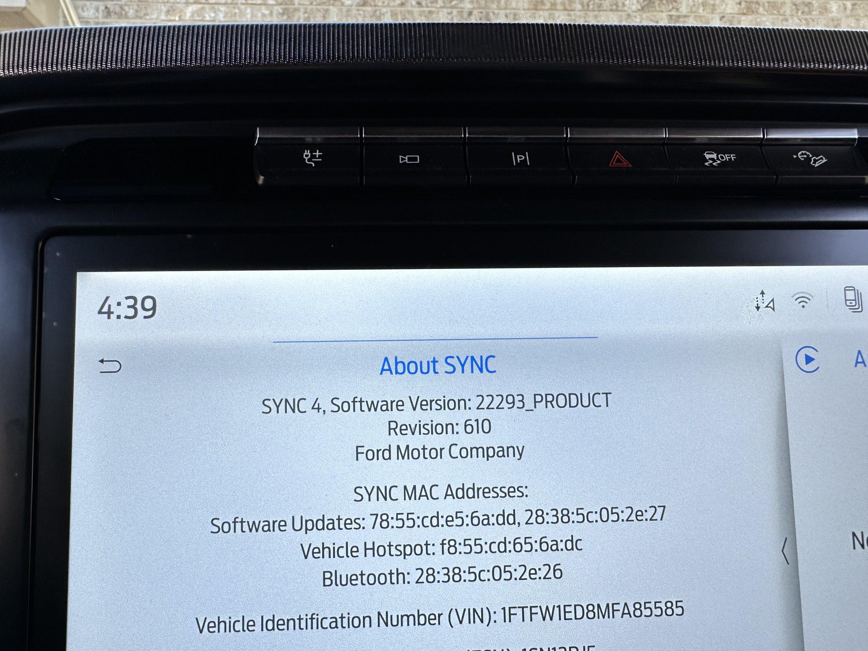

Not sure what update did it but it seems to shift gears so much better than before.
Ford F-150 ECU module programming guide using FDRS IMG_2186
this is where I'm at after a few updates
