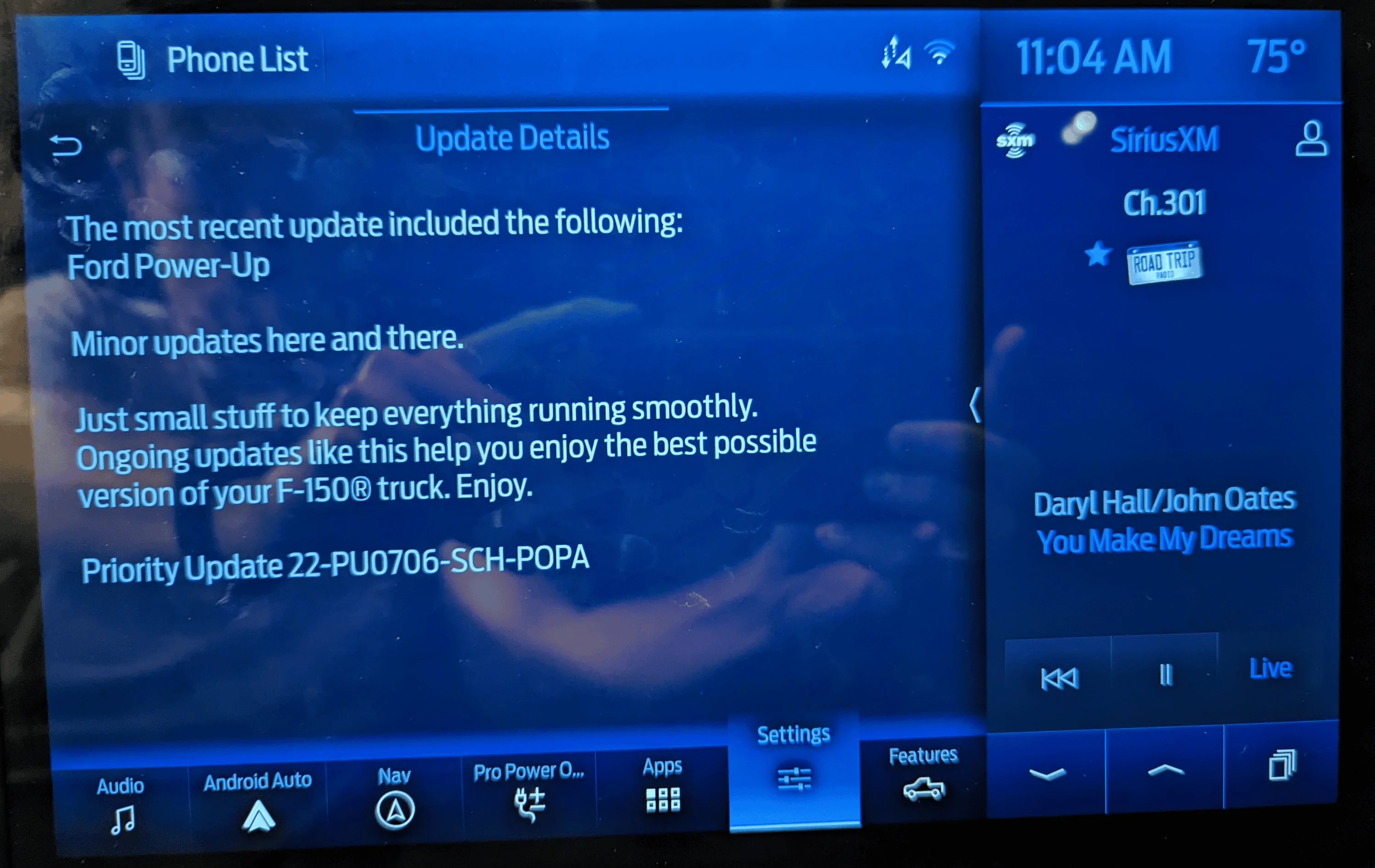

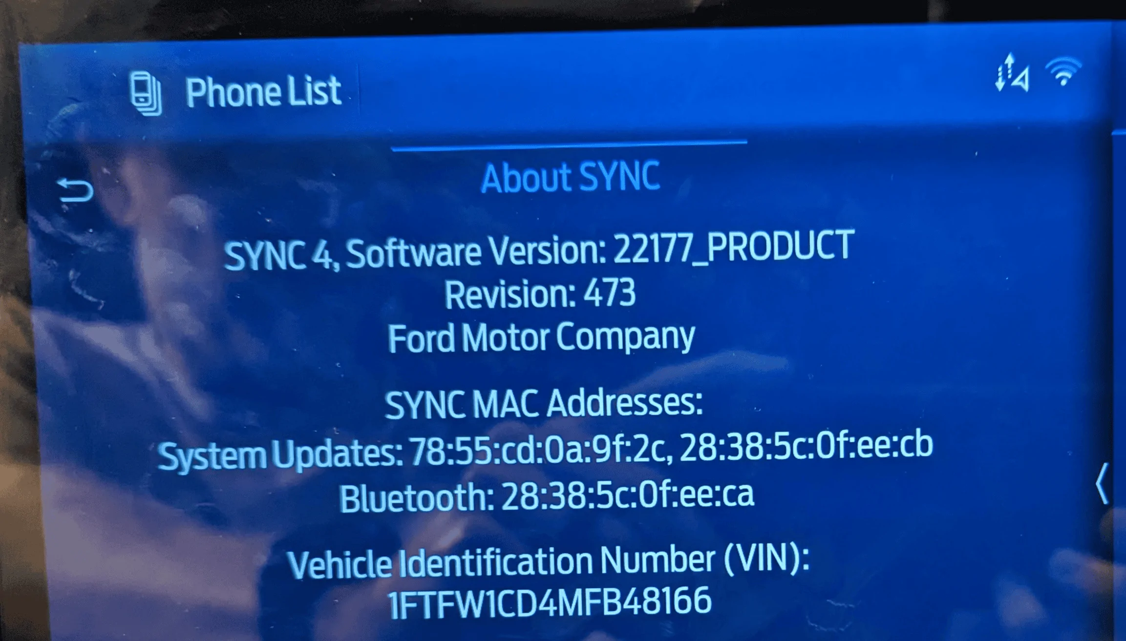

My 21 Job1 XLT PB 302A was in the dealership back in August 22 to resolve some of my issues including OTA's. I received 2 updates within 3 weeks of the visit (September) but nothing since.
1. Are my OTA's broke again?
2. Is there an update that fixes the ability for the trucks to use the stickers with Pro Trailer Backup Assist?
I am still unable to add a trailer - it doesn't seem to search or detect stickers.
