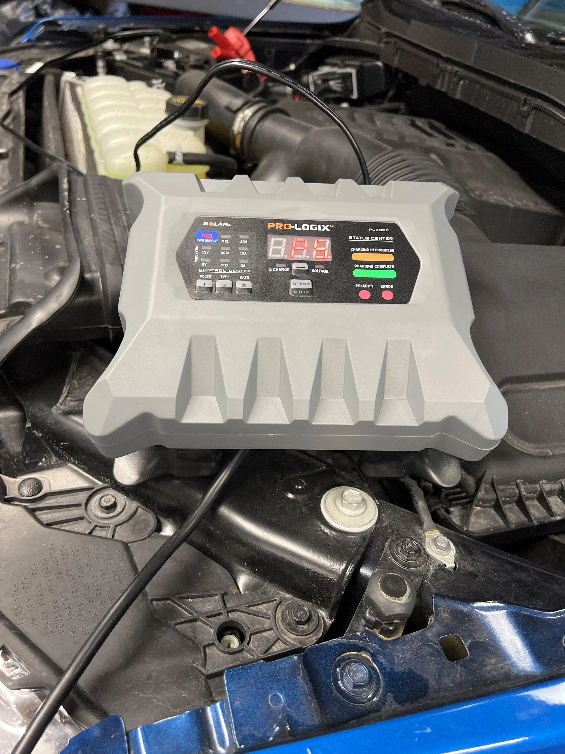

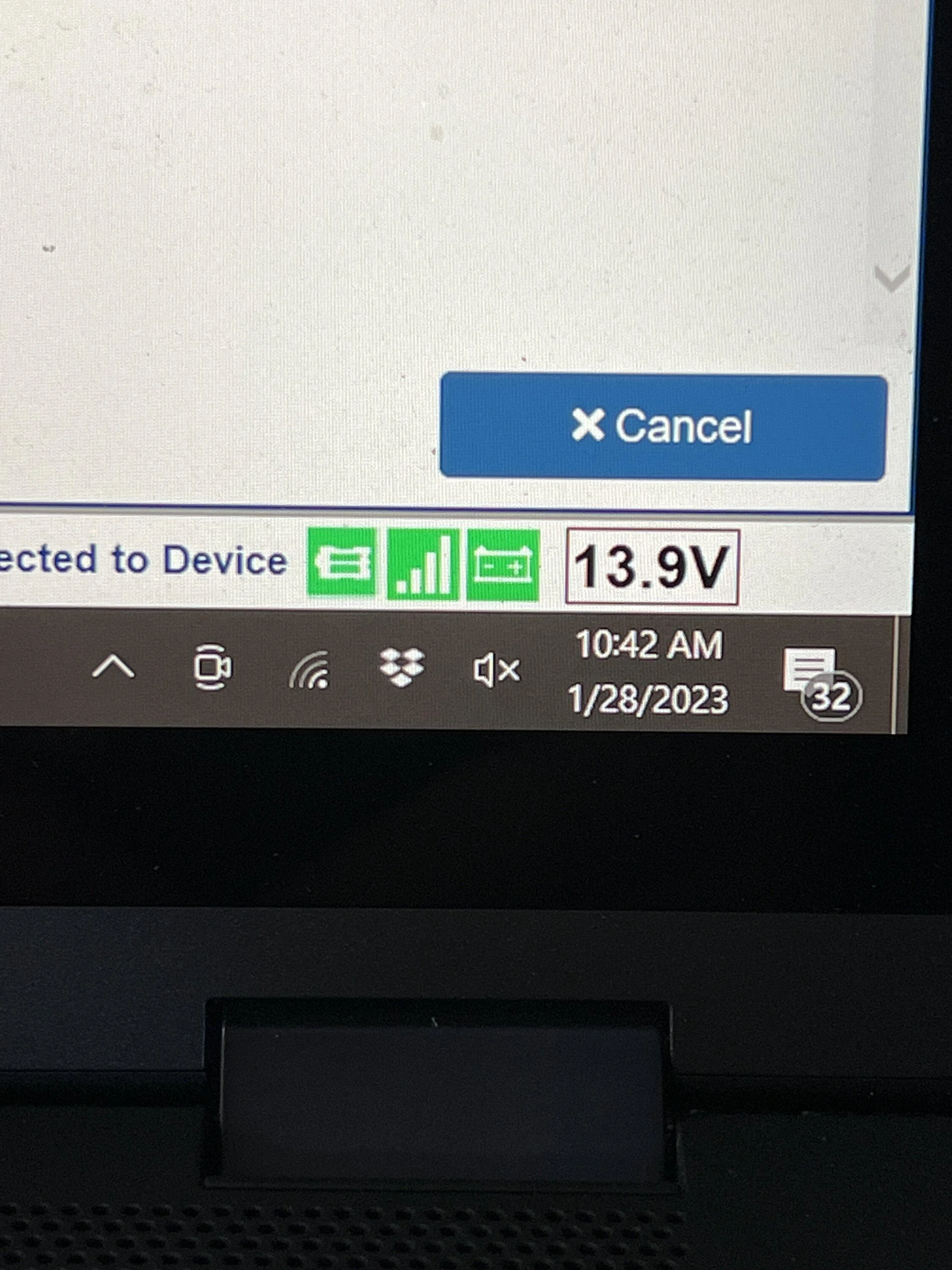

Pay attention to the battery voltage! The IPMA is a long one and you don't want it failing due to a low voltage...
Good tip, so far this thing is doing ok.

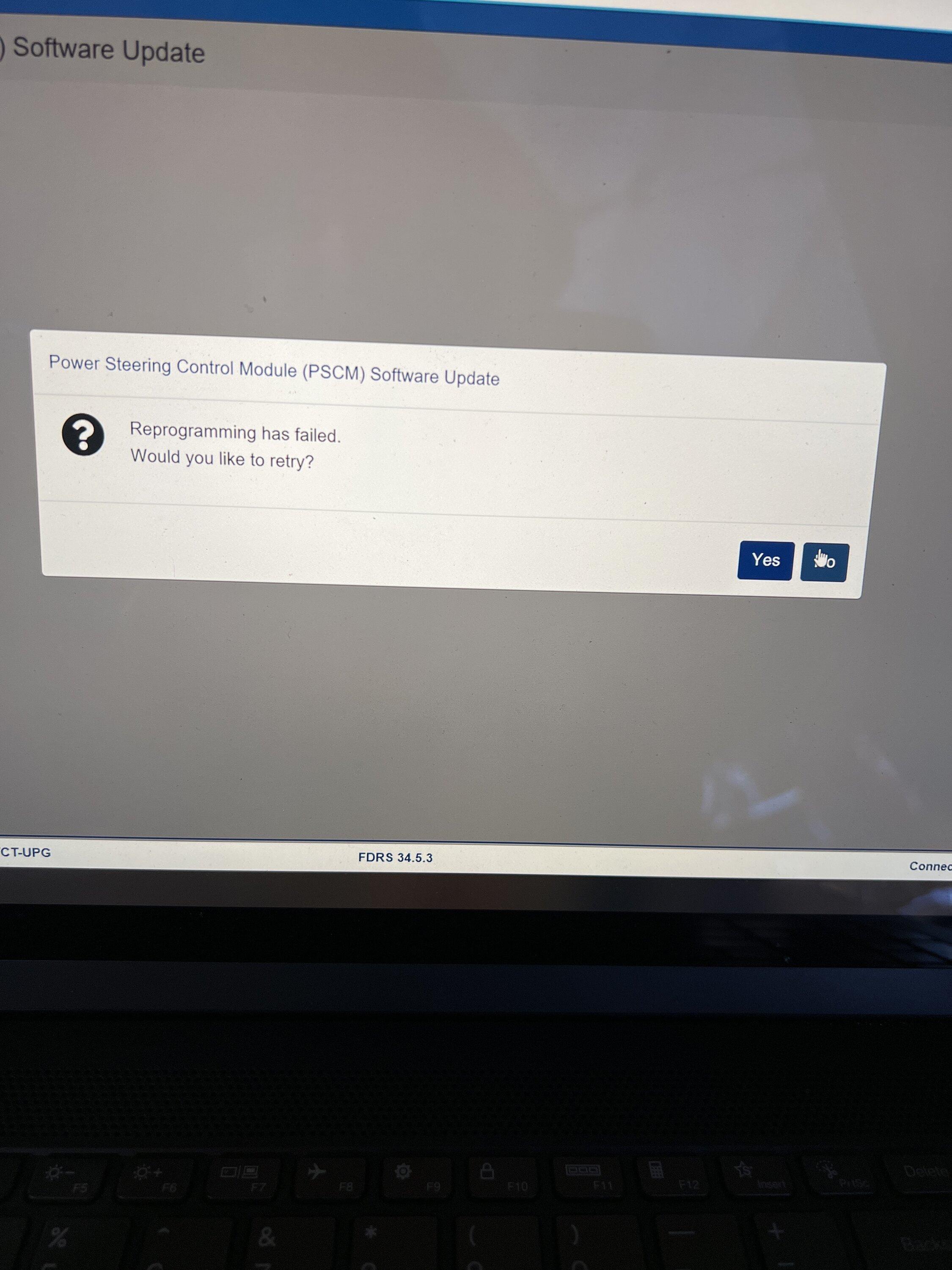

What do y’all do if it says reconfiguration of module unsuccessful? My ipma just finished but said reprogramming failed. Pscm just did the same thing.
Ford F-150 ECU module programming guide using FDRS image

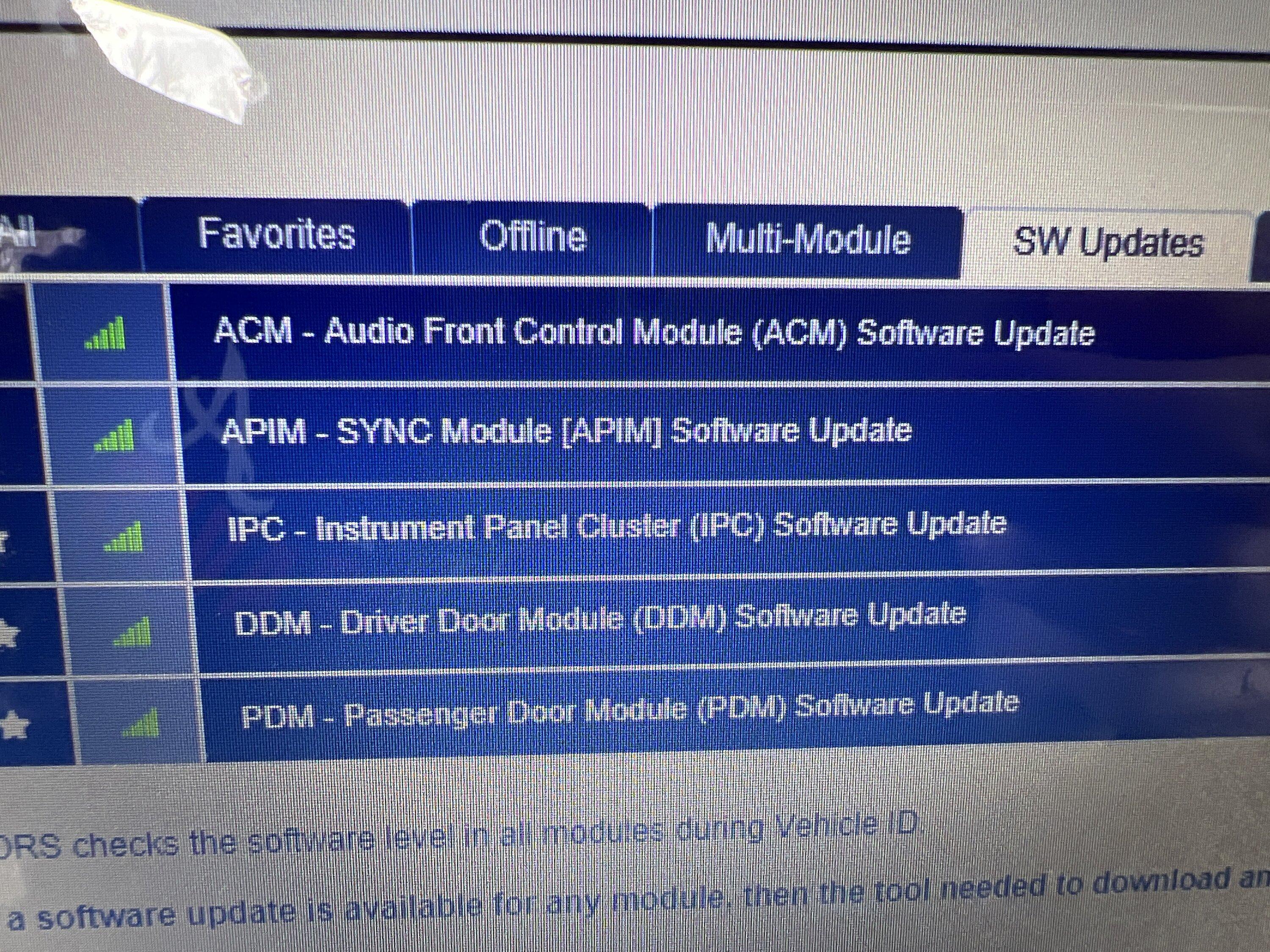

I got the IPMA completed along with ABS and some others. This on an Oct 2020 build where the Sync version is blank and system updates can’t be configured. This is what it is showing right now. Any specific order I should follow to update?
