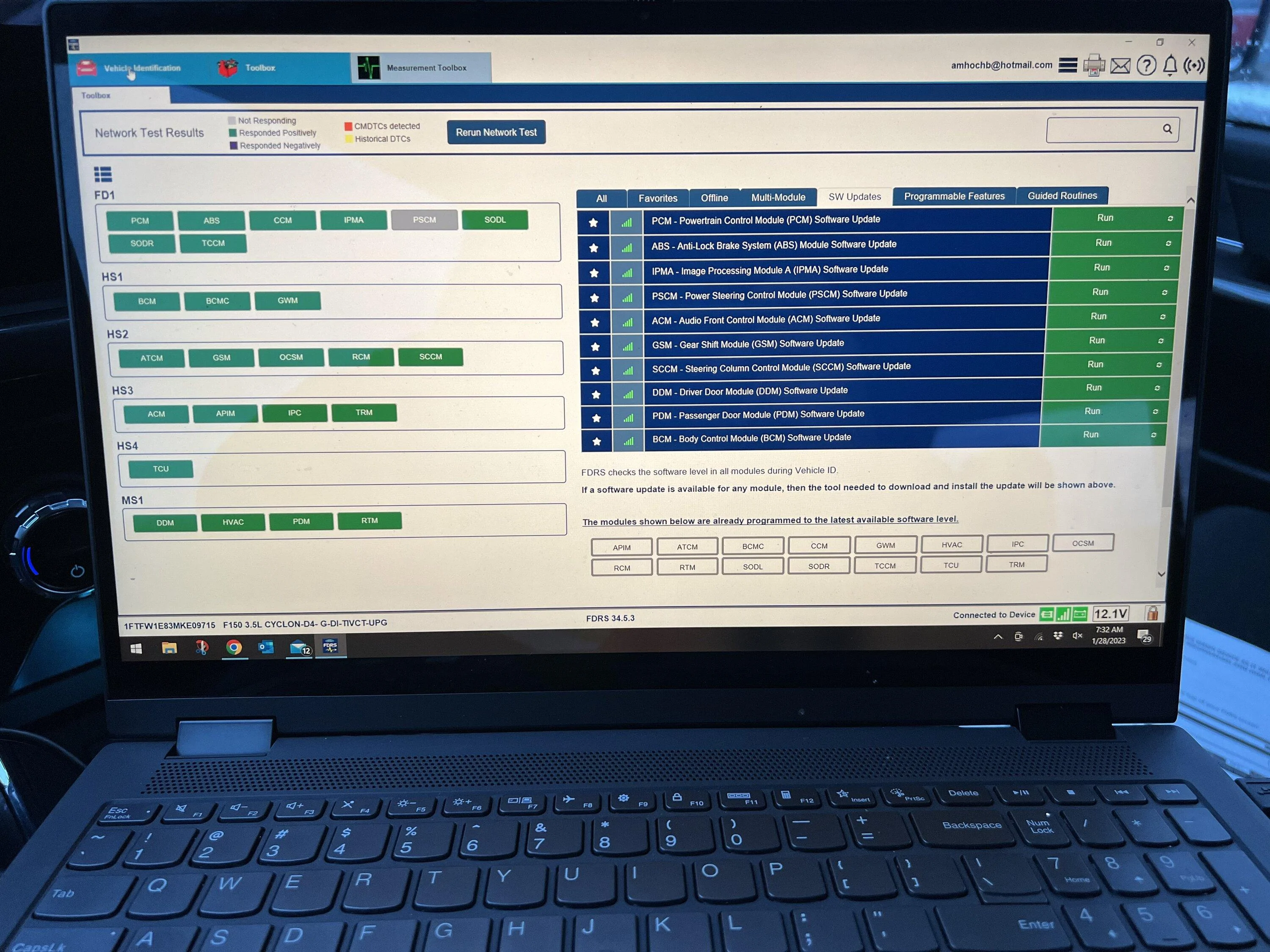

As we speak, Im downloading 5gb of APIM data to my USB. I know Im making progress, but Ive been through probably 10 APIM and Gateway module updates so far. I started with my software at 2.1.1 so I had a long way to go, but I can see daylight. It might be literal daylight lol.

wow that’s worse than mine! I started yesterday late afternoon and ran into some APIM issues so I had to reinstall FDRS and reformat my USB. Im not saying this is correct, but it solved my problem in that my updates seem to be progressing well right now. I really want to get this shit done tonight instead of wasting tomorrow.

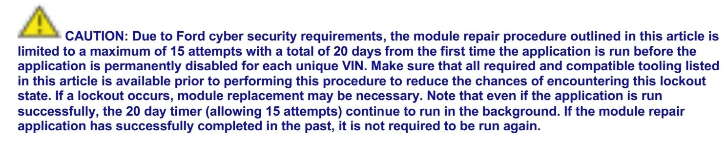

Alright, finally got the flash drive in and the truck recognized it but did not initiate any updates. I waited about 15 minutes. I'm downloading the update to a new flash drive now, but does anyone know the work around for when the update doesn't automatically start when the USB is in?
Burner
Andrew
Nov 19, 2022
Jacksonville, FL
2021 F-150
Navy
Nevermind, I started the module update repair utility just to discover the dealer already locked out my vin by running it unsuccessfully back in December. I've got an APIM on backorder so I think I'm stuck until it gets replaced. At least I'll get a good battery charge out of all of this
Does the VIN lock timeout eventually? I don't think it's permanent, is it?

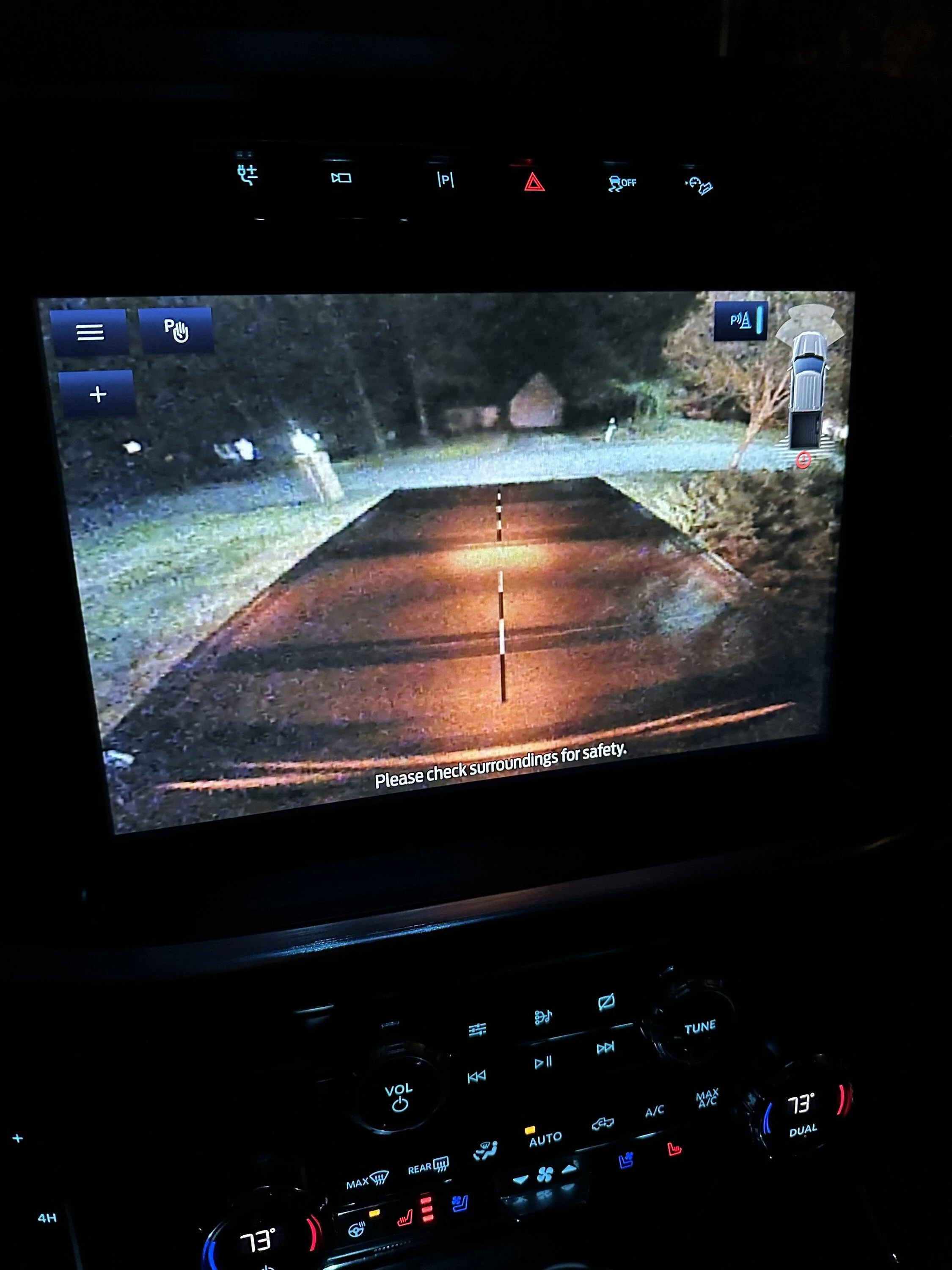

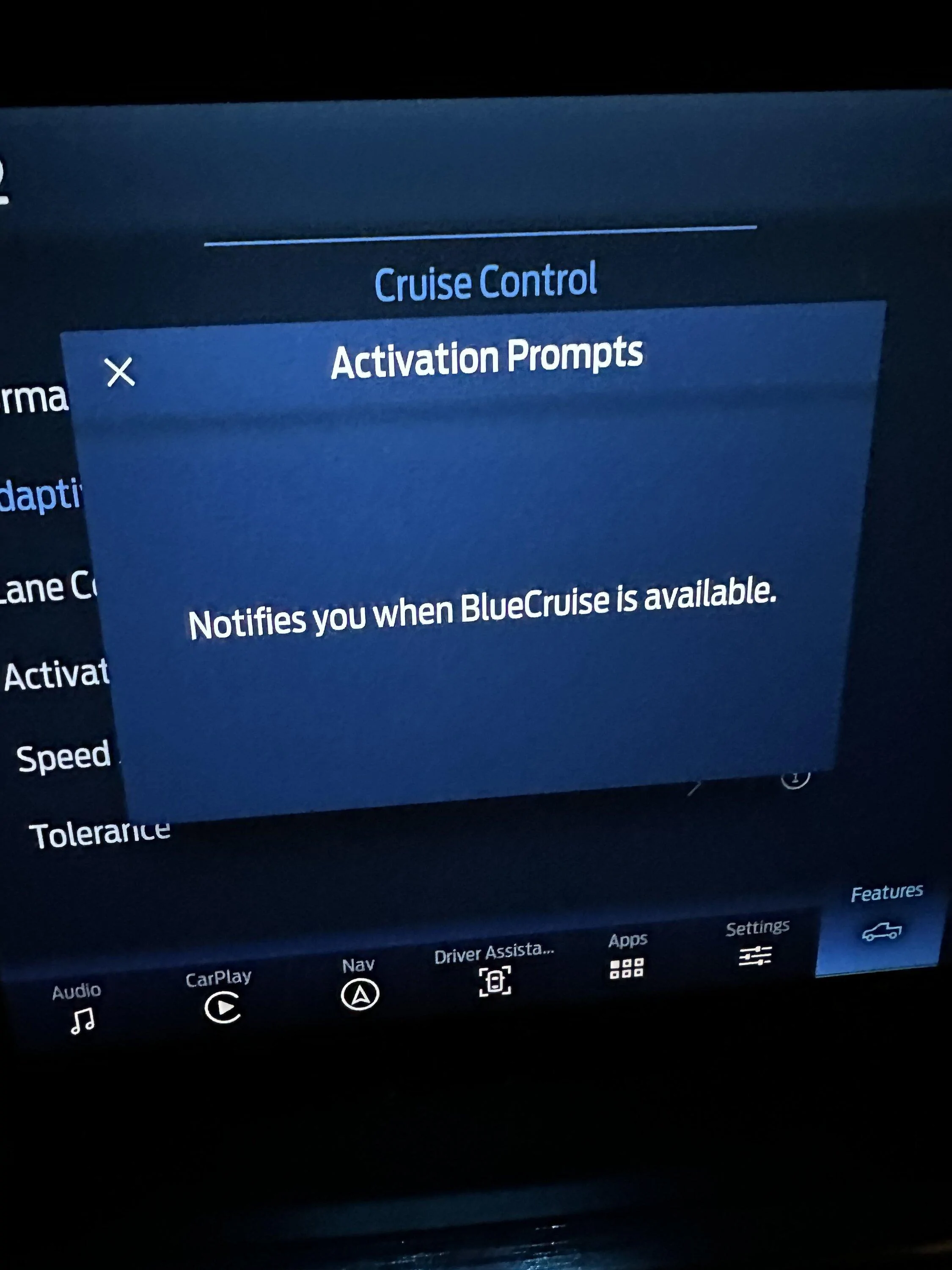

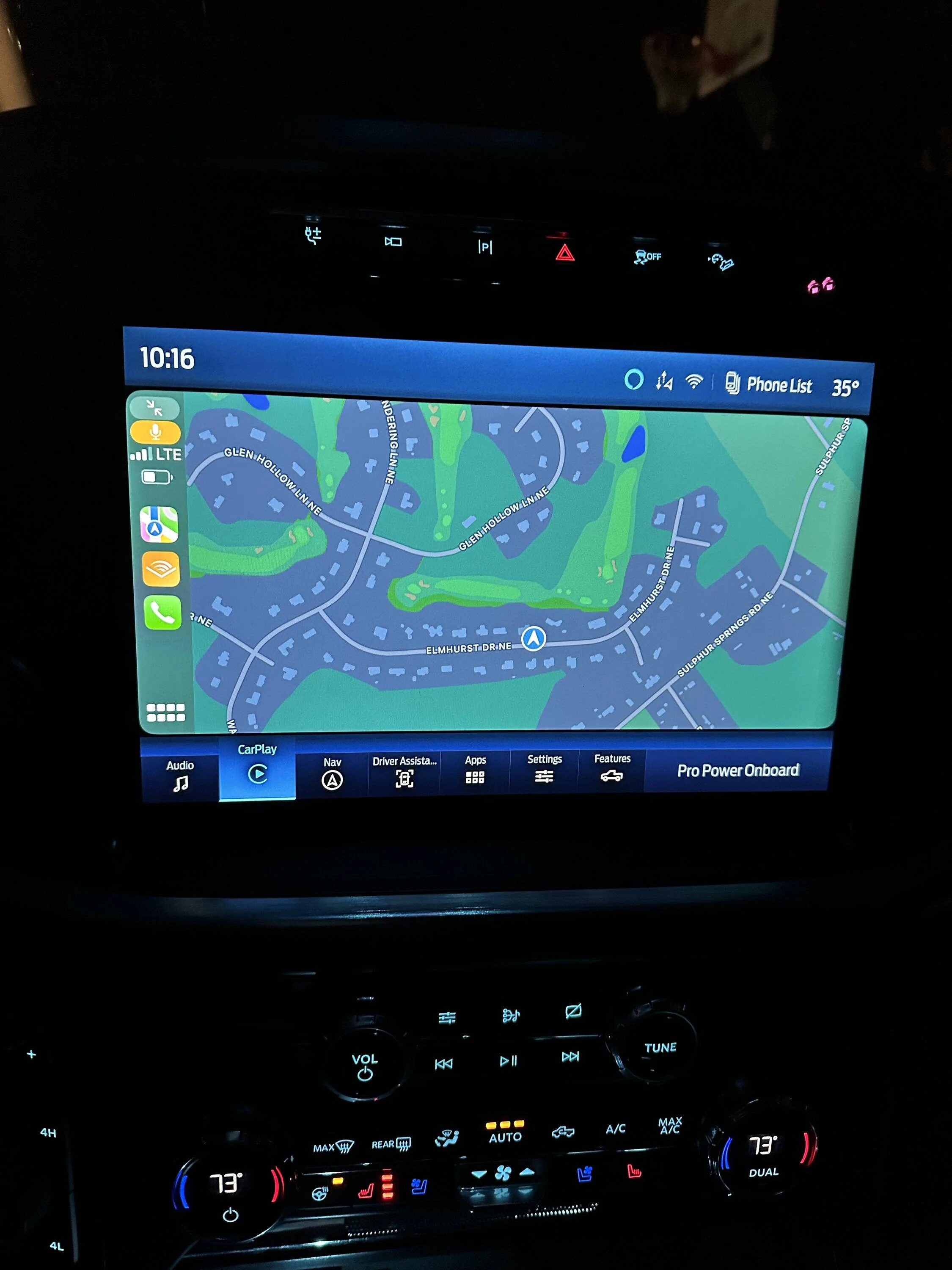

FInally done!! 12 hours of total time and a toasted charger. Luckily my neighbor had a spare. I have everything now!! Blue Cruise, bed camera, full screen car play, etc. Why couldn’t the dealerships figure this out? It blows my mind. It wasn’t extremely difficult, but it was indeed time consuming and tedious.
