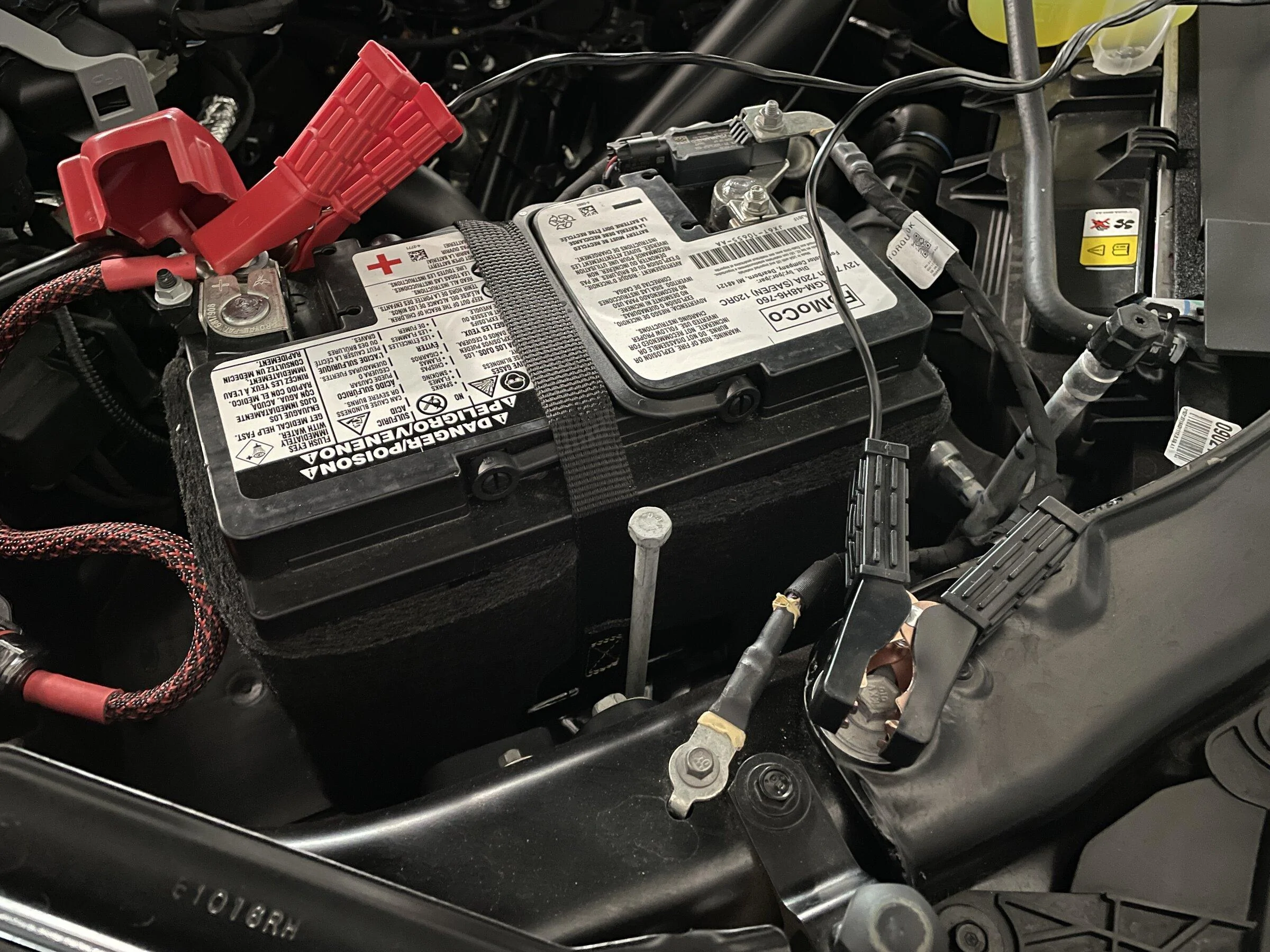

THanks, can you tell me the exact settings you used to charge the night before you went to the power supply mode during the updates.
Connection to the battery matters also. Do not connect to negative directly, it messes with the BMS. This is how I connect mine.
Mine was at 95 when I first connected (12V charge mode, likely 10A, but it doesn't matter). Immediately switched over to PS mode. Zero issues during programming.
If you do this yourself: There will be times when FDRS has you cycle the ignition. If you have NOT used FORScan to update your truck to NOT default to auto-headlamps ON, be sure to turn them off (while programming) any time you see them on. The lower right corner of the FDRS screen will tell you current battery voltage. When it goes from 13.2V to 12.4, turn your lights off. I forgot about that when it happened and was scratching my head for a minute. LOL.

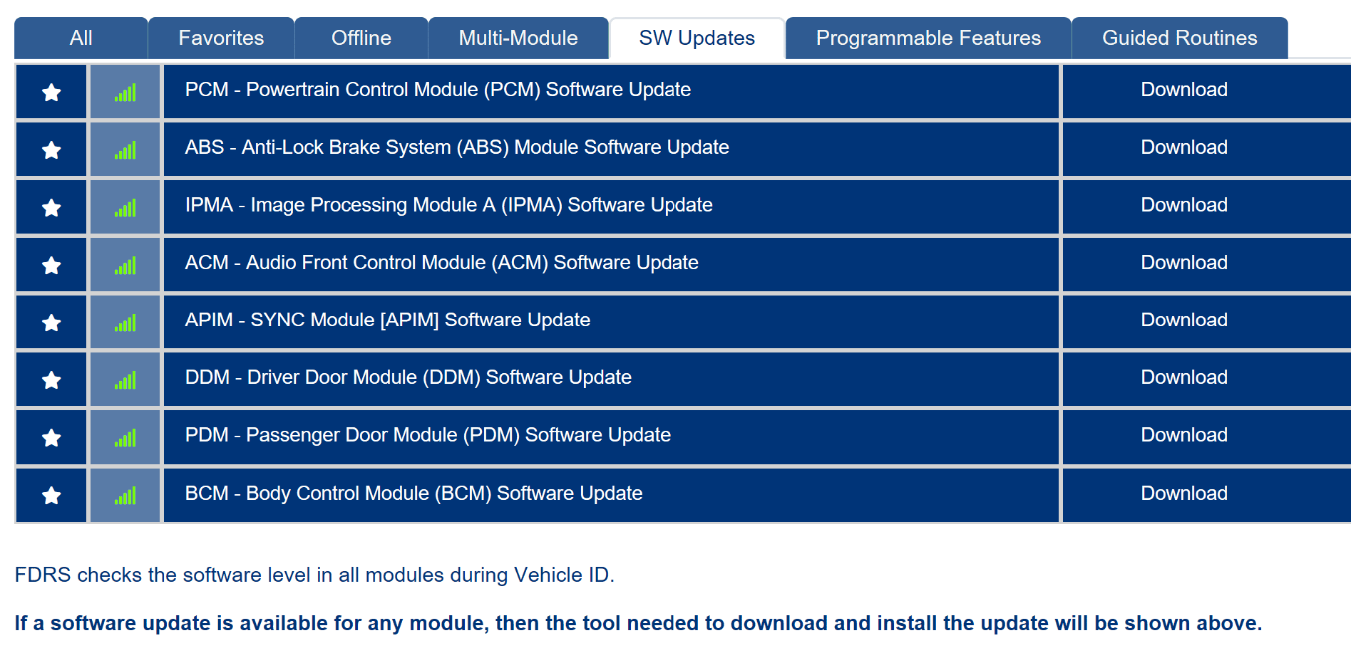

How do you know which one of these you need.?
