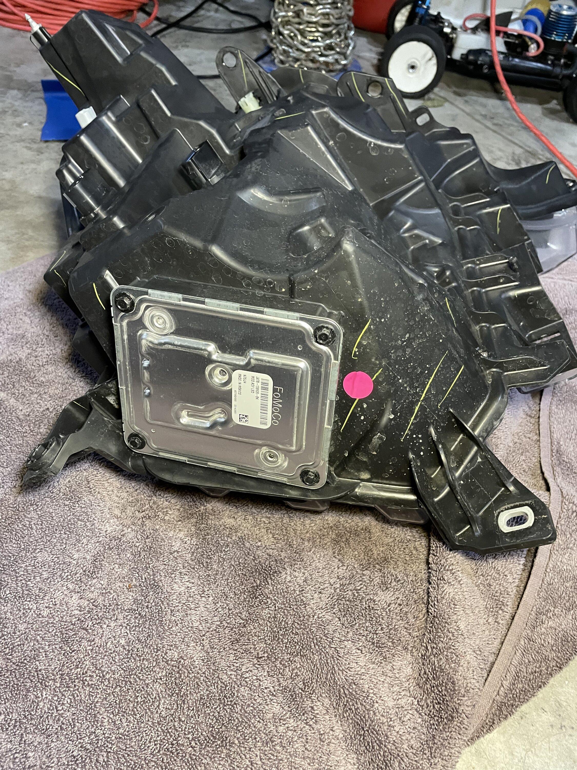

I am back in business!!! BCM headache is now behind me. New LED Module / processor installed! Everything is working again after the BCM LIN initialization in FDRS.
Now I can relax this Christmas weekend… Until cousin Eddie kidnaps my boss! ?
Note part number on the part itself is different than what you order.
New LED Module / processor installed! Everything is working again after the LIN initialization in FDRS.
Great to hear! Just to confirm, you rolled back the update, correct?

Yes I did. But still had to install the module. Even after the roll back it didn’t fix the problem.

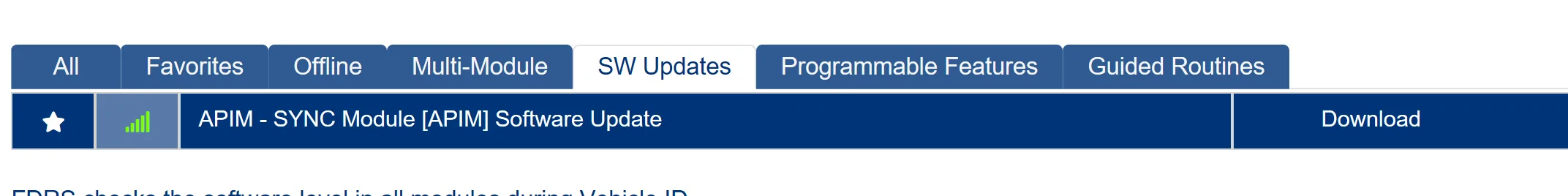

Here is a random question, but I think in the right arena. I have a 2021 Job 1 F150 Powerboost Platinum and have a Mongoose and everything is great. Just bought the wife a 2022 Lincoln Navi L Black Label. I am guessing it has FRDS updates pending. I run FDRS a month at a time but it just expired. Would anybody mind checking 5LMJJ3TT0NEL16574, build date is 11/22. TIA!!
Only thing I see is an APIM update at the moment.
