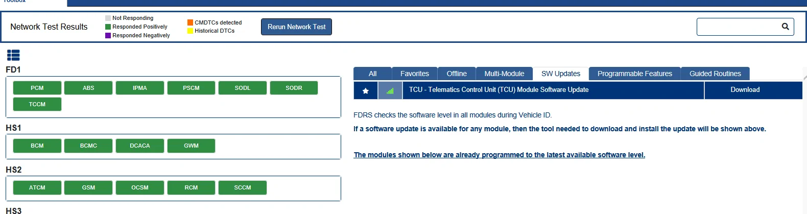

Third part of Alexa? I thought people were getting Alexa with the previous module updates that were up in FDRS. Is this to give Alexa more features perhaps?
I wonder if that means that 3.5.3 is also a partial update and this TCU update would come in as 3.5.4 or something along those lines.
I’m using Ford terminology, not functional description. When Ford first notified dealers and customers via an SSM that Alexa was on the way, it said that the rollout would be coming in three parts: first a GWM update, then an APIM update and finally a TCU update to complete the deployment. Neither the GWM nor the TCU likely adds “Alexa“ functionality as we understand it but Ford considered all three pieces to be part of a single unified deployment.

Yes. This TCU update is the same as what 2022 runs.. SO the 21 and 22 are now truly unified

@Jesse-Infotainment Did yall get securialert back running? I just got home after being gone all week and got Alexa setup and noticed that my securialert is still working just fine.

Well shit, I was fully expecting my Securialert to be gone after all the master resets I did. Anything I can provide from my truck to see why yours isn't back?
Im looking at your truck now.

Nope mine has been dead. Jesse is aware of my situation too.
I was hoping that the new TCU update would fix it. You’re the only one so far to have applied it.
Is the Securalert only a 2021 issue?
