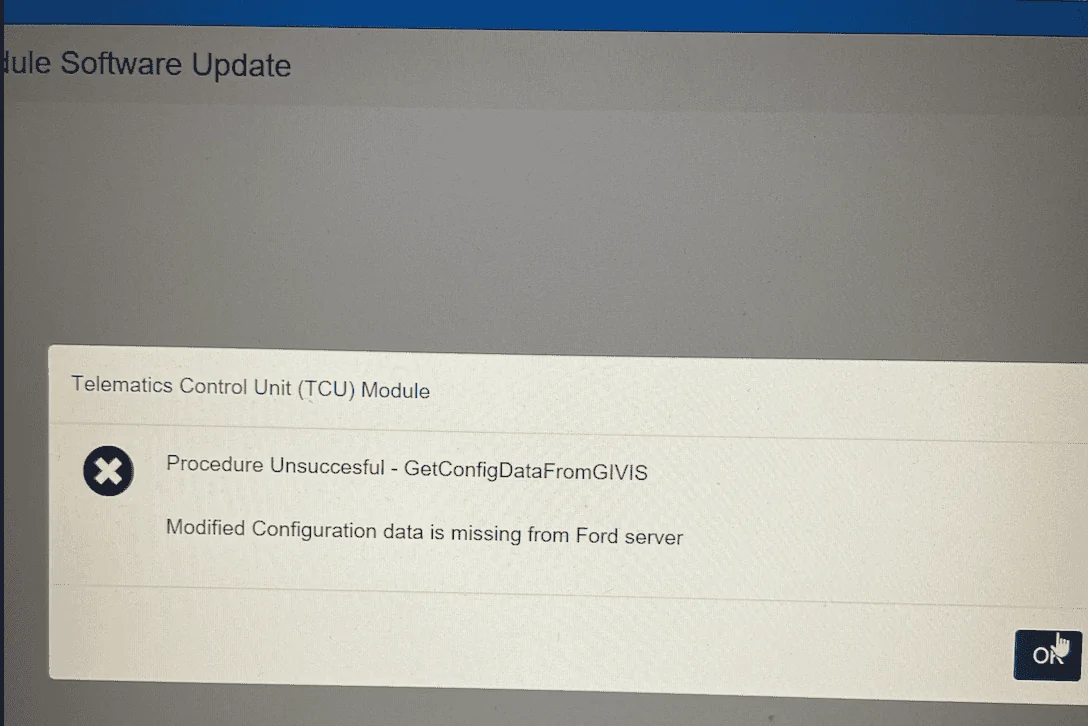

any idea why I'm getting this error?
Ford F-150 ECU module programming guide using FDRS Screen Shot 2022-10-13 at 8.16.36 PM

It’s a server issue on Ford’s end. This happens occasionally. See Post #1354. Try later.
Same error for me still this morning. Hope they get it figured out before my 2 day license expires
That's weird, I was able to update my TCU with no problem about 30 minutes ago
