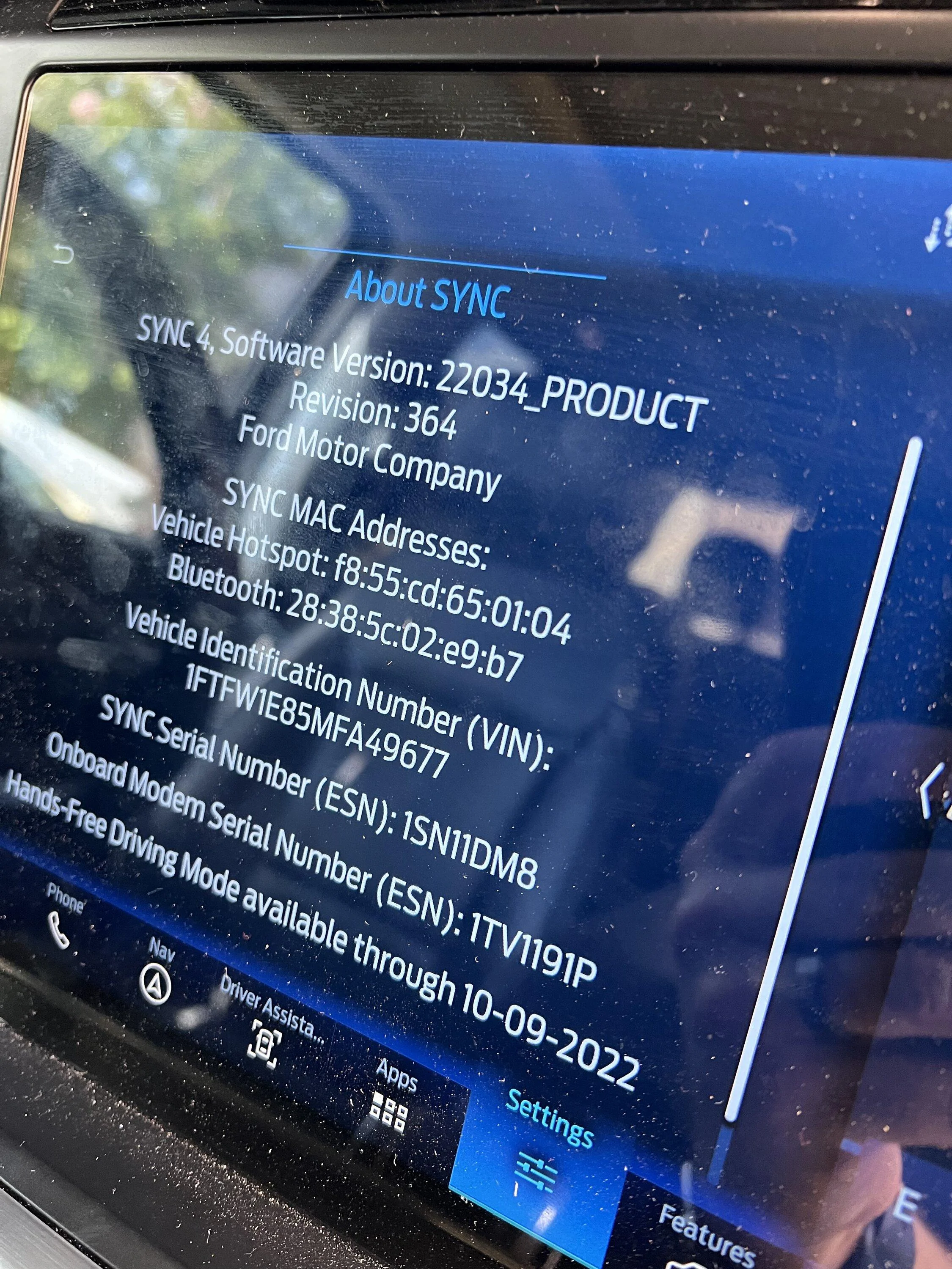

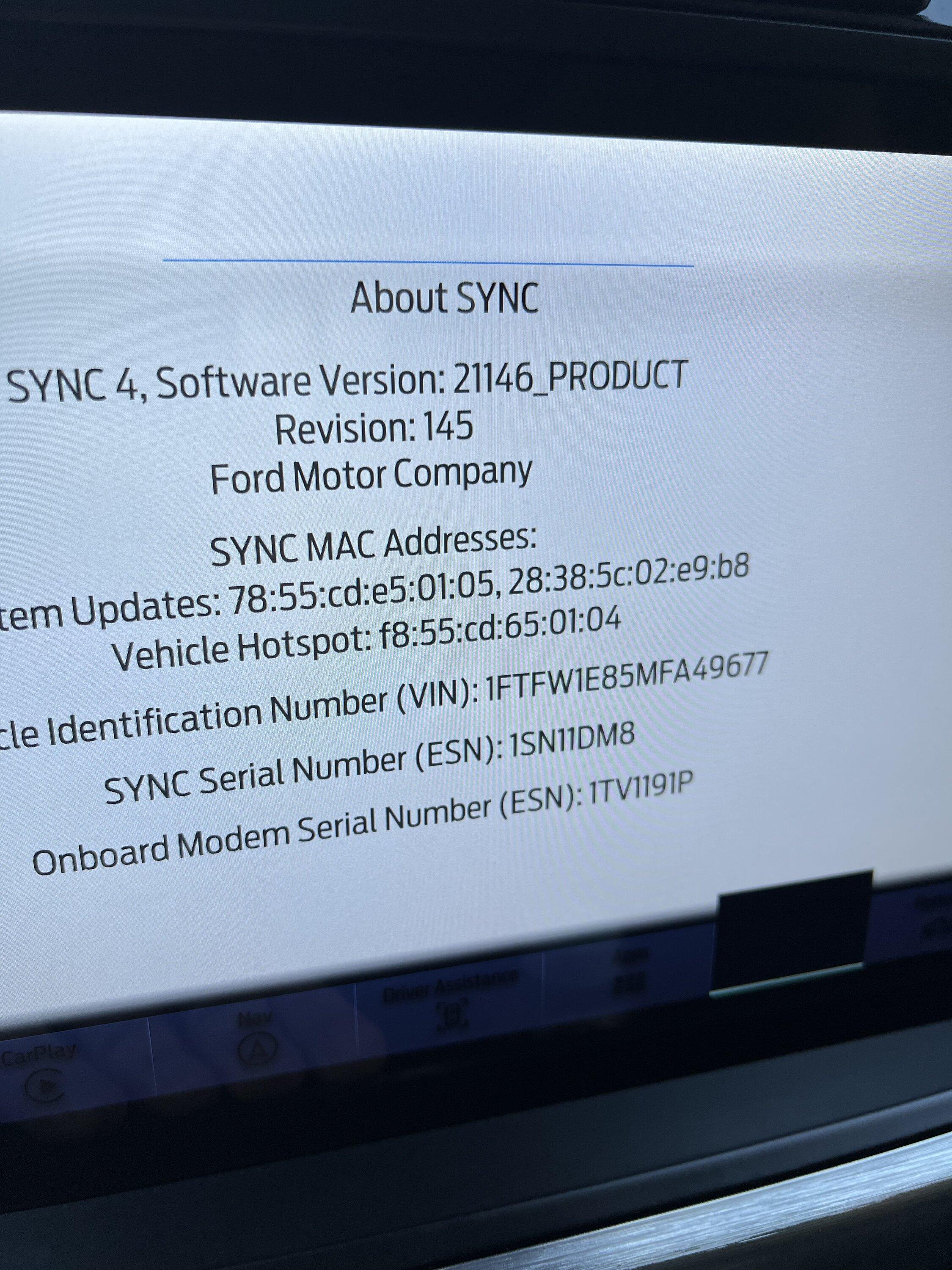

Well this should be fun to fix. Had been sitting at 22034 Rev 364 for quite a while. I got an OTA update while I was getting gas today that totally hosed the infotainment look up and Sync is saying I’m now on 21146 Rev 145. So I went WAY back and I don’t know what happened. Looks like I got some FDRS work ahead of me.
That is so strange.
Have we ever see an OTA update that took a module backwards?
How is that even possible?
It would only be possible if there was no versioning check code in the update procedure. That would be amazingly sloppy software behavior.
Of course if it is intentional, that's a very different scenario.
I have seen it possibly to downgrade. I just would have thought the OTA wouldn’t have been deployed knowing you’re at the version you are. Since fdrs had known the update was gone you would think the OTA deployment would know too. Makes me want to entirely doable the OTA capabilities in my truck

Here’s some pics for proof. Blue Cruise still works but my whole infotainment is jacked. There’s no audio to choose from and everything looks blurry. @Jesse-Infotainment are you able to see anything that stands out?
s
I’ll look as soon as I get home and see. It’s nuts because I’m concerned your as built reverted also.
